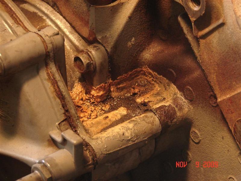

It appears that the water pump/timing cover area on small blocks have seeped coolant from the upper studs & bolts across several manufacturing years.
Personally, I think this was either a tool fault or setting/spec error on the assembly line.
Usually described here on FTE by many folks as "truck looses coolant, stinks of coolant, no puddles under truck".
It fills in the area & cooks off the water leaving this area filled with gunk.
This is mine:
But this does not provide a direct path for coolant to make it into the oil.
I have a particular way that I seal this which works for me.

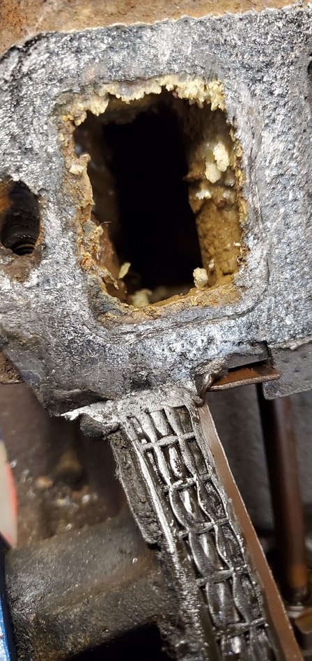

Find the intake bolt:
