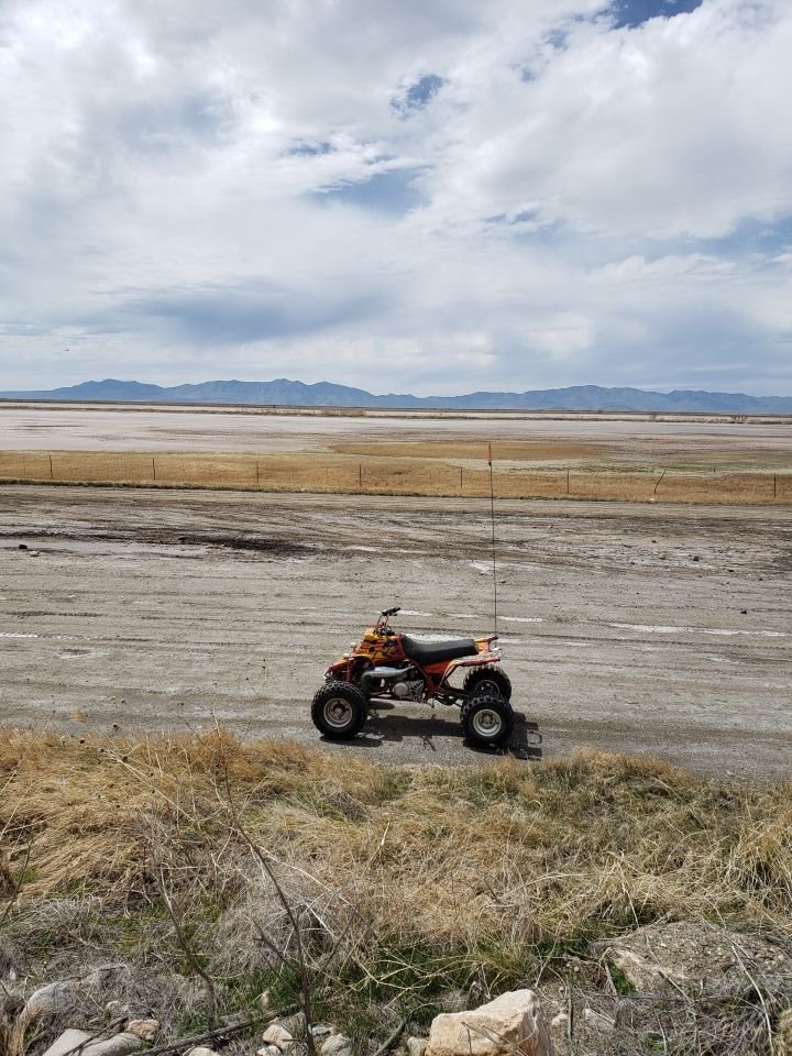

I have a hotrod Yamaha Banshee
An 89 that had the frame replaced and a ton of other mods to make it fast
Bought it cheap blown up and was looking for the serial number
Found the spot where it was supposed to be all ground and sanded down
About lost it and freaked out, contacted the guy, friend of a friend
He said no doubt, the frame had been replaced, there was no number and it was the Layton city cops that did all that sanding, while checking it for being for a stolen bike or something
Apparently, the new frames you buy from Yamaha have no serial number
I did get it registered and that was years ago
They told me to stamp it if I wanted
Grandson bashed it into some rocks and broke the throttle cables so I haven't road it since last summer
Near the shore of the Great Salt Lake at Willard Bay
