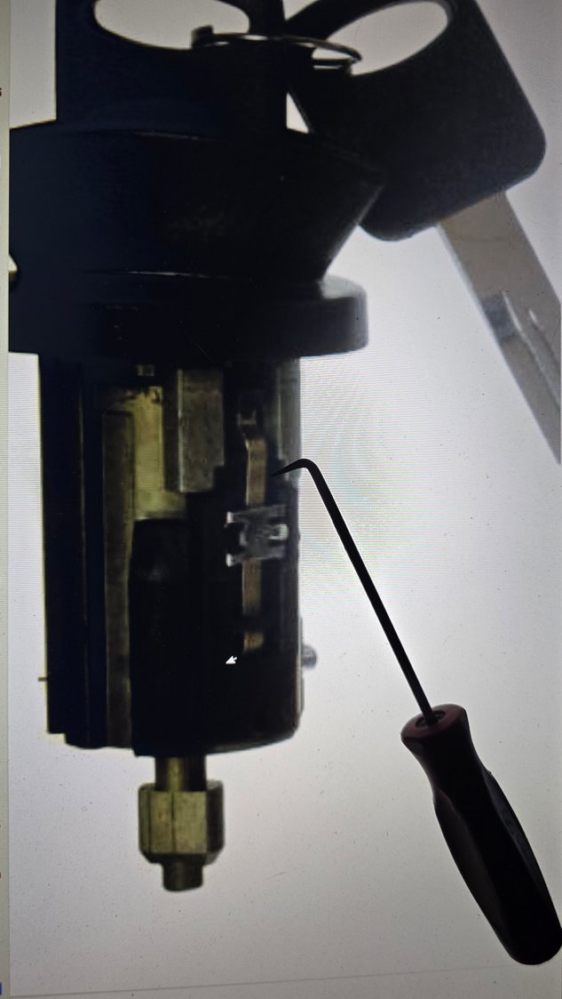

This is the spring loaded tab that turns on the key in ignition warning
You can pull the ignition lock cylinder back out and try to reassemble it back on there correctly
That plastic holder breaks its tabs sometimes and the thing gets loose on there
Might have to replace the key and cylinder to fix it or disconnect the wire
It grounds the tab when the key is inserted
Disconnect that wire and you lose the warning
