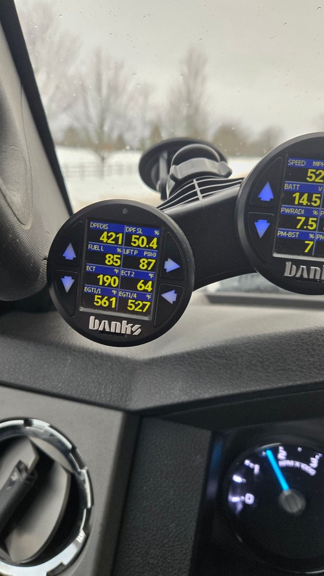

My Banks iDash usually shows a temp from 90s to just over 100 degrees, IIRC, for the secondary cooling system temps. So maybe a bad secondary temp sensor?

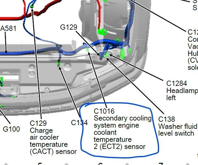

On a 2020 it's located here:

This was from the other day... cannot remember exact temps but under 40 degrees.
Primary at 190 secondary at 64...

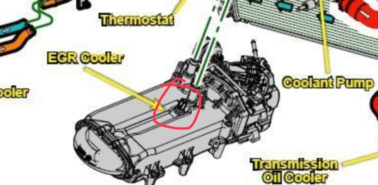

Hello. I just came from the Ford dealer and the only coolant temp sensor they can find other than the one on the engine for primary coolant is on the oil filter housing. That doesn’t make sense to me. I just got home and took off my grill and air box and followed every coolant like from the tank to the pump to the radiator to the the water pump to the intercooler to a fuel cooler to an oil cooler. Sorry my order of them is off. I see the high temp and low temp thermostats but no temp sensor anywhere in line in a hose or any other type. Wondering if 2013 didn’t have one?? I found an oem harness with a 2 wire plug with an OEM plug/cap in the area where I have read the temp sensor is in the newer trucks. Not sure what else it would be for?
Old Dec 23, 2024 | 03:27 PM
Euroman's Avatar
Euroman
Joined: Nov 2014
Posts: 1,776
Likes: 1,584
From: France
Deleted
Old Dec 23, 2024 | 07:50 PM
Trash Hauler's Avatar
Trash Hauler
Joined: Feb 2014
Posts: 166
Likes: 22
Secondary coolant (ECT2) sensor on the 2013 is located on the EGR cooler. See pic below.
If your truck went on a diet, then you will not have an ECT2 sensor, the plug will be capped/taped under the hood and any temp you see on EZ-Lynk is made up by the tune and should be ignored.
Bob
ECT2 sensor circled in red

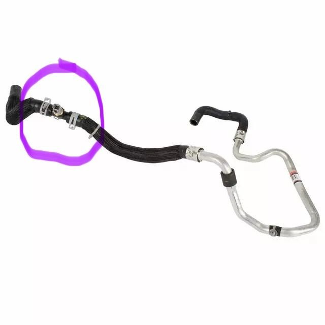

Yes this is also what I have found. I did also find that in 2015 they moved the sensor to inline of a hose coming up to the degas bottle. It’s a T fitting with the temp sensor in it. I’m wondering if I can have my ez-link setup to where the tuning company can set up that input and I can install the oem sensor in the hose like the 2015 has. I would really like to be able to monitor the secondary coolant temp.
