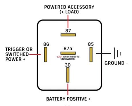

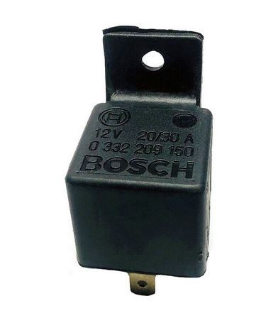

Here is how to wire it:
Originally Posted by FORDF250HDXLT
Yup, the best lift pump for the IDI is a Chevy big block 396/454 lift pump block off plate, a 30a relay and a Facet 40222N electric pump.
Relay wiring is easy.
1.pin 85 - ground.
2.pin 86 - jumper off FSS line, on top of IP.
3.pin 87 - red/positive wire of pump. (negative wire of pump goes directly to ground.Combine into pin 85 if you want.)
4.pin 30 - wire from constant 12v source (right off + battery is ok) w/ an inline fuse holder (5 amp fuse).
Issue free for years. No more junk lift pumps. No more worry about ruptures filling base full of fuel. No more cranking of engine to prime fuel, from tank to pump. This is how these trucks should have left the factory.
Both items easily found online or any auto parts store.
