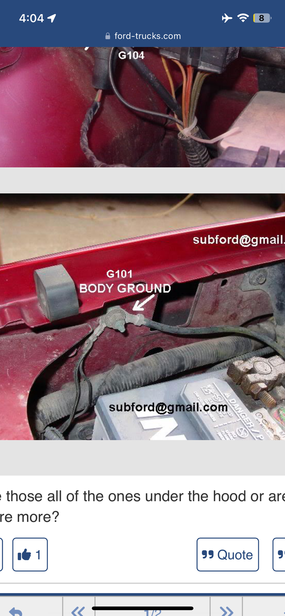

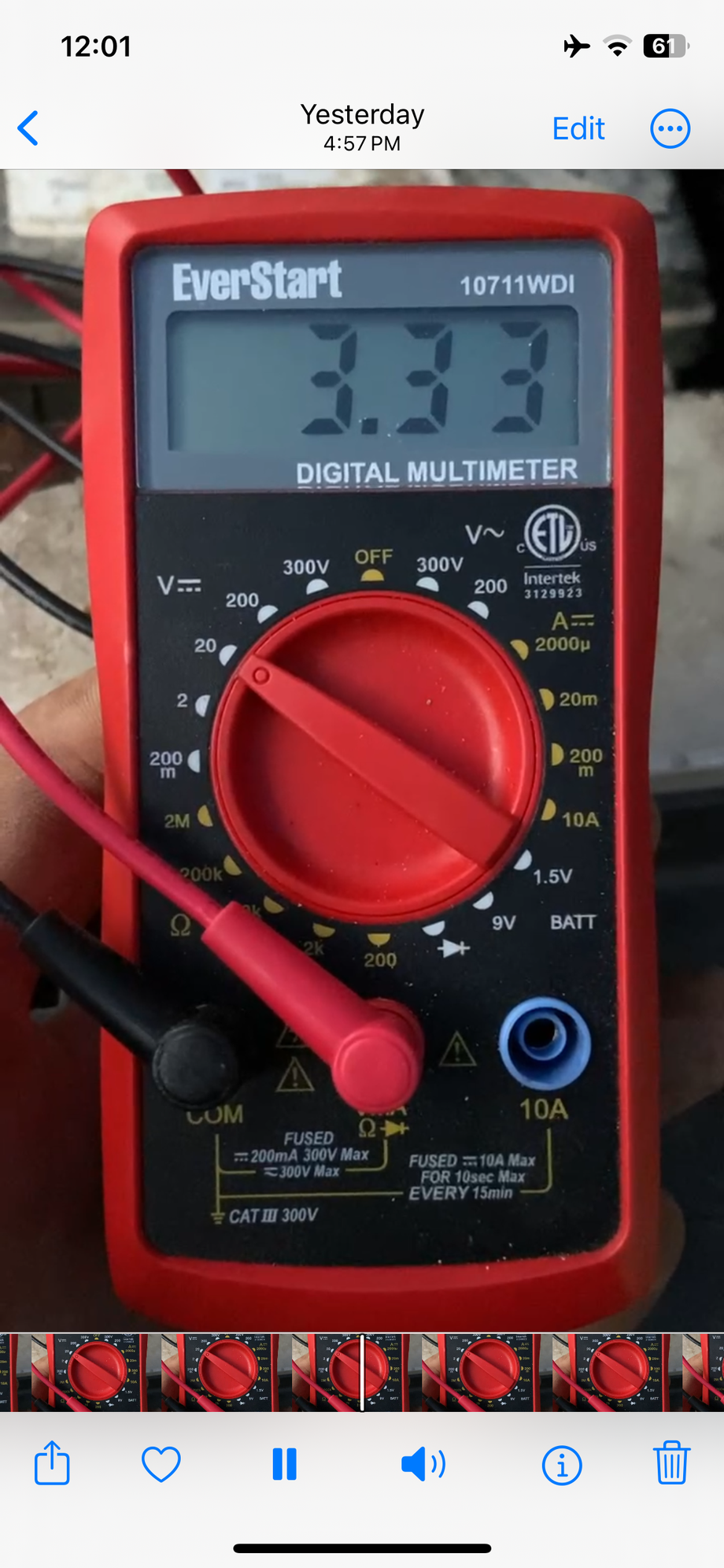

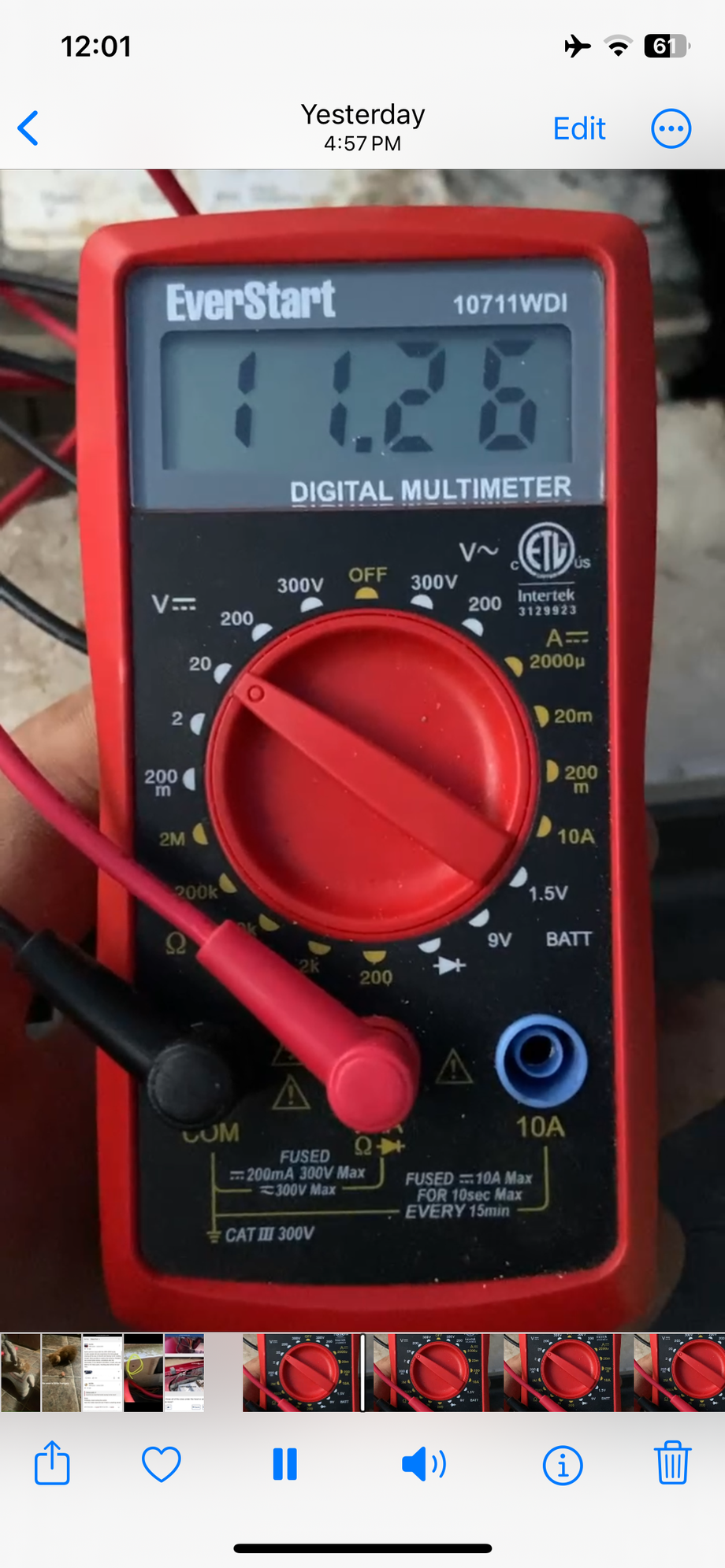

Thinking my main ground from negative terminal has done its time. I will replace and follow up. Prior to any of these issues when the truck was still running and driving fine I started experiencing some sort of temporary no start heat soak issue that I’ve ruled out being the starter. Thinking it’s the same issue just exacerbated. Also, the ground in the picture below has been rerouted by a previous owner, and is sharing a bolt with another ground. Wondering if this could be an issue as well? I’ve attached 3 images of the voltage issue from the video above as well.
Voltage just prior to cranking
Voltage drop on crank
Voltage immediately climbs after releasing the key

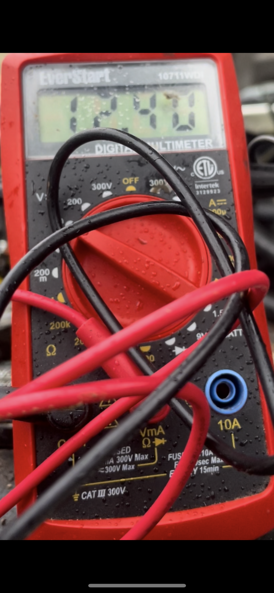

Okay the 2 batteries in question are pictured below. The one being used in the video is the one that read 12.40, but it’s the same with either. I get 8-10 seconds of normal cranking then this. Basically the 2 videos are near chronological. Will not crank normal again until several minutes later. I think at this point I’ve ruled the battery out, leaning towards failing ground cable.
