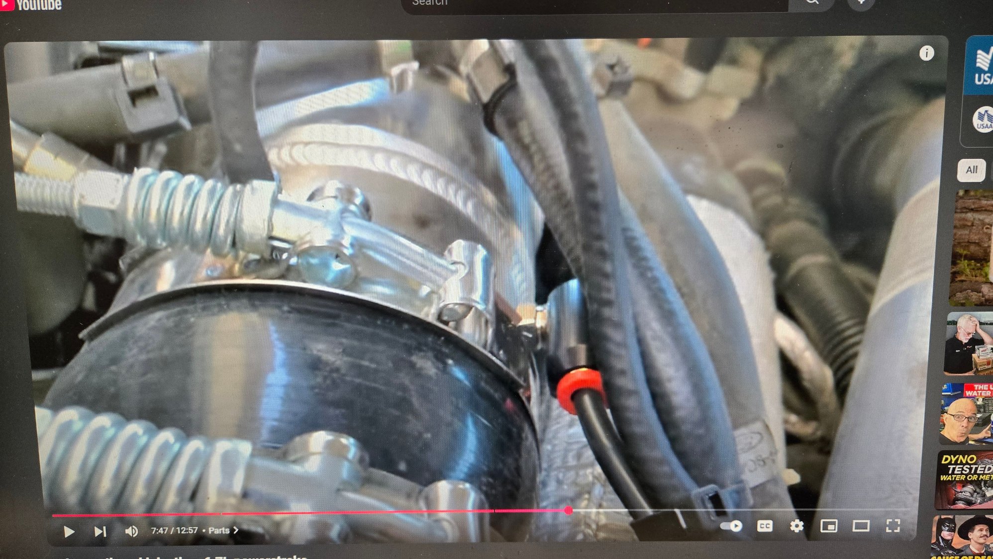

Pics from a methanol injection install on a 2015 6.7... locations of nozzles and boost reference on a aftermarket cold CAC pipe... from a video on YouTube.
Boost reference on top and MPG nozzle on side towards front that comes on at 9lbs of boost.
Back side view of the power nozzle that comes on at 22 lbs boost...
Started watching it and taking notes. He pieced together the MPG Max kit from Snow Performance.
Mounted a 10 gallon tank in the bed. The Max kit comes with a 7 gallon tank.
This gets my brainstorm juices flowing...
The controller he uses comes with the Stage 3 kits from Snow Performance.
