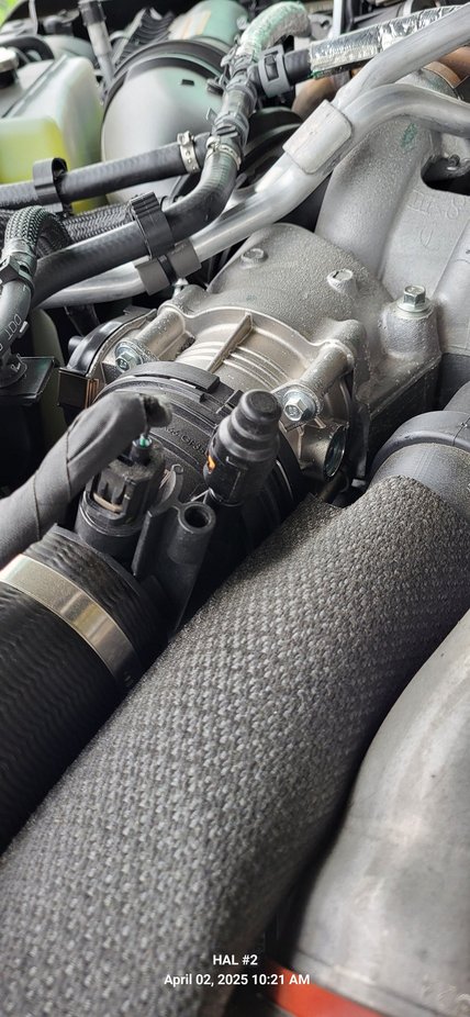

Fritz noted a few years back the 6.7 ho
Has a port built in
This pic is my engine
It's begging for it
its makes me question, if ford is looking aheaf emmisions wise ....for methanol injection

That could be the port for the new CCV boxes with the line I'm thinking... ??
that might not be good...it's on the pressure side ..
Fritz has had his for some time.iirc .maybe he can chime in on how it's holding up, hints and tips✍️👍

The instructions for the Snow Performance diesel kit Stage 2 kit show the cold CAC, in the plastic piece of the OEM pipe for methanol injector(s) placement for the 6.7s.
From this article here:
6. Nozzles are usually mounted in the intake post-turbo, and can even be disguised fairly well. Most hot street performance systems use two large nozzles, such as these two 625 ml/min units from Snow Performance.

yep snow has it in the hose or black part of the 6.7, that pic has to be aftermarket pressure side in front of throttle body
page 8
i was reading the other guys system and it was pretty pointed on the spray going in after the intercooler , page 19
i reason as to not let the atomized spray fall out and into drops in the cac?
that pic is hard for me to break out as it could be a metal cold side pipe in lieu of the hose thing we have now stock
https://www.aemelectronics.com/produ.../parts/30-3301
page 8
>>>the spray going in after the intercooler , page 19<<<
lots to digest
this system is an investment in time and some dollars
but it looks to be well thought out in the directions
Yep, the AEM shows the injector placement AFTER the CAC, which is exactly the same as the Snow Performance kit, which would in the cold CAC pipe in our trucks.
Lots to digest is right... I forget what Fritz did to resolve his issue... maybe a Pusher cold pipe to replace the SPE pipe that allowed the injectors to spray on the IAT sensor causing his problems??
