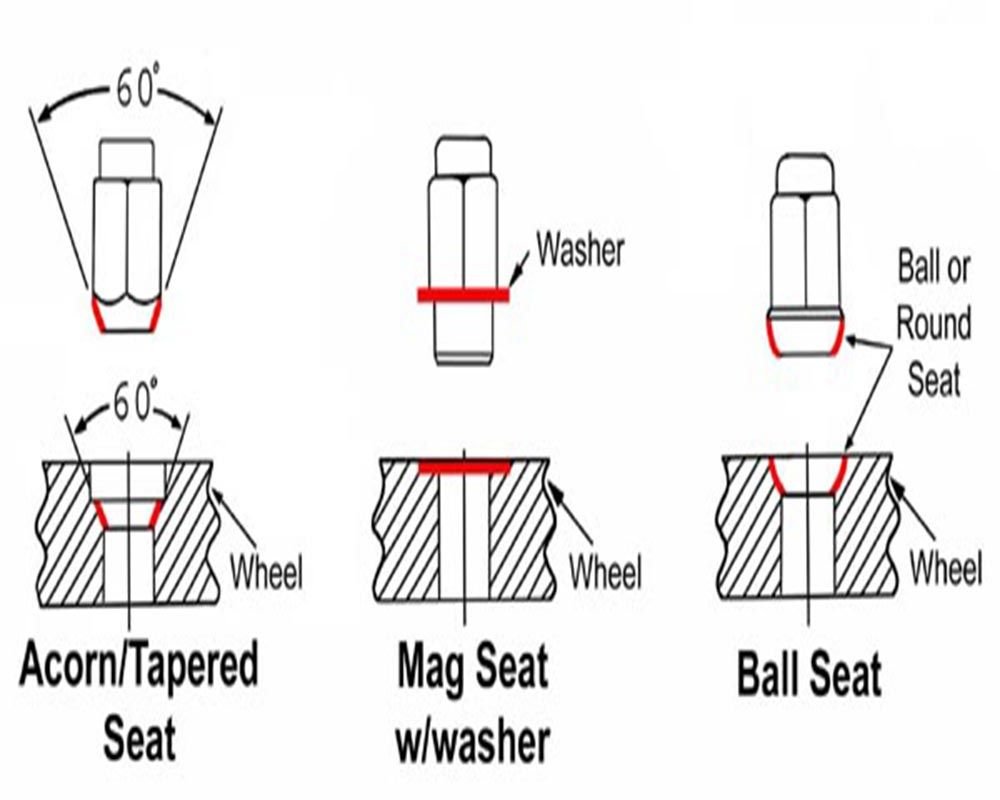

Are the aluminum wheels a conical seat? Or do they take a shanked lug nut?
they are conical seat

Here I had this info on hand, but please follow up with your own home work and let us know how you get along. I believe the normal way is to use a commonly referred to as a "shanked lug nut". Also called a Mag Seat w/washer style. Meaning a lug nut that goes inside the aluminum thick faced rim. Like when you run Slotted Mags, Hurricanes/Fins and or Aluminum Spokes. You use the same lug stud that is installed.

The Gorilla #75187 lug nuts are the correct fit for your aluminum slotted mags.
They have the correct 1.000" shank length and .740" shank diameter to properly fit your wheel.
Be certain to buy the correct part number, Gorilla also makes the same lug nut in a .750" shank length and .685" shank diameter #73187, while these will "work" the wheel will not be properly centered.
Are you sure as I dont think I have ever seen an alum wheel that did not use a shanked nut with a washer.
Are the wheels after market and if so who makes them and if not what did they come off of?
