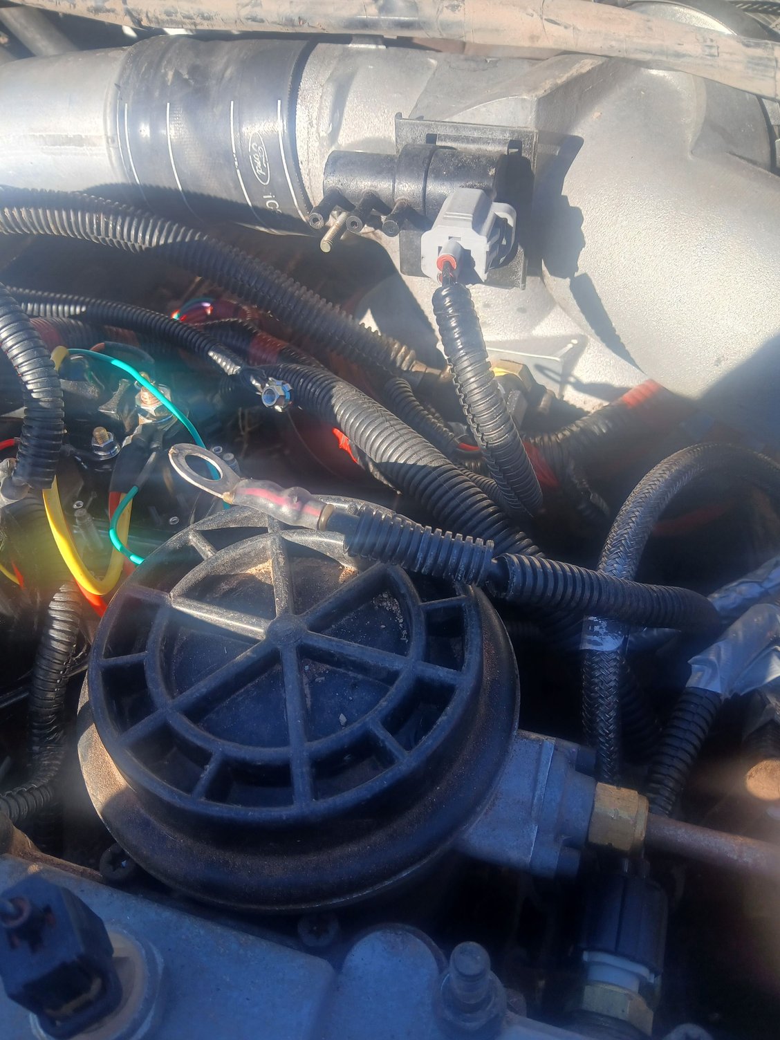

Which ground is this next to the turbo about 7 ish inched long

Unless you live in California or Alaska it can be removed. Only activates after the glow plugs have cycled off, and the parking brake light is on. Supposed to help with any white smoke during cold weather idling. But usually by the time the glow plugs are off there's no visible fuel vapors anyways

It goes here. But it appears the insulator is gone and there should also be a big red wire with a captured nut too.

I have them there just taken off will that cause for Jo power in the cab because I'm getting none at all I re did the harness a few days back both of then actually but now I'm getting now power all fuses are good and both batteries are charged

That ground is ONLY for the intake heater.
There is a ground strap bolted on the back of the right (passenger side) cylinder head that connects to the firewall behind the MAP (Manifold Absolute Pressure) sensor above the HVAC case.
