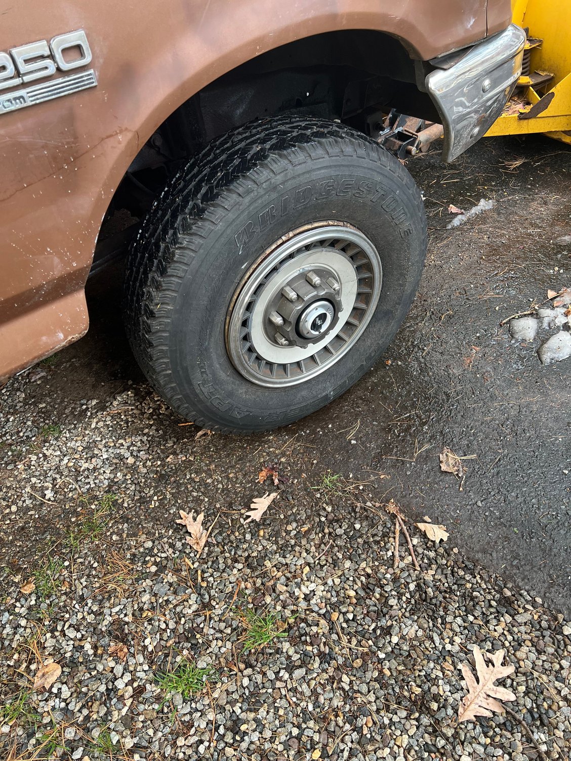

I noticed when plowing my long driveway that I wasn't going into 4 wheel drive low. Im glad this past snow fall was mild otherwise I couldn't plow without 4 wheels
When I locked both manual wheel hubs the LEFT front wheel clicked in and assumed it worked BUT the RIGHT front lock hub it does NOT click in but you can turn the switch all the way around. So I'm assuming that Front Right hub is bad.
I jacked up the just the right front only and the wheel just spin and not lock. Jacked the LEFT front wheel and still spins free when i lock it.
However I DID NOT jack up the whole front end due to the plow attached.
I need some food for thought to figure out how to get back into 4 wheel drive. I didn't have this 3 years ago when I last plowed.

That's one of them jobs, where pulling the hub off and taking a look, the problem will probably be revealed to you. An Allen wrench and 5 mins will probably be all it takes.
Tip; if they've been on there for 20 years, if any of the bolts don't turn out; just drill the heads off, take off the hub, and then you can turn them right out with vise grips and replace them latter. So long as you have 2-3 in there, that's enough for a yard truck anyway though......but they don't cost much, right at the hardware store; take a good one with you to match it up.

to tell if the hub is actually locking, lift that wheel. lock the hub. reach behind and grab the axle. if it spins, the hub is locked. if the axle does not spin, the hub is bad.

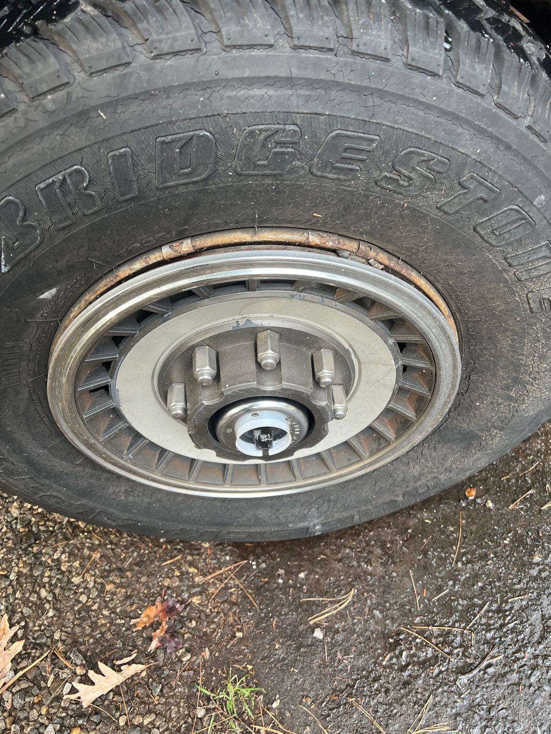

Update:
Thanks Tom.
Found that the right side hub was not locking.
I thought so because you could turn the switch that goes to Lock or Free completely around.
I took off the warn hub cover and sure enough the round plastic part inside where it screws to the handle is cracked. When you switch it didn’t seat and hold the to move the spring.
i found and bought a brand new Warn 9790 on eBay for $40 to the door! This what I’m using now.
Easy fix now!
My current hub is fine and I’ll just replace the cover when it comes in & keep the new hub for backup.
I'm currently bonding the crack and let dry overnight to see if it holds and locks the hub. You’ll never know but I have a new cap coming in..

Glad that you found your solution. But to close the loop on this, no, the good wheel won't lock up if the other hub is broken.
With the left wheel (with the good hub) in the air and the transfer case in 4WD, if you turn the left tire it will turn the left axle forward. The transfer case will keep the driveshaft from turning, but the open differential will let the right axle turn backward. Since the right hub was broken the right axle was free to turn, so the left tire was free to turn too.
That's why Tom suggested reaching behind to see if the left axle was turning.

Another update:
I bought a new hub that I just need the Hub cover.
However, I created a clever workaround to get my Hub to lock.
My current hub Free/ Lock plastic switch had a crack. Epoxy did not fix the crack. It just expended the crack while turning the switch.
Im a fabricator but no way for me to make a temp switch fix
What I did was take the cover off a plumbers Teflon tape roll/ cut it once.
i inserted into the hub where the switch goes! Fits perfectly!
Now the switch has no play for the crack to expand and turns the switch to Locl or Free!
works like new!
I got my 4 wheel drive back.
