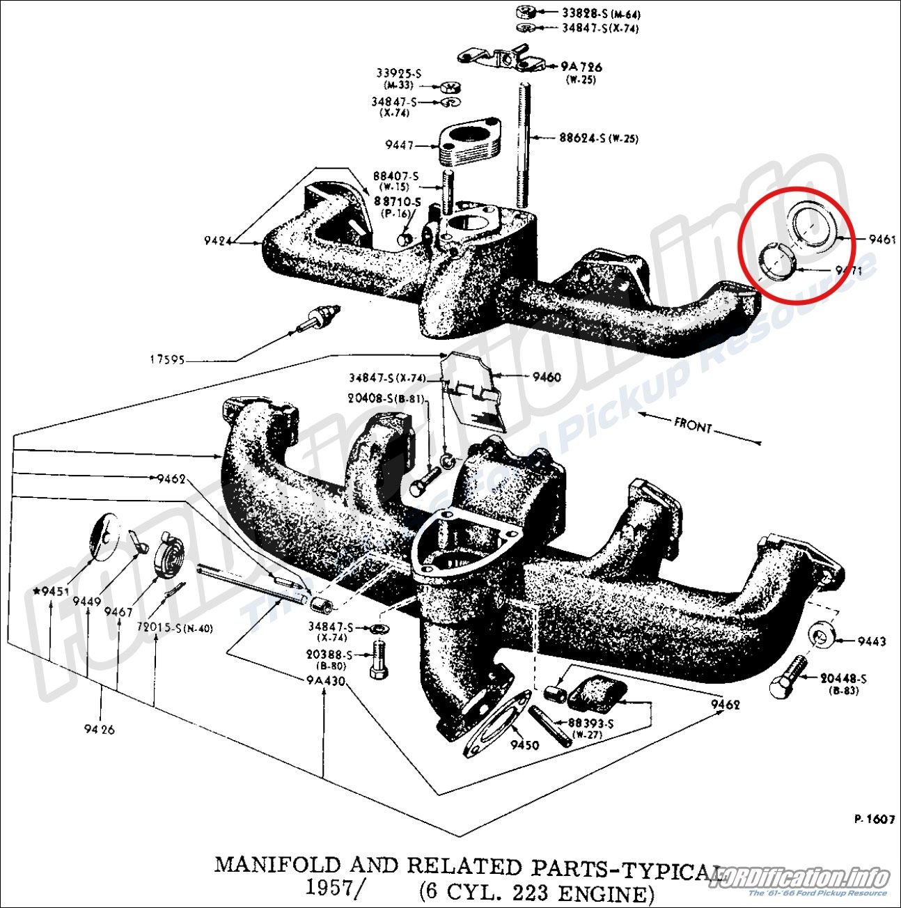

While pondering this issue I rembered there were some of the metal rings missing on the intake, see below. I ordered them and installed them. Maybe one or more of these are cockeyed.
Mine is a 60 but I couldn't quickly find a 60's diagram.

Sometimes the sealing alignment rings are not seated right which causes vacuum leaks.

I took it back apart and one of the rings had fallen out and is missing Also the base of the carb was slightly loose. Waiting for a new ring for final results.

Put the missing ring in the intake, found out the manifold gasket set wasn't right and had to use high temp gasket maker between the intake & exhaust manifolds. Then found the carb base was a little loose and tightened it. After that it fired. It was getting late when I finally got it to pop off so I need to see if I can get it to run better today. I've got new electronic ignition, wires, cap & rotor but I can't seem to find the new plugs (I think I bought).
