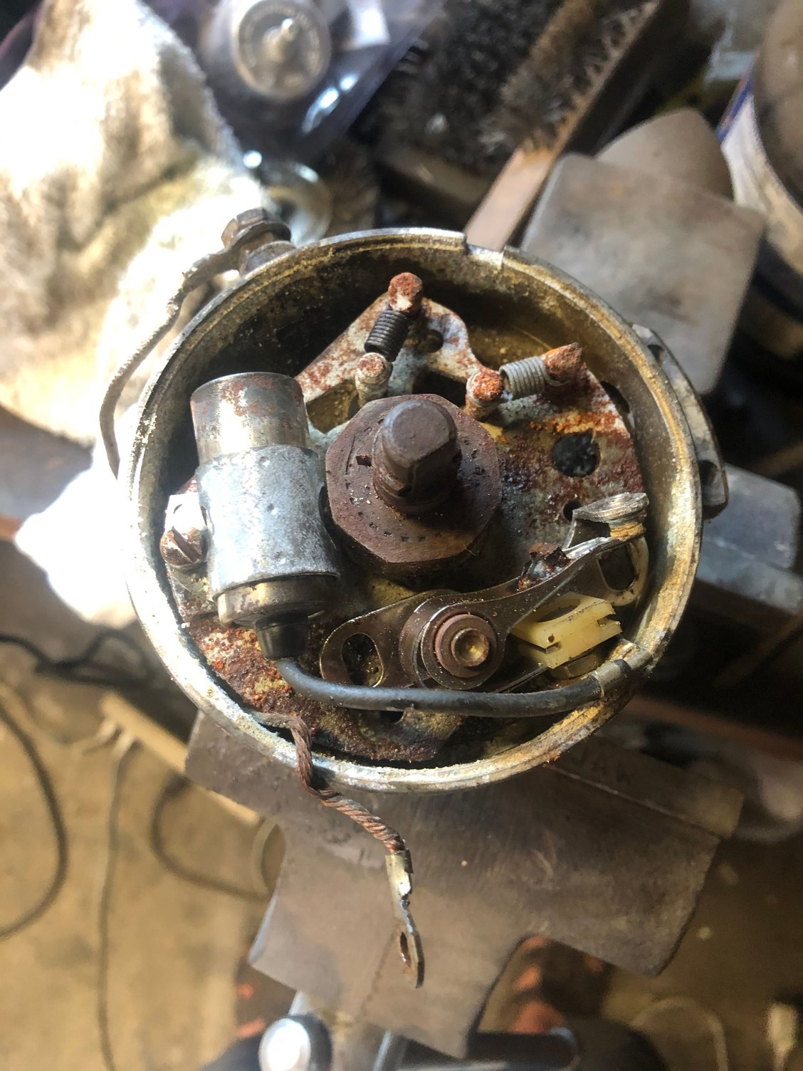

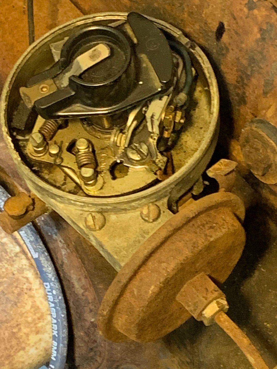

I think you have to use a different selection method for some applications. Using the distributor number with a cross reference is what I had to do to find the correct pertronix for a 272 distributor with load-o-matic. I found the numbers on the outside of the distributor bowl and did a manual lookup that way. There are lots of 6cyl so it would be surprising if not covered by one of their products.
Get the numbers off the distributor body
Old points & guts
Ready for install! This was for a 272 Y block example.
Consider Posting a good picture of your distributor number on here to see if anyone can help.

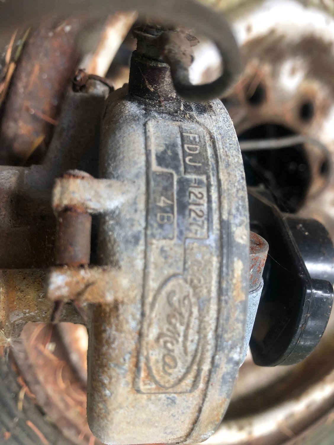

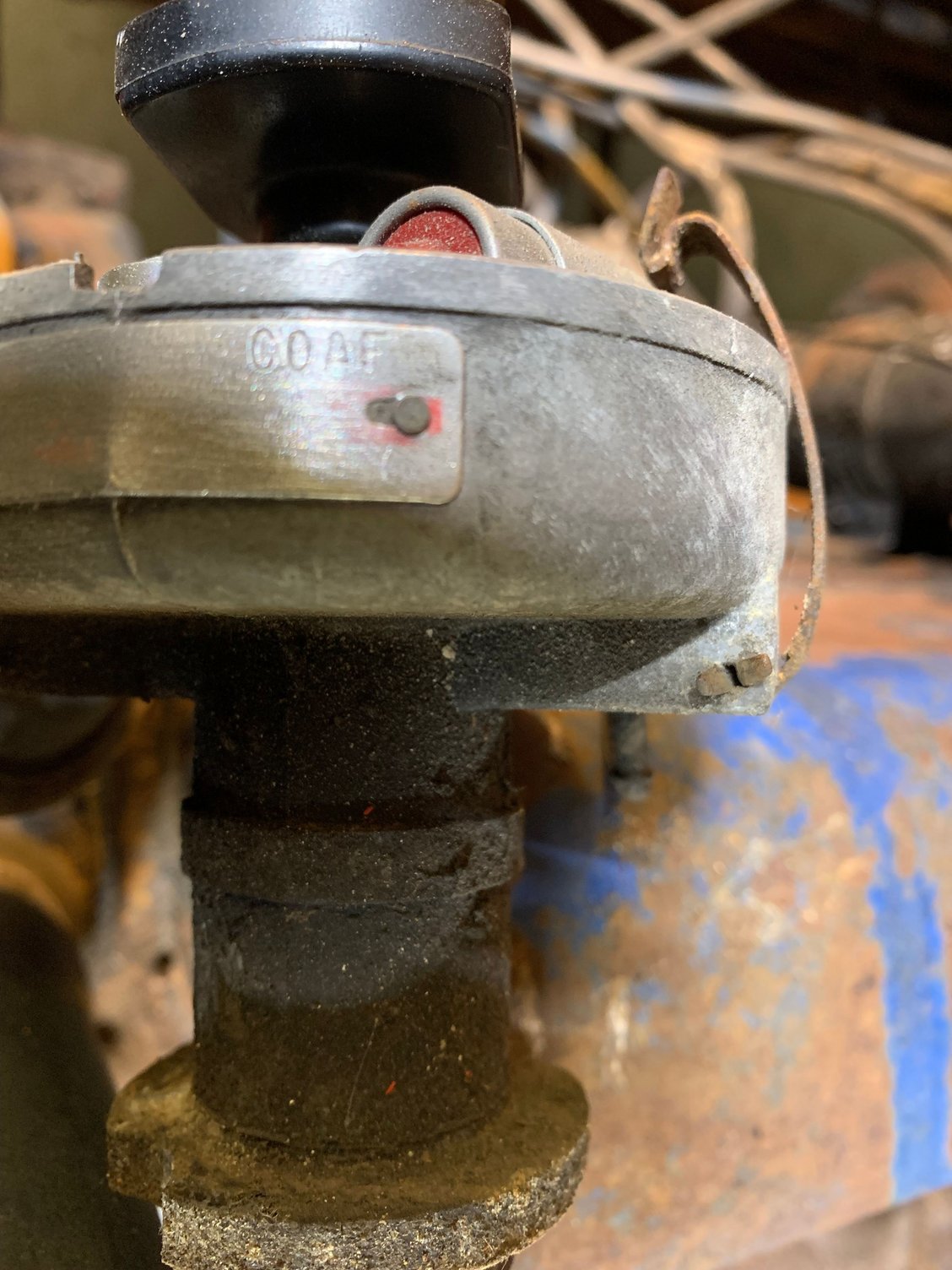

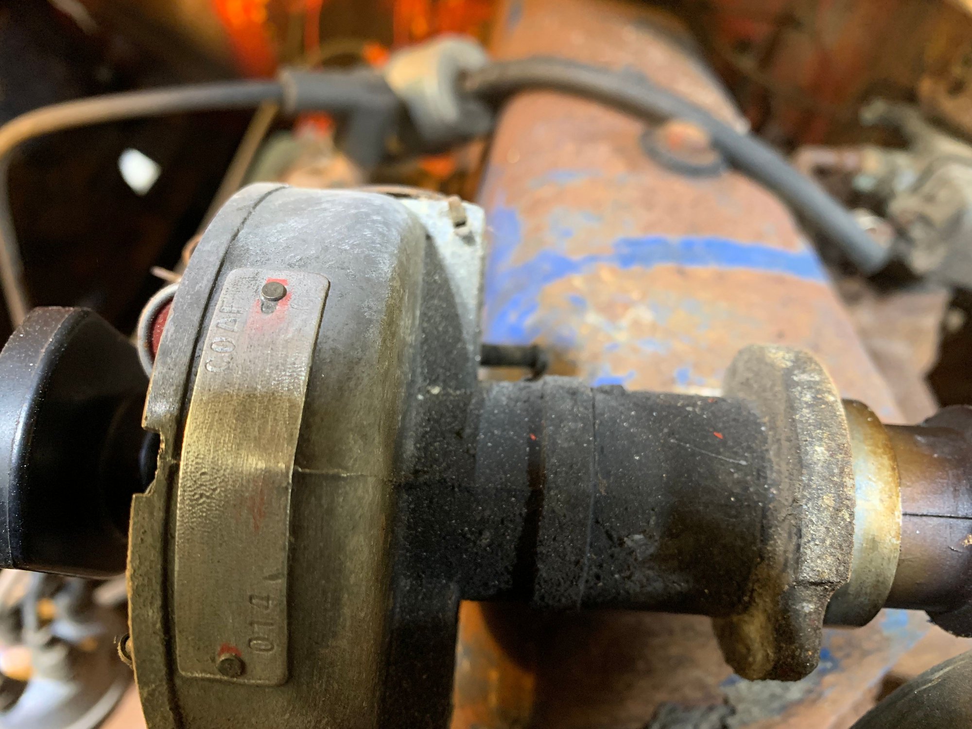

These are the only numbers I could find on my distributor
COAF 014 looks like a Ford number. It looks like you have the information you needed now. There are multiple options on coils to choose from. I use a 12V coil and power it from the same circuit as the igniter. Not sure why you would need the 40,000 coil on a stock engine at normal operating conditions…
