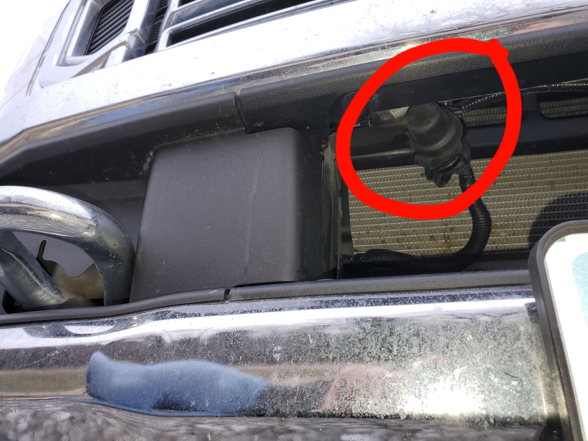

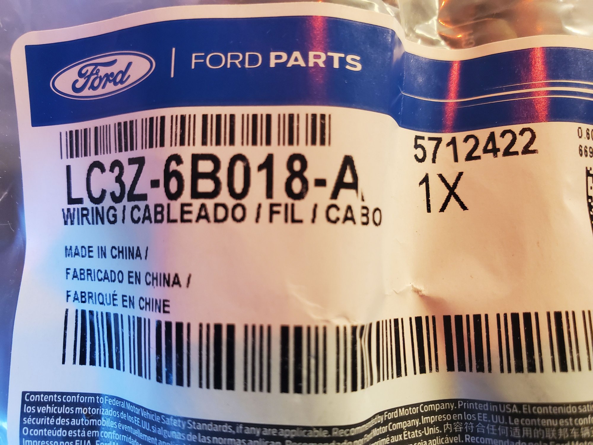

The cord changed in 2020. Part# below along with the heat element. Or at least the part numbers changed. The location is as mentioned above the starter on passenger side. Takes a 14mm Allen hex to remove the coolant plug in the block.
Block heaters are no longer standard except for a few states labeled as cold weather. The element isn't even in the block unless ordered. It should still list it on the window sticker. Ford doesn't offer a cold weather package that I've seen for 2020+. Ford doesn't even list a cold weather front cover that last I knew.
Edit: Added cord bumper location picture.
