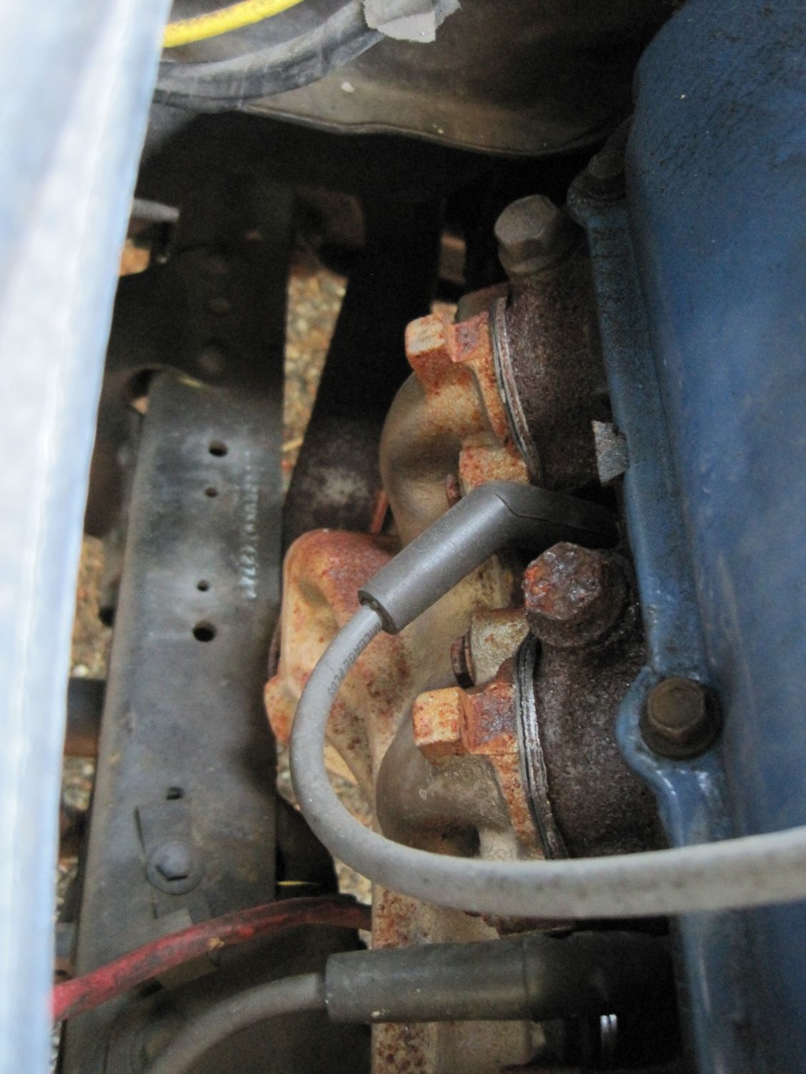

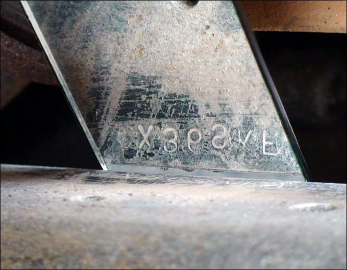

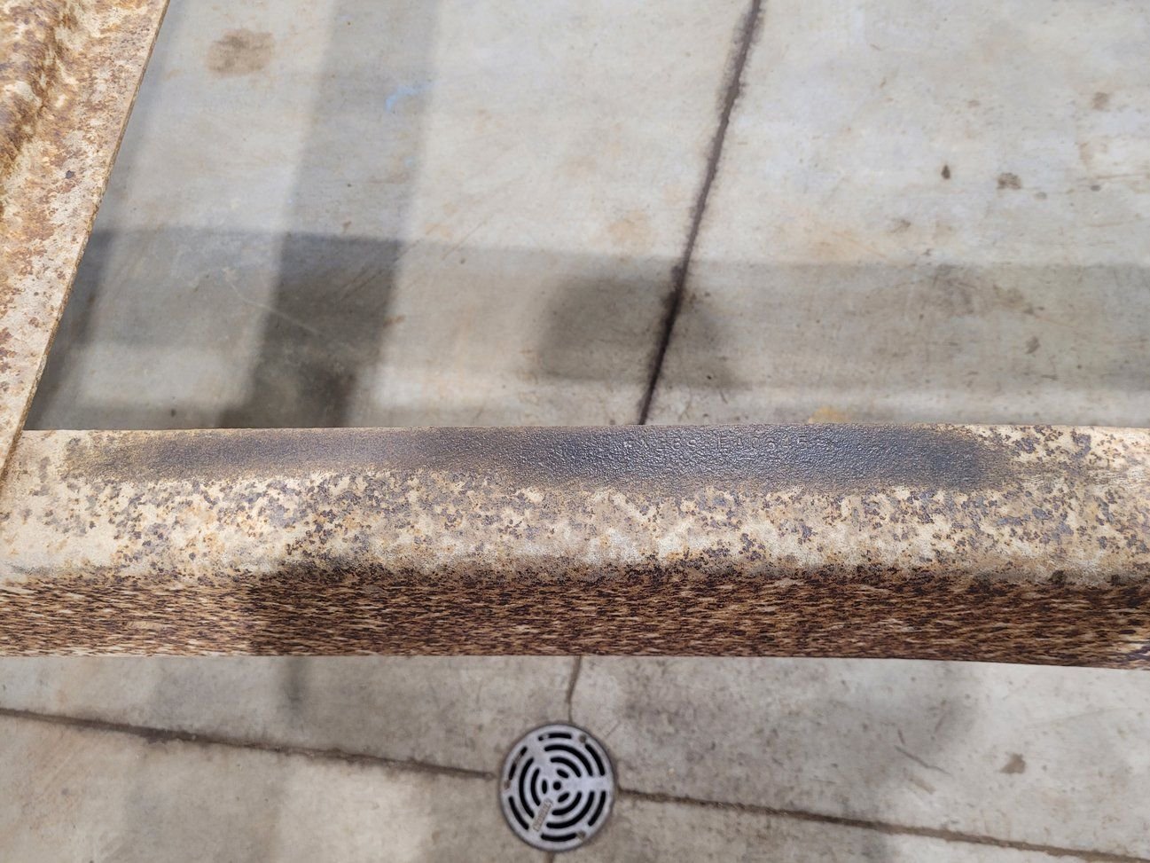

Well I hate to fuel the nervousness, but did you get a paper title and did you make sure the paper title vin matches the 2 vin's you found? And FYI those are not the official "vin's". The official vin's are stamped on the frame in 2 places. But most DMV's and cops use the door tag and B pillar sticker due to its easy access.

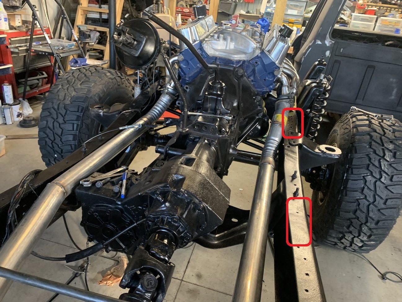

76 F250 4wd.... and ALL 73-79 F100/F150/F250 4wd's the 1st vin is stamped in the engine compartment, passenger side, top of the frame rail. About in line just past the exhaust manifold collector. And just fwd of the fwd cab mount.

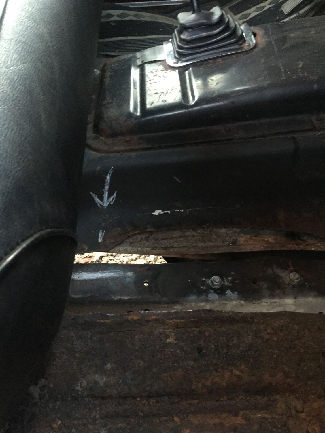

2nd place is passenger side, on top of frame rail, under the cab. HARD to get to and see. Just past the cross member bolt.
A lot of times it is rusted away.
Junk floor pan need replaced? Great time to see it, the white mark down from the arrow is it. I would not worry about it unless the one in the engine compartment had been torched out to swap in a 460 and still using a car exhaust manifold.

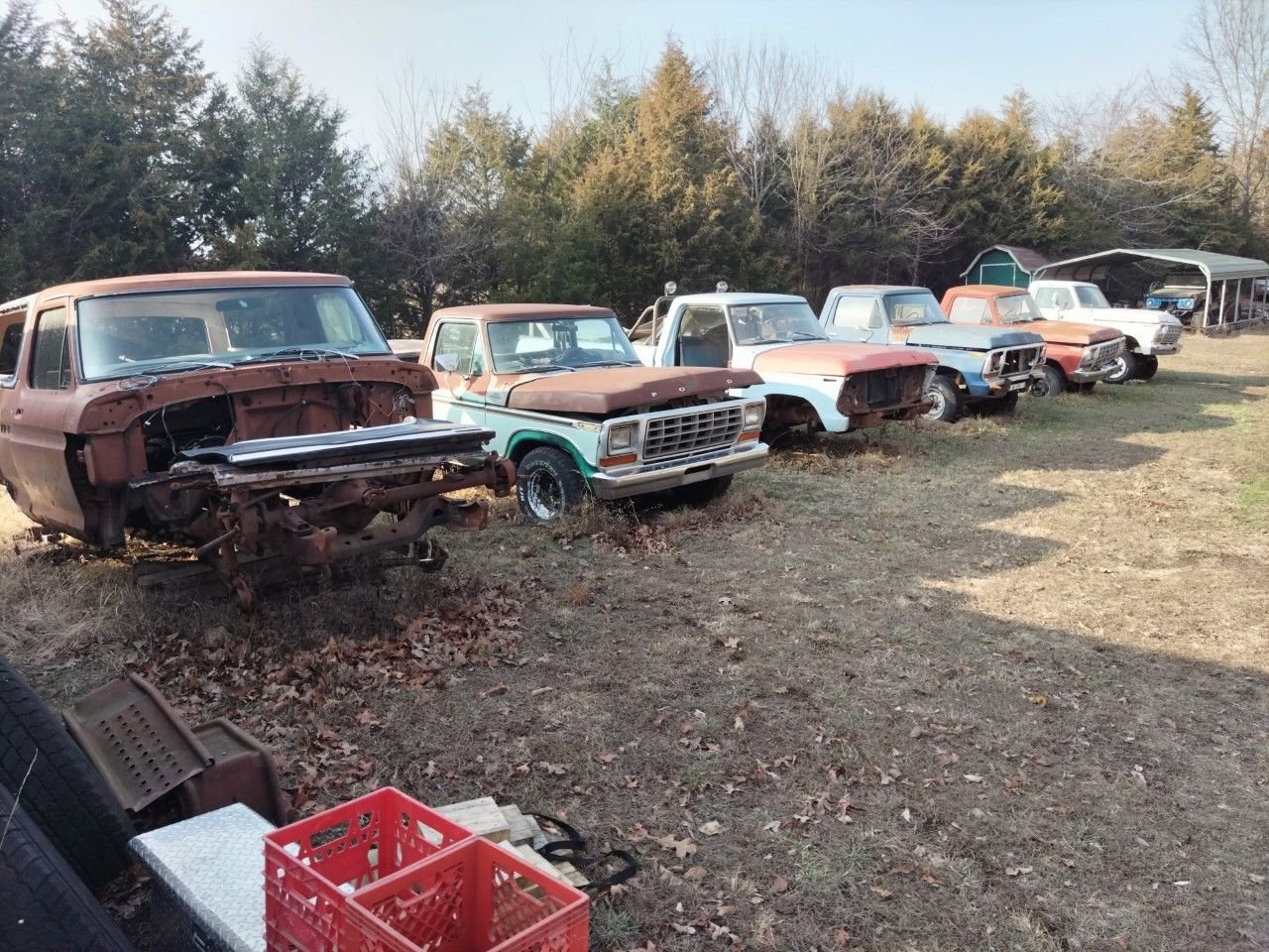

My wife spots 73-79 Ford trucks setting in fields faster than I do. And always seems to say "ha did you see that F250 back there, you better turn around and go look at it", it might have some good parts. I have ZERO issues from the wife about spending money on our old Ford trucks and early Broncos.
