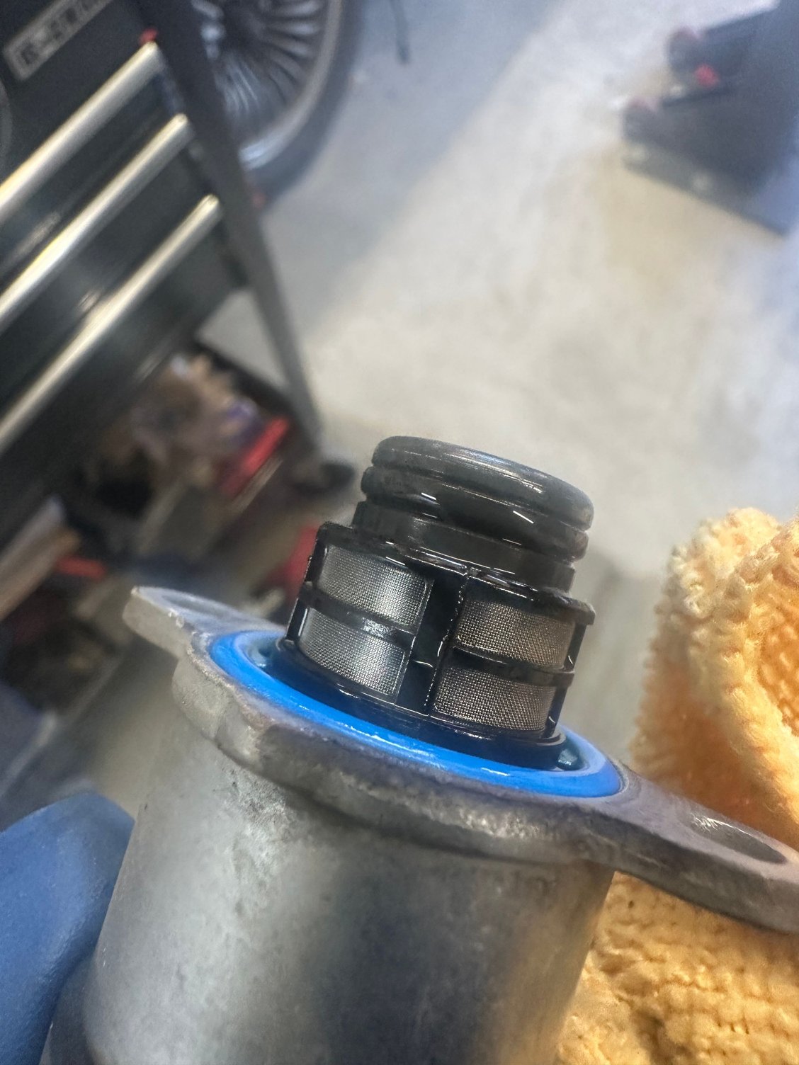

I’m dreading this but I am thinking of pulling the regulator from the cp4 and look for metal which I think will once and for all let me know if it is going out
also if it isn’t I should put the disaster prevention kit on to protect me until I can upgrade to the dcr pump

Well good news no filings on the regulator
I also ordered a new return line connector

Is it normal for the fuel to drain back when the regulator is removed?
When the refit was out I heard a slight sucking sound from the opening

If the system was still under pressure, I could see that maybe happening... i can't remember what happened when i pulled off the FCA/MPROP valve...
