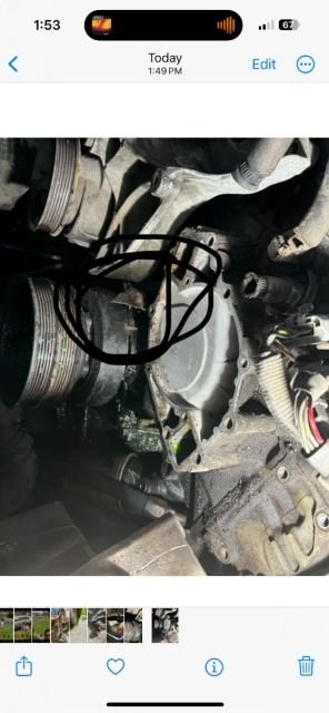

Hi folks, reaching out with a question, I have a 1989 F-250 7.5L and I am replacing the water pump. My understanding after reading up a bit is that the procedure from ford, which I did read about in the paper Haynes manual that I was using for this job, is to pull the timing cover and assemble it to the water pump on the bench, then put them both back together onto the engine. I have the water pump off at the moment, but there is a piece of metal underneath that appear to be broken, and I'm trying to identify it (see picture). Any advice as to how to proceed would be most welcome. Thanks,

I'm not super familiar with the 460s, but that looks like the timing pointer.
They're supposed to look like that more or less.
