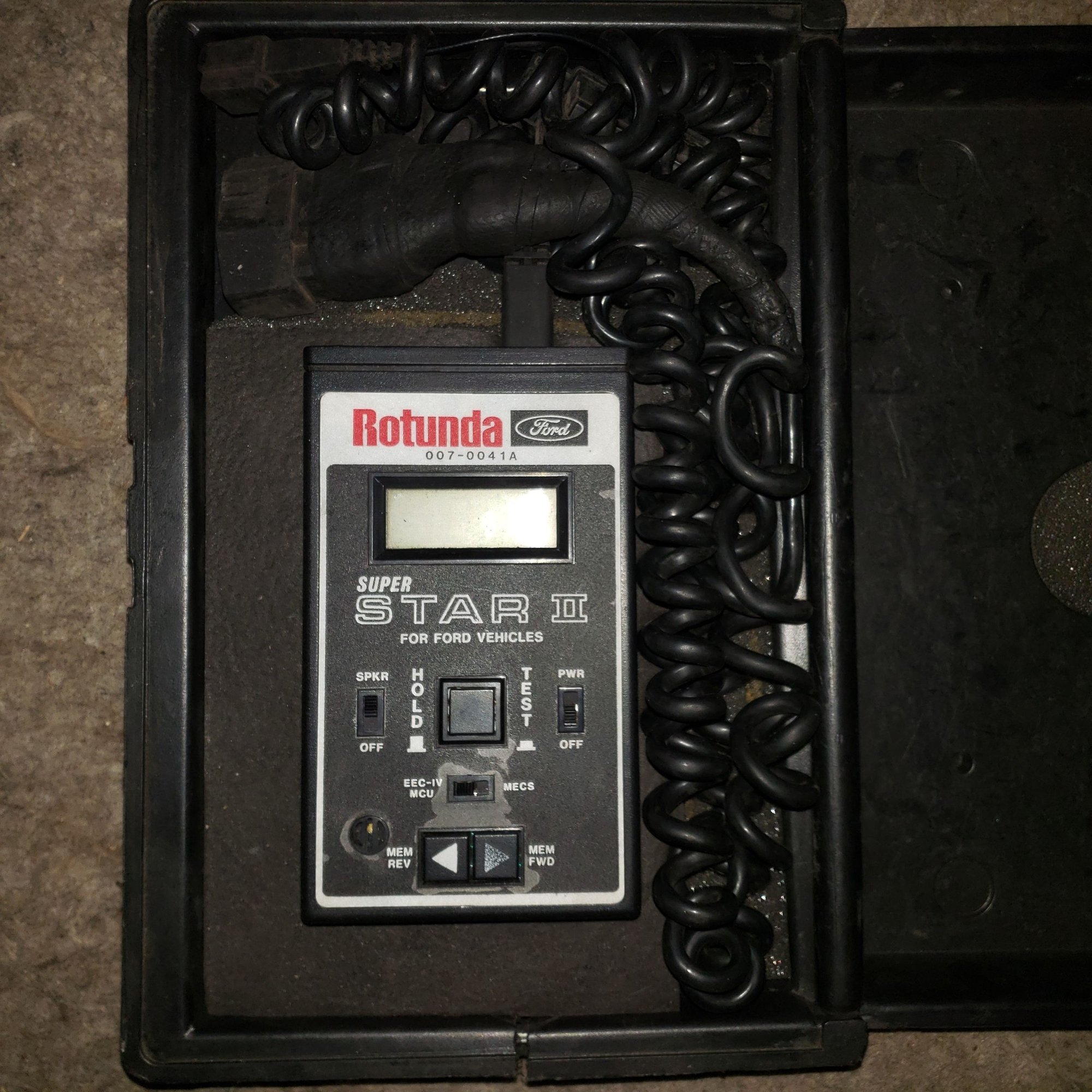

Try flood clear
Might be stubborn to start
Try to get it up to operating temp, if you can, the next time it does run
Ford Asset students were all required to build and use their own star tester boxes
Basically, a paper clip method but in a box with its own light
Those plans are still out there
So are the OEM star testers like this one
