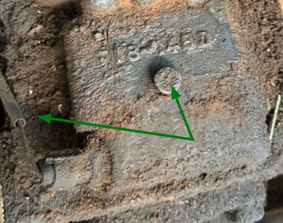

Does anyone have an idea for a fix for this? Are all T-18 top plates the same?
The shift pattern has reverse to the left and up.
I have looked for a replacement top plate but cant find one that has the same marking.
The truck is a 1972 but the owner said the motor (352) and trans are out of an old truck but didn't have much info besides that.

I know the top covers are different on the '79 and later and that's due to reverse changing to over to right and back toward seat. I think there were two different versions on '78 and earlier though.
I would reach out to https://novak-adapt.com/knowledge/tr...l/t18-t19.html
The offer almost every part for the T18 since they build them, according to their website anyway.
I would also check out craigslist and FB marketplace. On occasion I have seen T18s listed.

You can try Torque King as they have parts too. Maybe check at Bronco Graveyard too. Worst case is get your piece welded

Reverse on a T18 is to the right/up. 1st gear is left/up. I dont know if there is a fix for the above pic. That is where the pin from the shifter sits in. I guess if you can weld cast iron, it could be filled in so the pin cant move around.

So is this not a T18 then because reverse is to the left and up. What would it be?

That looks like a T18 top cover at first glance.
How many forward gears do you have? T18 has 4 forward gears. Do you only have 3 forward gears?

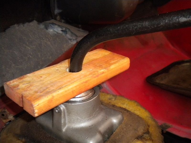

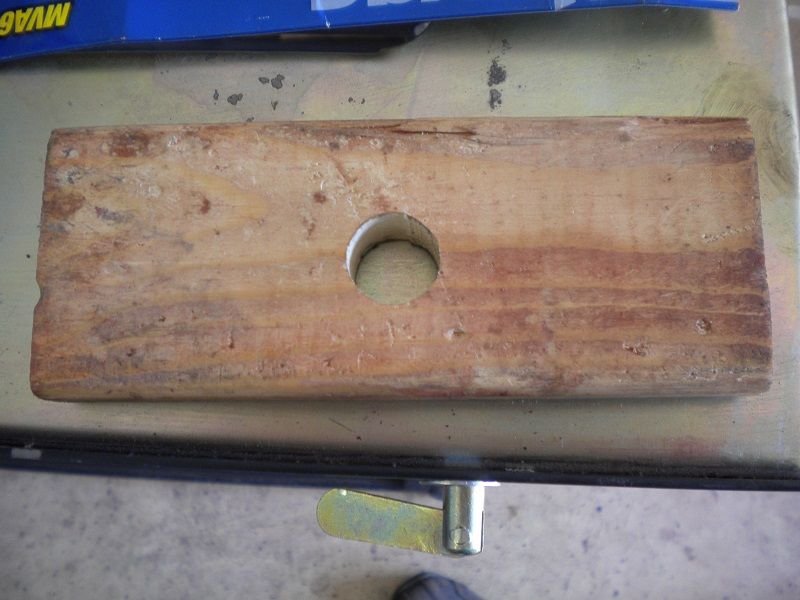

The one man board trick to get the NP-435 shift lever retaining cap off.
Maybe a little to new for a 67-72, but I can not imagine much changed.

Looking closer at the top cover where the vent is located is throwing me for a loop. All the top covers for T18s that I can find have the vent located where I have the arrow pointing to the left. Yours appears to be in the middle...
Ooooh....I like that! Removing the shifter on the NP435 is never fun. That will make it a (w)hole lot easier...

The bosses on the side here don't match a T18 either. I am beginning to wonder if you have a T19. They didn't offer those in Ford trucks, at least light duty trucks, until the 80s though. I am trying to find out if they were ever offered in older Ford trucks. You mentioned it doesn't have the original engine and might have a 352. I am curious if a 352 or perhaps an FT engine from a medium duty truck was swapped in? Back to the interwebs for more sleuthing. I like a good mystery...
