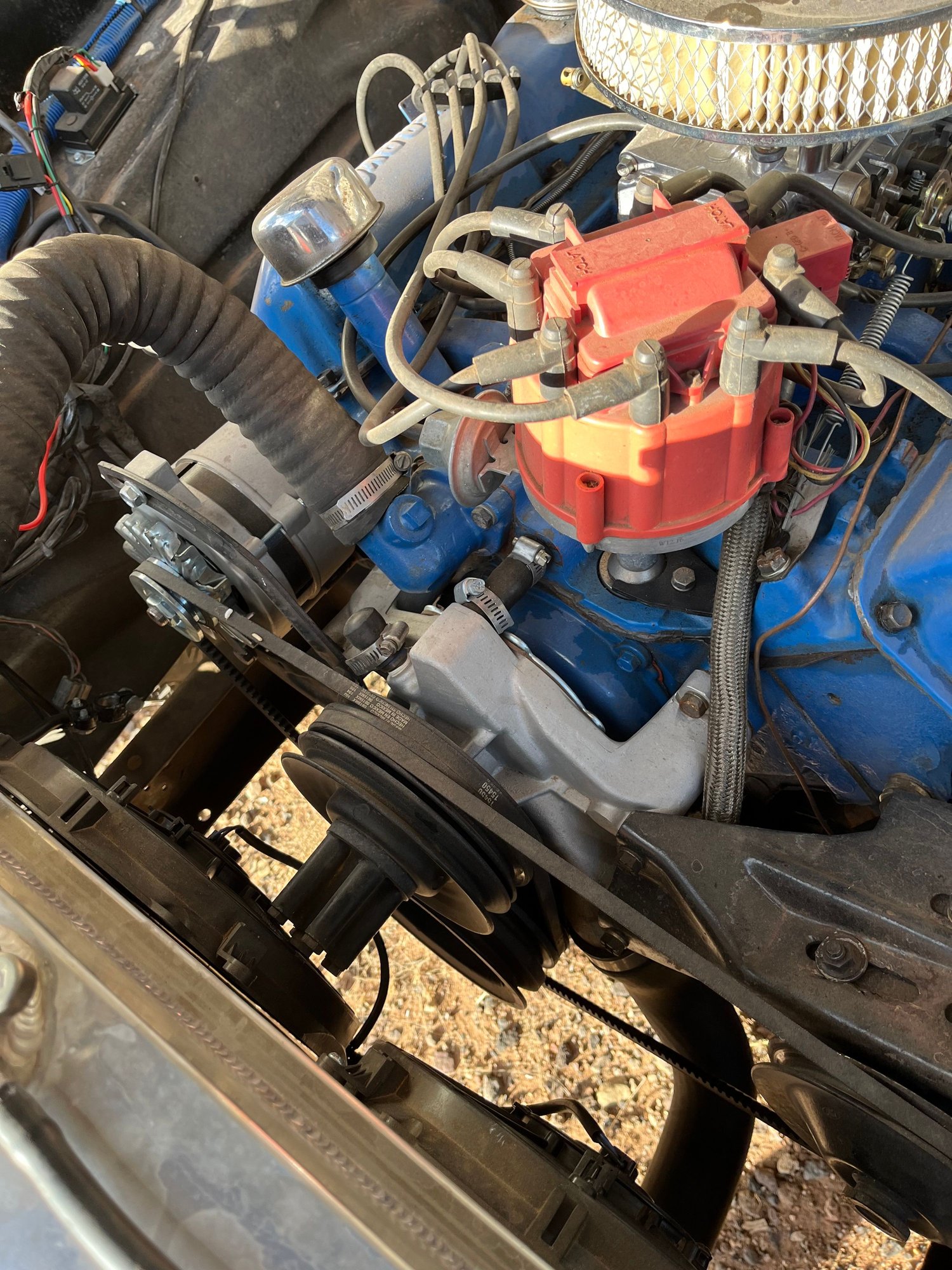

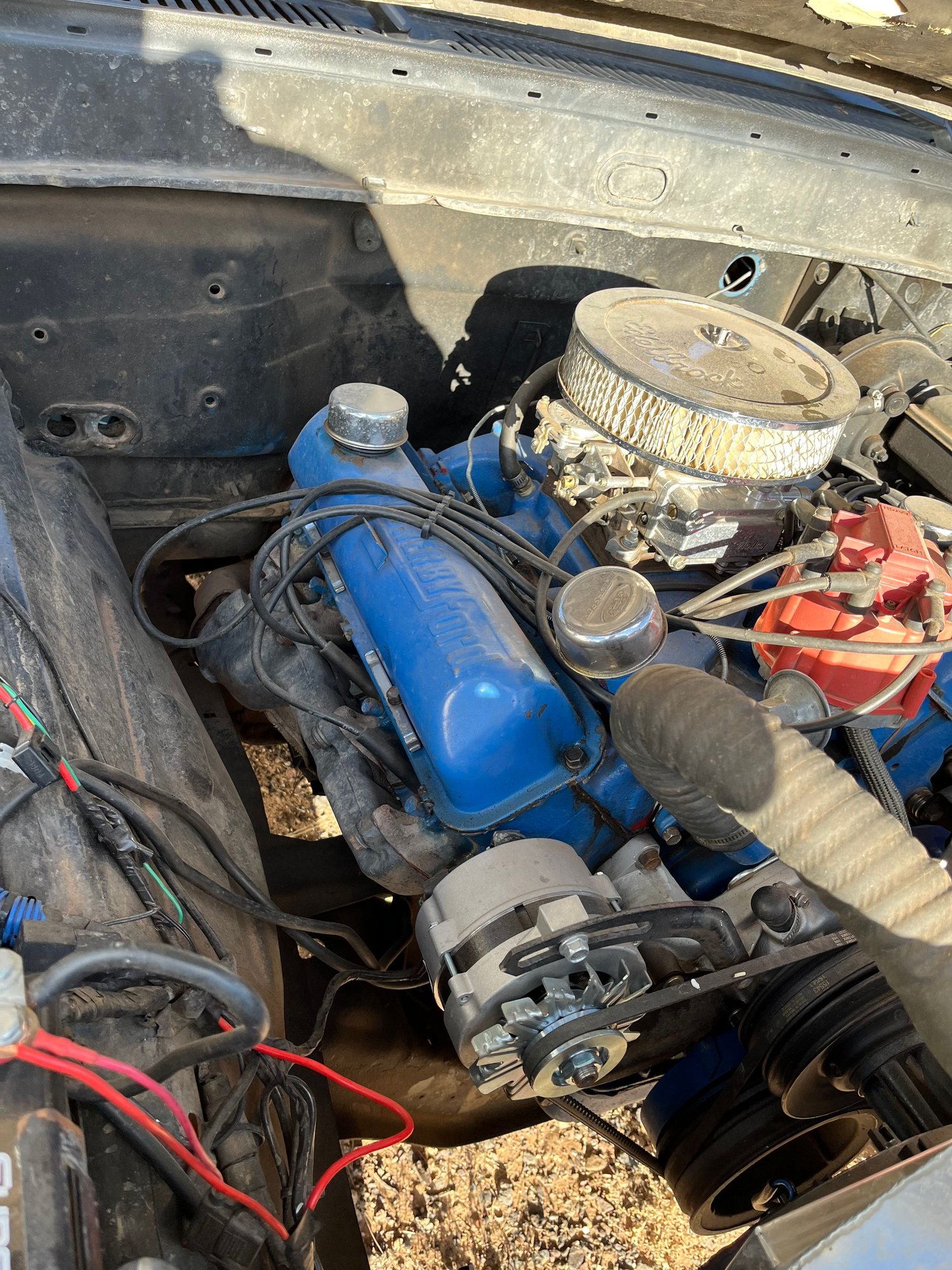

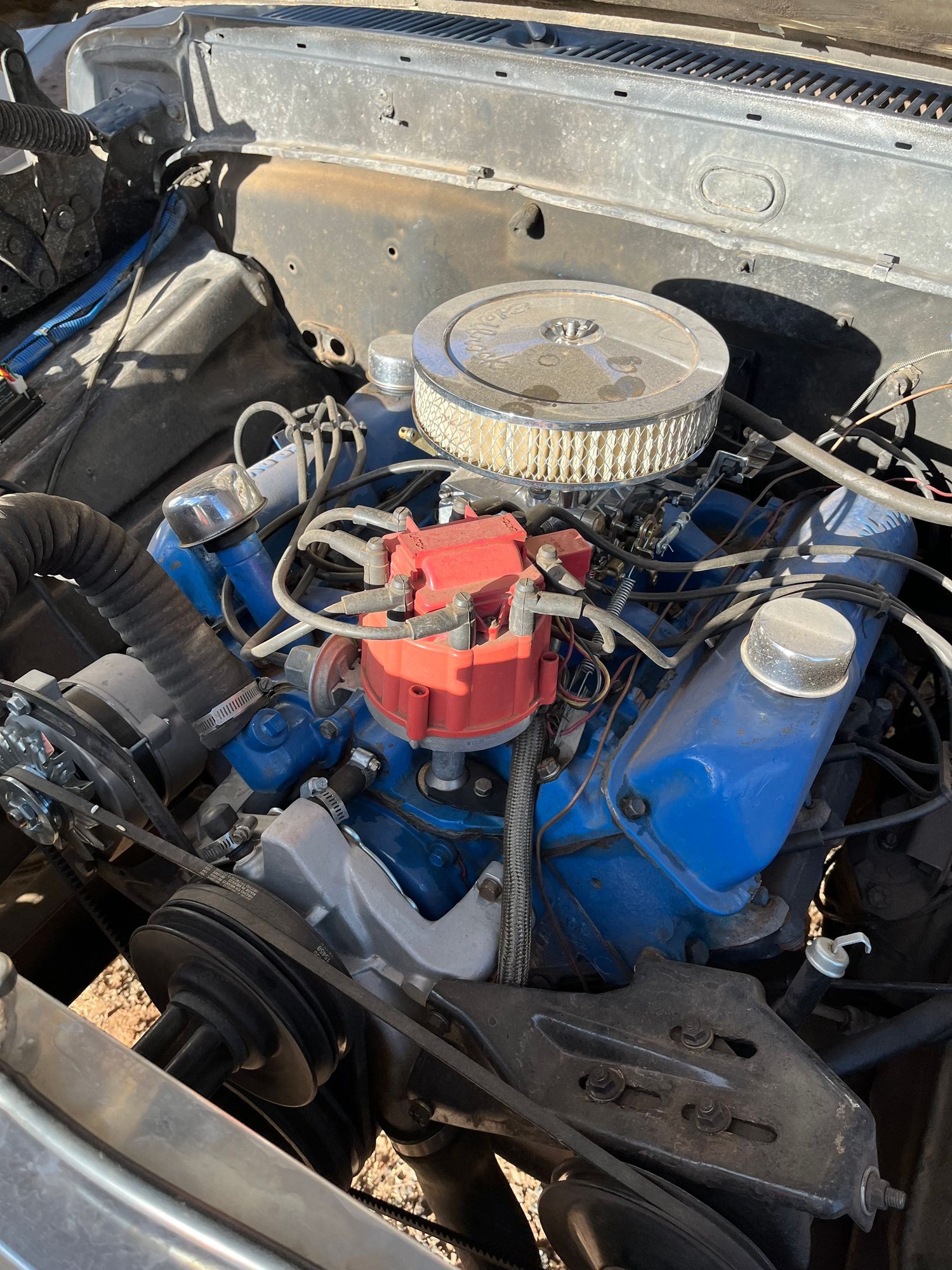

I have attached some pics of the engine if this will help
