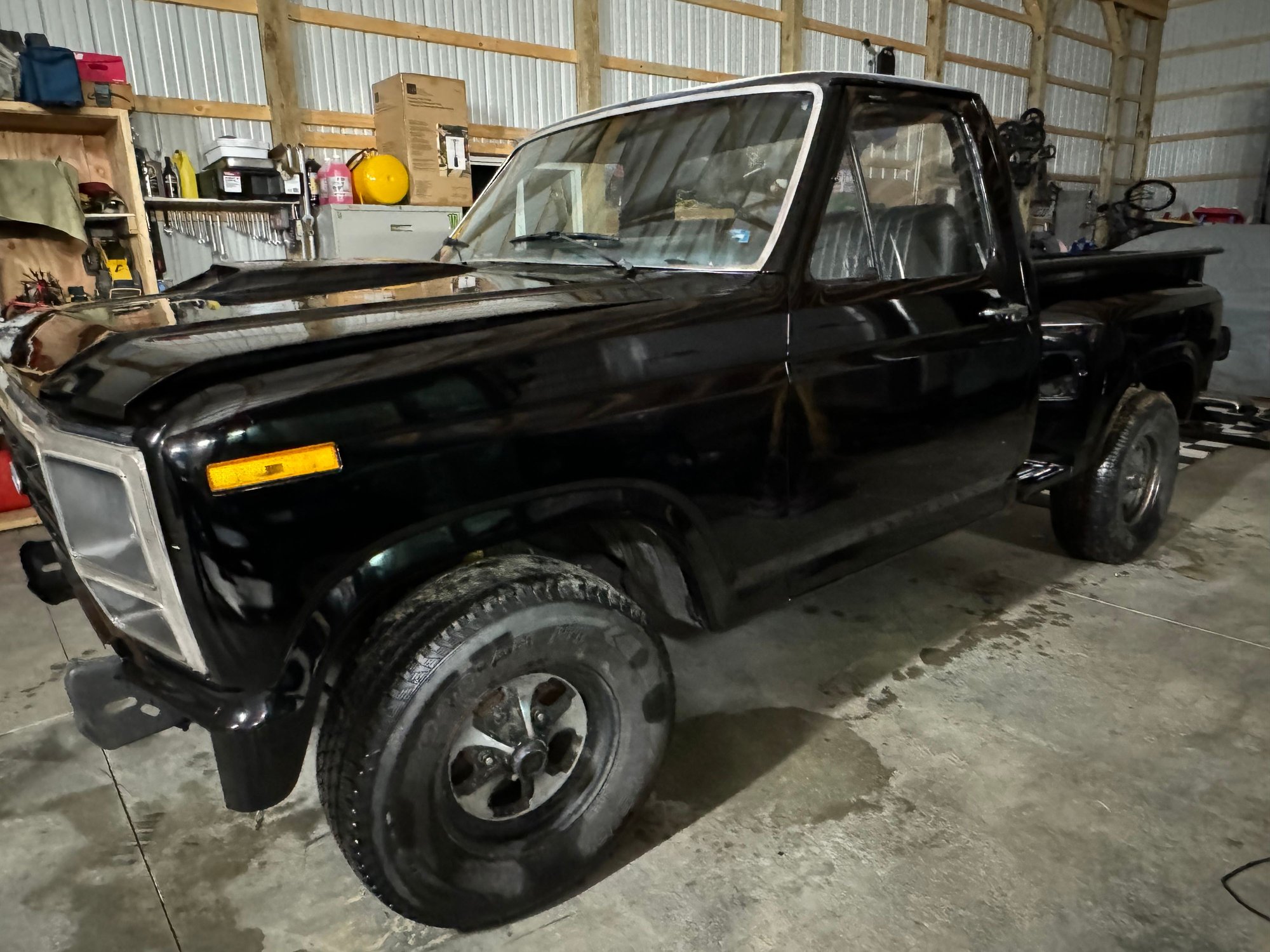

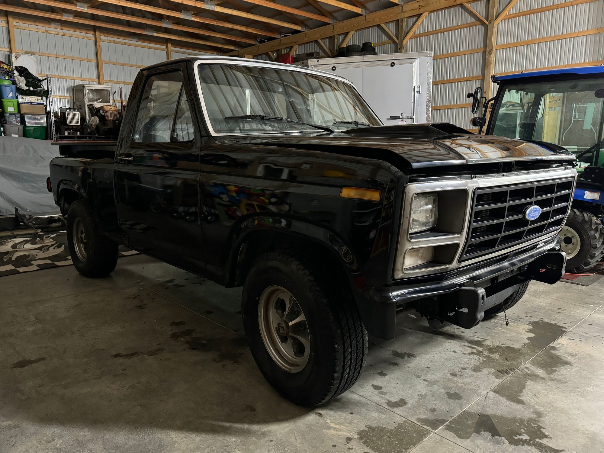

Hey all, I’m a new member and I just got a 1980 f150 2wd stepside. I’ve been searching for ways that are budget friendly to improve the stance of my truck. I’ve searched around and seen some people using axle flip kits, shackle kits, removing a few leafs for the back and then in the front I’ve seen lowering springs, drop beams, cutting the coils, running explorer springs and so on.. just wondering what some have done and how their trucks have turned out. If you’d like to share I’d greatly appreciate the help and input. Thanks! Here are a few pictures of my truck.

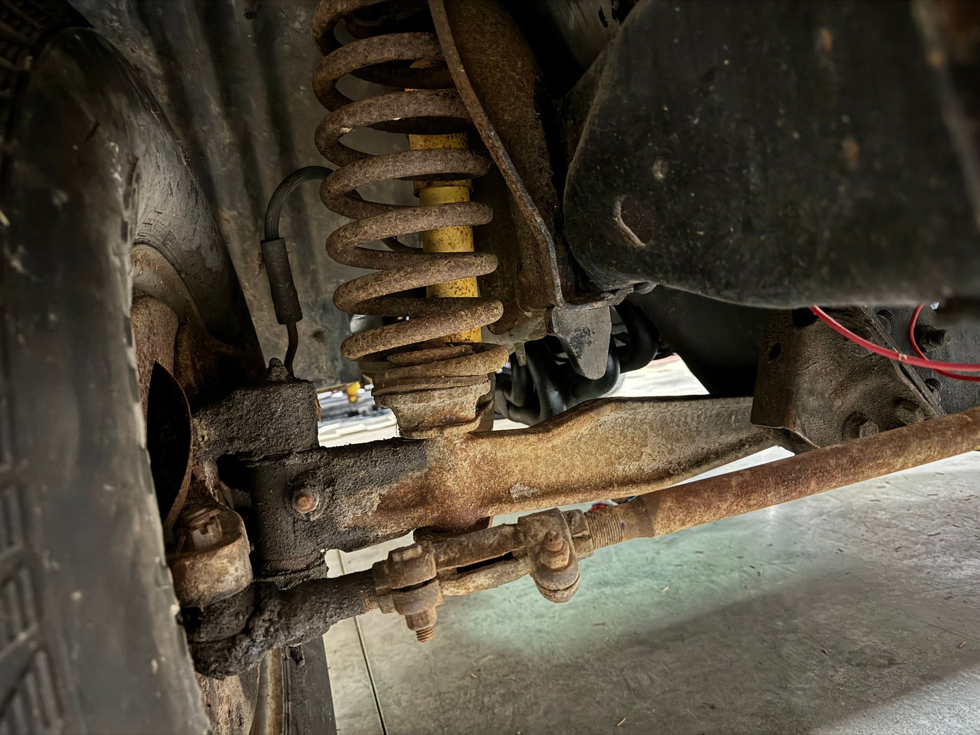

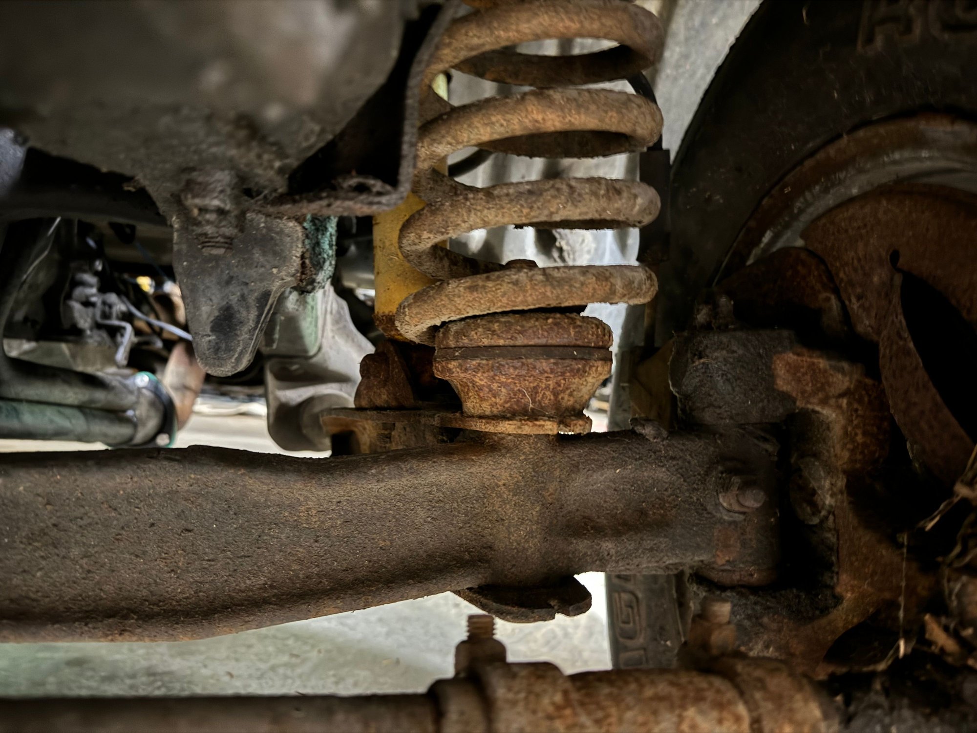

ok so I finally had a moment to get back in the barn and this is what I have in the front of my truck.

Yes that is a kingpin set up.
It has a cap top & bottom with grease fittings and that nut thru the center of the pin, It is a wedge that the nut pulls into place to hold the pin from moving.
The only way I know for sure of the pin size is to remove the pin and measure it.
But I have found if you have power brakes and small wheel pattern it would have the small pins.
If non-power brakes and large wheel pattern it has large pins.
You can not go by GVW as both of my 81 F100's were 4700 GVW
Now another reason you have to measure is you can get some smart azz like me that installed power brakes on a non-power brake truck but left the large wheel pattern and large kingpins in place.
I say if you want to lower the truck to get a set of 83 up beams on out so you have the spindles brakes etc. and get the DJM beams.
Junk yard would be undo the pivot on the beam, undo the radius arms from frame, shock & spring from the spring bucket and cut the rubber line and it is out.
Dave ----

Originally Posted by Rusty_S
One weird thing I experienced at work was an '82/'83 F100 came in all original, one owner ordered parts for it for the brakes nothing was right. Come to find out they had a F100 and a F100 HD which was a F100 with F150 brakes, I dont think the suspension was changed cause if so then that would make it a F150 and there would be no reason for a F100.
I bet if you were to look it did not have power brakes and had large wheel bolt pattern like my flare side.
The parts truck was also a 81 same size motor (300) and manual trans be it mine a T18 the parts a SROD. and both had the same 4700 GVW yet the parts truck had power brakes, small wheel pattern and small kingpins.
Yes the calipers & pads where also different. So the beams on out was different between the 2 trucks and did not find this out till I went to put my big pattern hubs on the small kingpin beams and it was a no go. That is when I started looking into why being both trucks had the same 4700 GVW.
So on the outside it was the wheels and power brakes was the only way I / we could tell large or small kingpins.
So I guess you would be calling the F100 HD the large kingpin and non-power brakes truck.
Dave ----
Old Nov 16, 2024 | 06:29 AM
Bronco638's Avatar
Bronco638
Joined: Sep 2016
Posts: 774
Likes: 104
From: Elk Grove Village, IL
I do remember now talking about the 100 having kingpins and the 150 ball joints but dont remember if we called that 100% true or not?
I don't recall if we ever came to a conclusion. But, at the time, I thought I had the original '80 TIBs in the truck. Turns out, I don't.
A quick check of Rock Auto shows ball joints for an '80 F-150 4x4. The 4x2 is not listed. So, that must indicate that early Bull Nose 4x2 trucks were kingpin.
Well I just checked DJM site and they list 80-81 F100 only and the beams they list the kingpin size.
They dont list any drop beams for the 80-82 F150 trucks so that tells me the F150 uses the larger kingpins that DJM dose not make beams for.
83 they list beams for the F150 only, the F100 was dropped by Ford, and it is a ball joint beam.
So the best option I see to lower a 80 - 82 F100/F150 that have the large kingpins it to swap in 83> spindles to the DJM ball joint beams and you can use the adjuster bushings to get back to factory spec. Small kingpins you can get DJM beams for.
This is how I would approach it, if it were me. Also, good to know I have that option since I have '85 beams.
