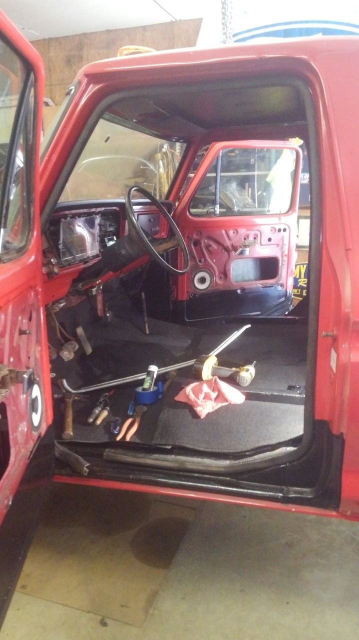

I did full-cab insulation and deadening. Kill mat (cheap dyna-mat) on the firewall, floor, rear wall, doors, 2 layers on roof. I also did bubble foil and pad on the roof. HUGE difference.
The 4 layers on the roof really cut down on the heat baking my head in 120* AZ sun.

I just did my 1976 supercab over. My truck is much quitter than it ever was in 1976. Heat and A/C are fantastic. Had to make a new head liner backer board because there are no aftermarket products for a supercab. I ordered a piece of 3/16x60x60 birch plywood from Roberts plywood. Glued the headliner fabric to one side of the plywood and new jute backing to the other side. Installed the KilMat to the entire roof, side/back walls, floor and up the firewall. New jute backing on the three wall panels. Also installed 2 sheets of the kilmat each of the inside of outer door skins. In addition I use the kilmat between the door panels and inner door skins. I also installed the later model upper door seals. Finally I installed new carpet with the mass backing. I'm so glad that took all of these steps just need to get rid of the vent window whistle

I did the same thing as smoky. Great results. The doors close with a nice solid “thud” now as opposed to our ‘76 which clangs and rattles for a second or two after closing the doors. You can also hear your passenger talk on the interstate or listen to the radio at less than full volume.

I used two boxes of this to do the floor, firewall, doors, and roof. I doubled layered it on the firewall and floor.
