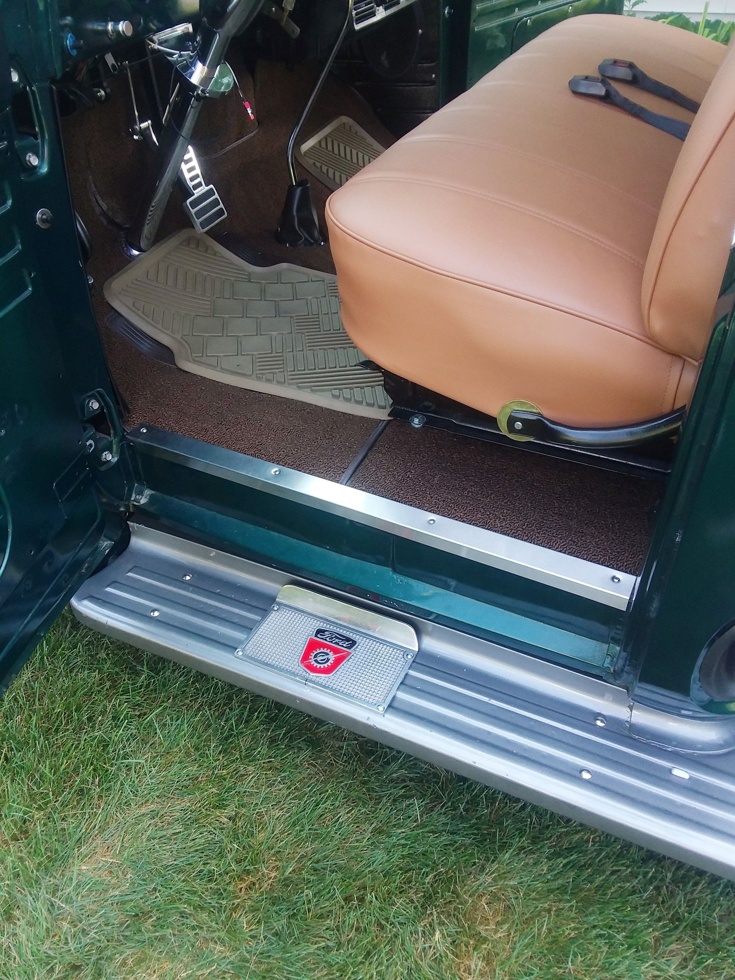

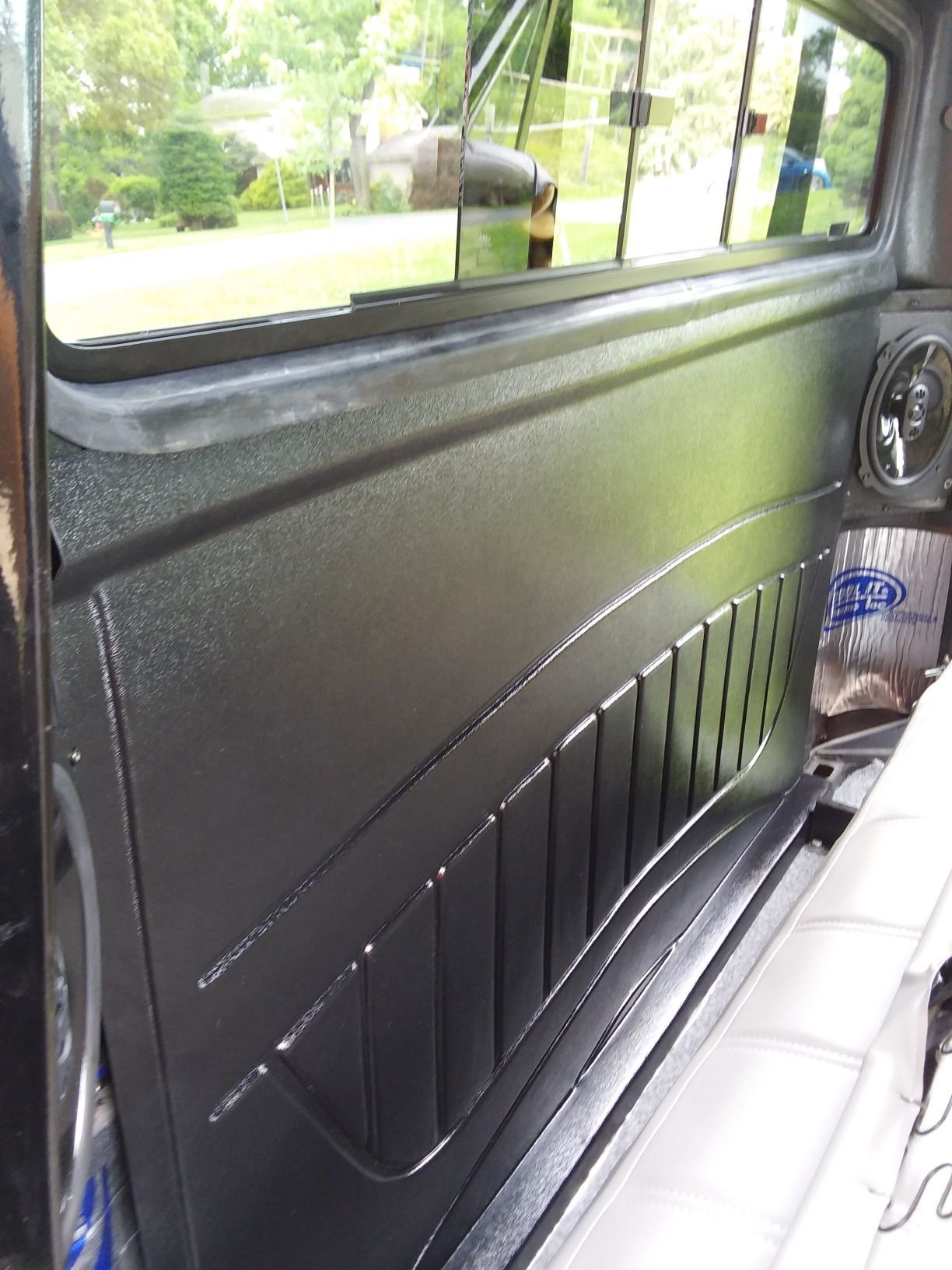

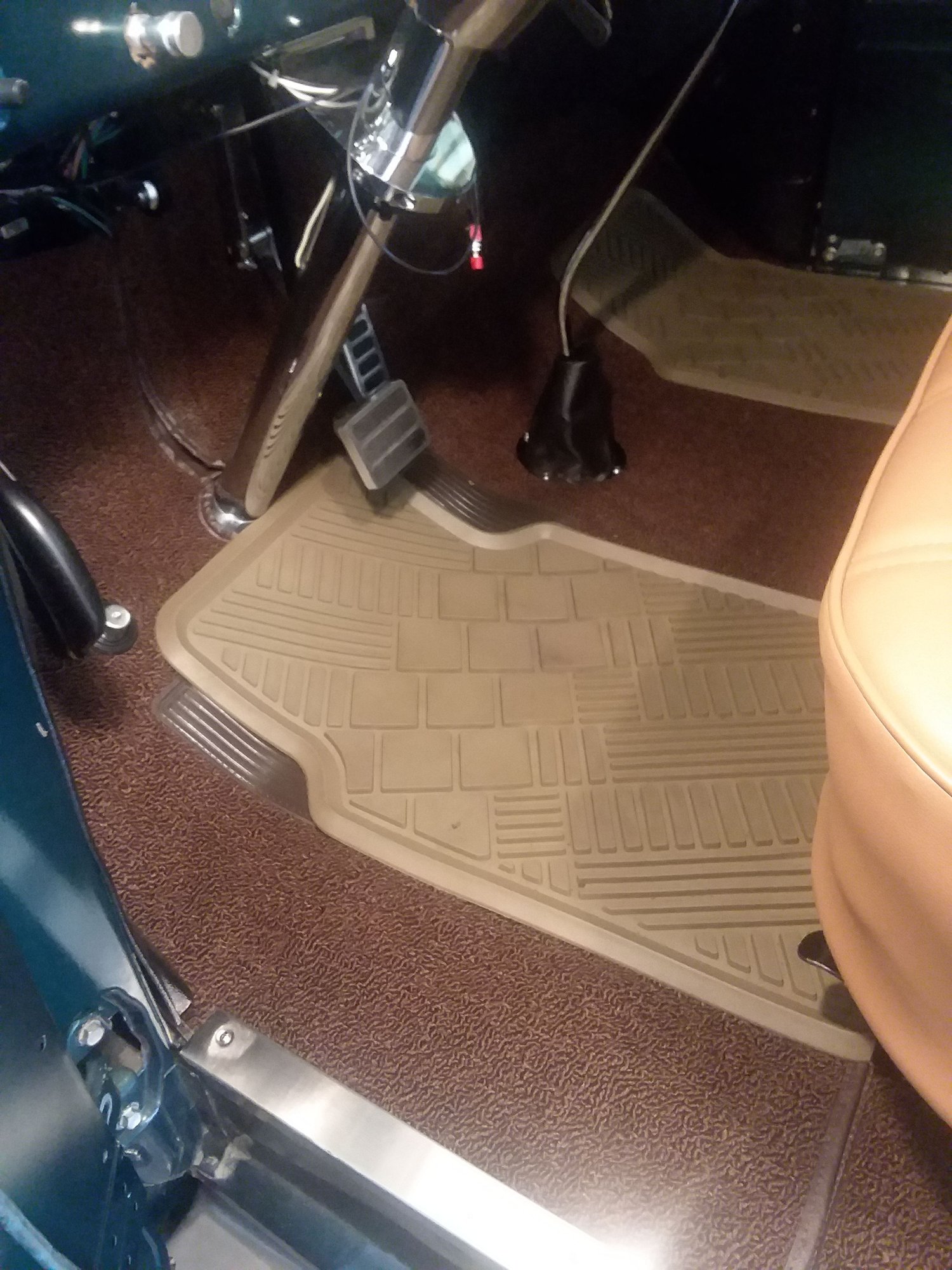

I used their carpets-- vinyl seat covers QUALITY items but they do not have samples of what they sell-----On their carpets I got to peel off insulation on back of carpet to put that down first on floor then install carpet on top--seat covers QUALITY use all new foam to contour seat--- I always use ROD DOORS interior panel kit for headliner-- back of cab-- doors---Good Luck
Rod Door headliner with overhead radio console installed
Floor insulation before carpet insulation on top
Carpet installed on top of insulation peeled from back of carpet
Insulation peeled from carpet put down first
Rod Door cab panels
Rod Door headliner

how did you figure out where to make the hole for the shifter?
Old Apr 14, 2022 | 03:40 PM
F100supercrew's Avatar
F100supercrew
Joined: Feb 2018
Posts: 494
Likes: 108
From: Allentown, PA
shifter hole
Measure over from sills at door opening get center then roll carpet out to shiftier handle mark underside cut slot front to back put over shiftier handle and continue rolling carpet out to firewall-- start trimming
