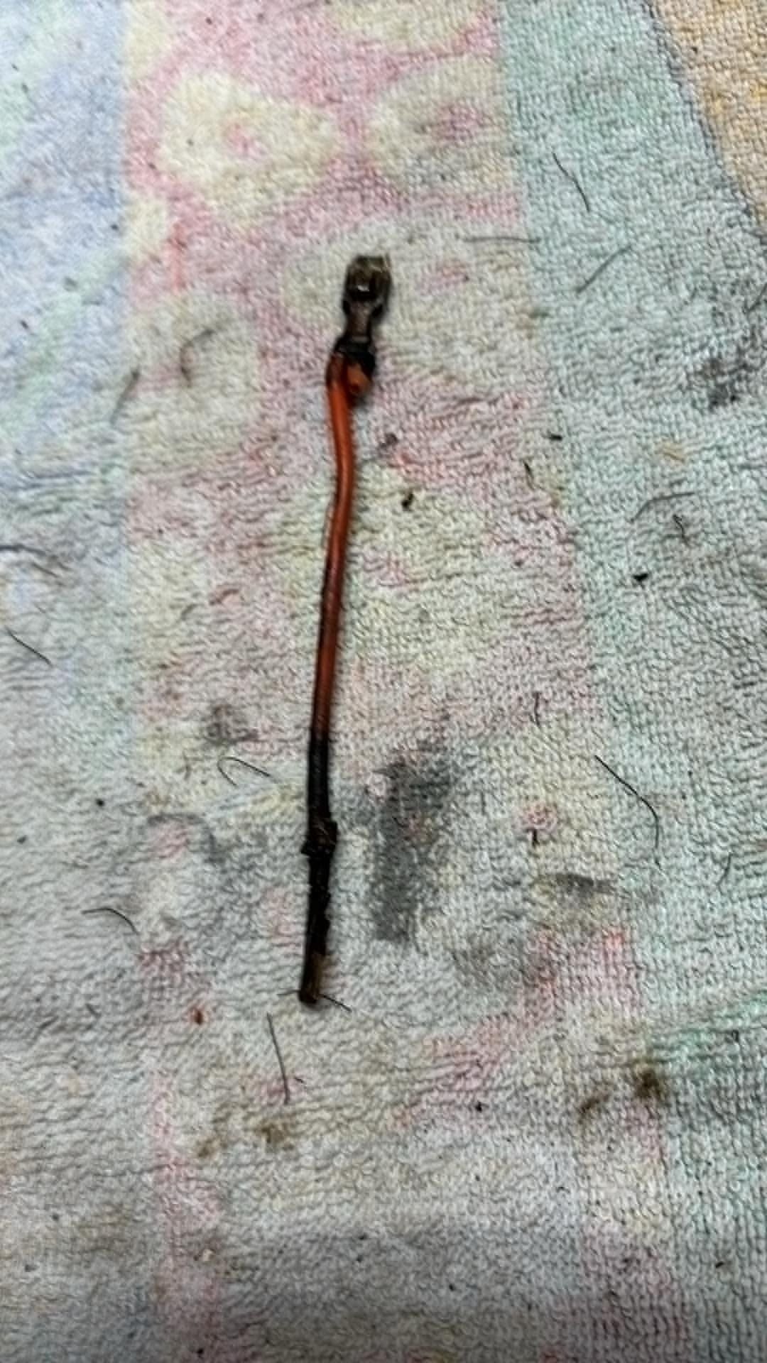

Well, I guess just me posting this problem got it fixed...got a message last last night with this picture
It's all crispy... was attached to the ign switch on a piggy back connector and buried up under the dash. Us portly older gentlemen have a difficult time getting in between the seat and the kickpanel and
working lying on our backs with a cramp in our leg and our neck hurts.
So far, replacing bad stuff did the trick... road test this p.m. Two car gatherings this coming weekend and we need this fixed !!!
thanks for all the suggestions and info... might help down the road with another.

I'm glad he found it. Apparently problem wasn't mysterious.

well Abe... little mysterious... A LOT frustrating. and the devil to get to !!!

Had a connection that looked a lot like that on the Battery Terminal of my alternator. I wondered why my electrical system wasn't charging so well
The end of that 10 gauge wire was so burnt discolored and corroded I just replaced the whole run back to the starter solenoid, with a tap off to the A terminal on the Voltage regulator. It charges great now.
Normally this connection hides under a rubber cap behind the alternator. If I hadn't removed the alternator to change the timing cover and gaskets, I wouldn't of known that was my problem.
It might pay to look that connection over once a driving season.
