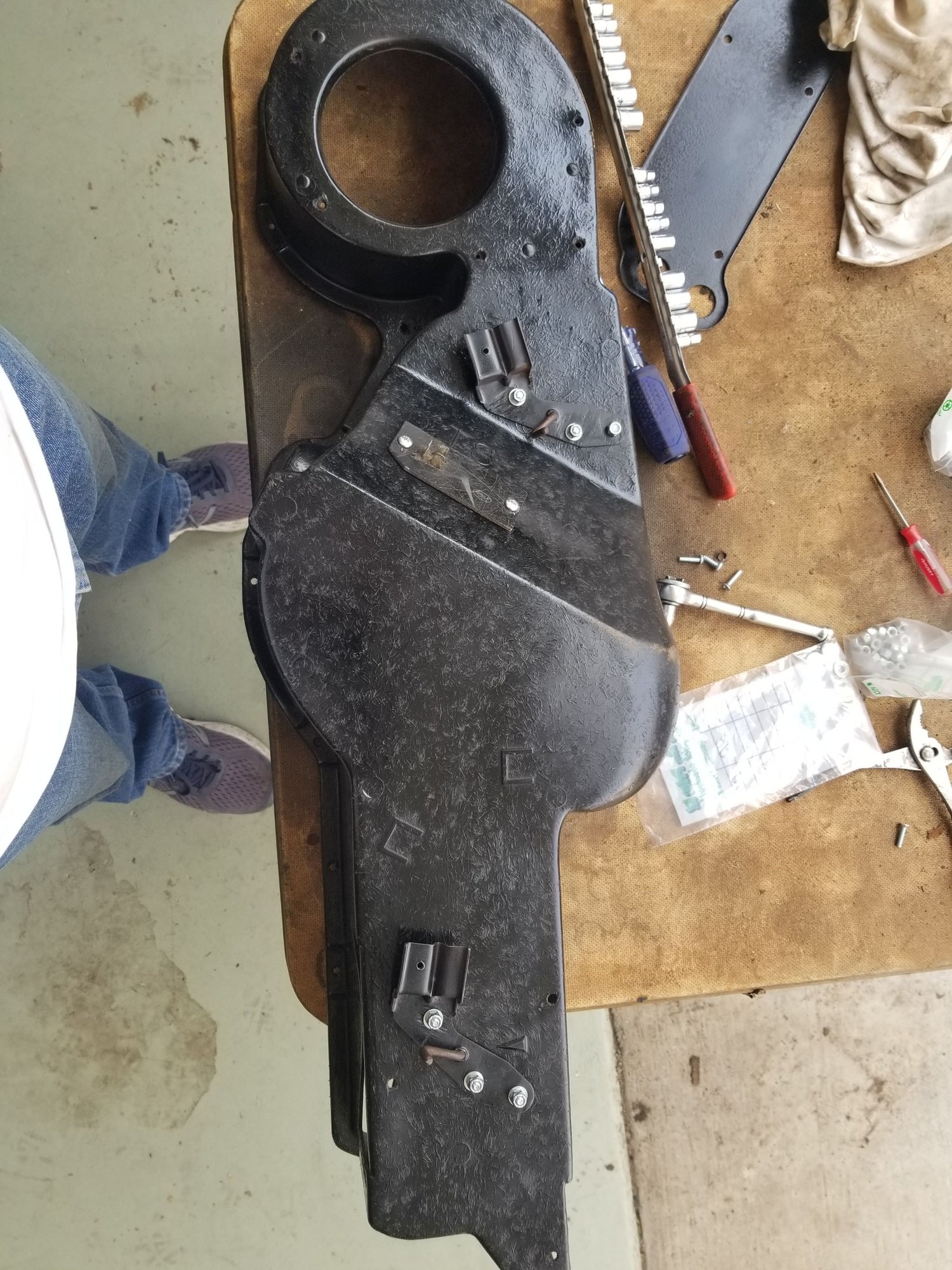

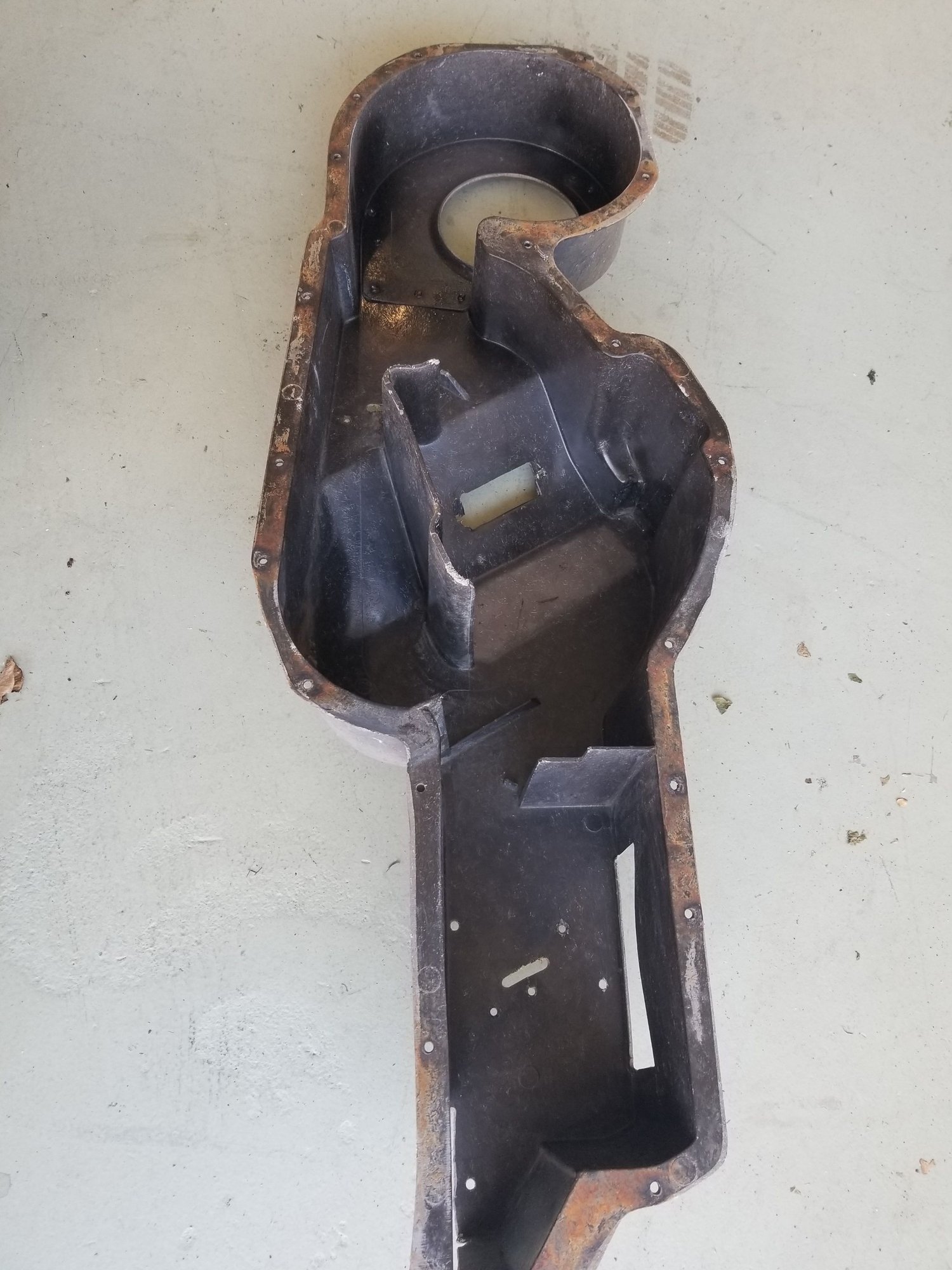

I am glad to see all the responses and helpful suggestions. With me, and I hope I am not hijacking this thread, I removed the entire heater and rebuilt the entire thing. While off, I confirmed that the two internal 'doors' were moving. I have also removed the 'out' hose from the heater core while running to confirm flow. Great flow.

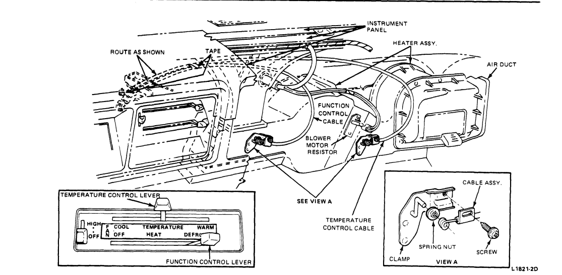

I disconnected the cable and can move the little lever, I can feel slight resistance so I assume the door is moving, but will likely have to pull it all out and apart and verify. I've also tried removing one hose to verify flow and it is definitely flowing good. I've even tried switching the hoses(which are new) to see if maybe I had something backwards but that didn't make a difference.

Perhaps it is something as simply as out of adjustment control cables. Especially on the blend door side. If it doesn't close completely you will have fresh air from the cowl bypassing the heater core and even a small leak would impact performance. There is a lot more resistance going through the heater core than around the blend door and air, like water, will take the path of least resistance.

Has it ever had heat when you initially put it all back together w/new heater core and other new parts? If yes, then what has changed to make for now no heat. So look at what could of come unattached, disconnected. What is not working right, flap door is controlled by cables, so I would start there. Any chance any thing got down the defroster vent and into the box and jammed a door?
