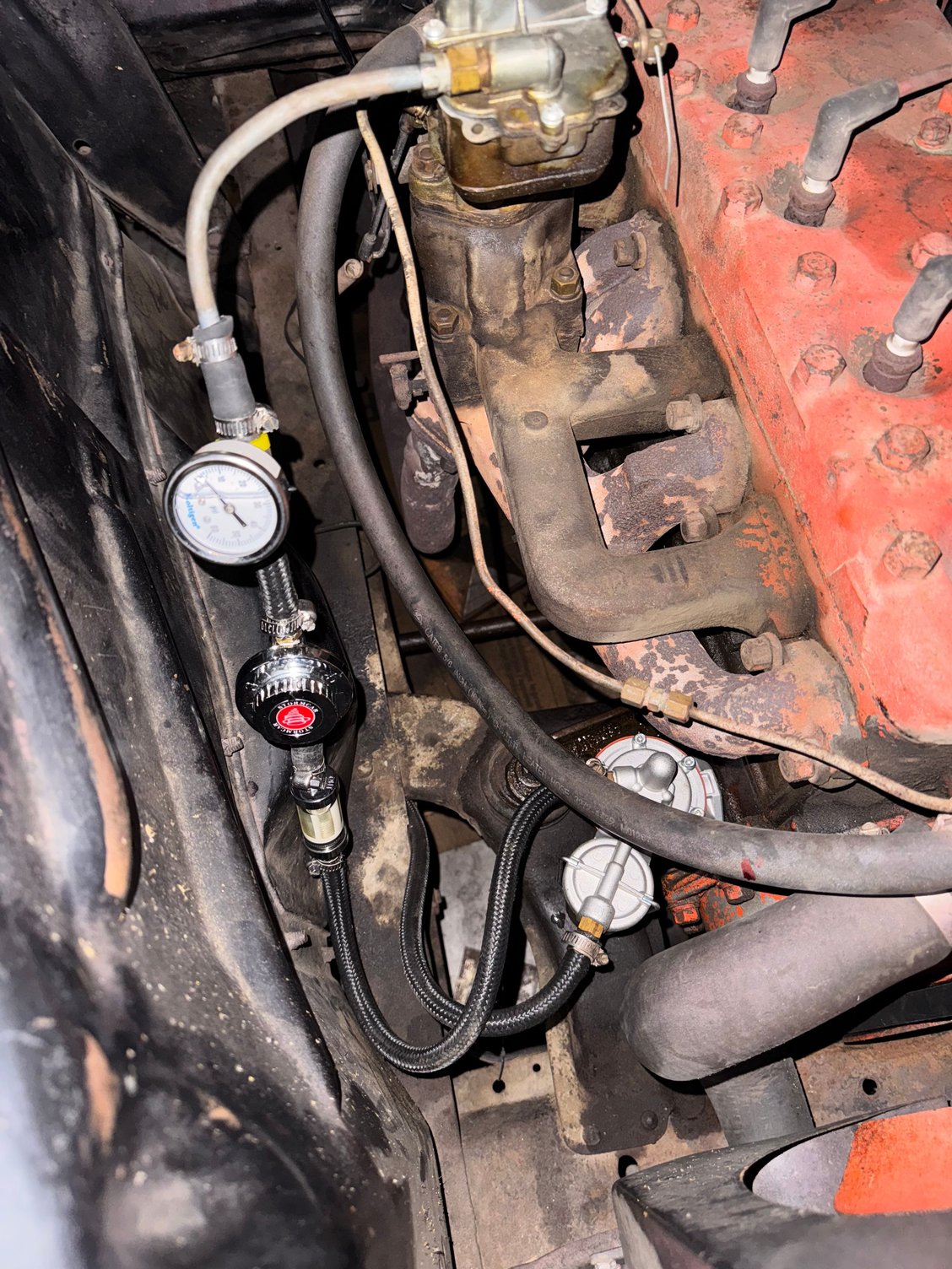

Well it’s not pretty but it’s temporary while I get done with this Christmas parade I’m prepping for.
