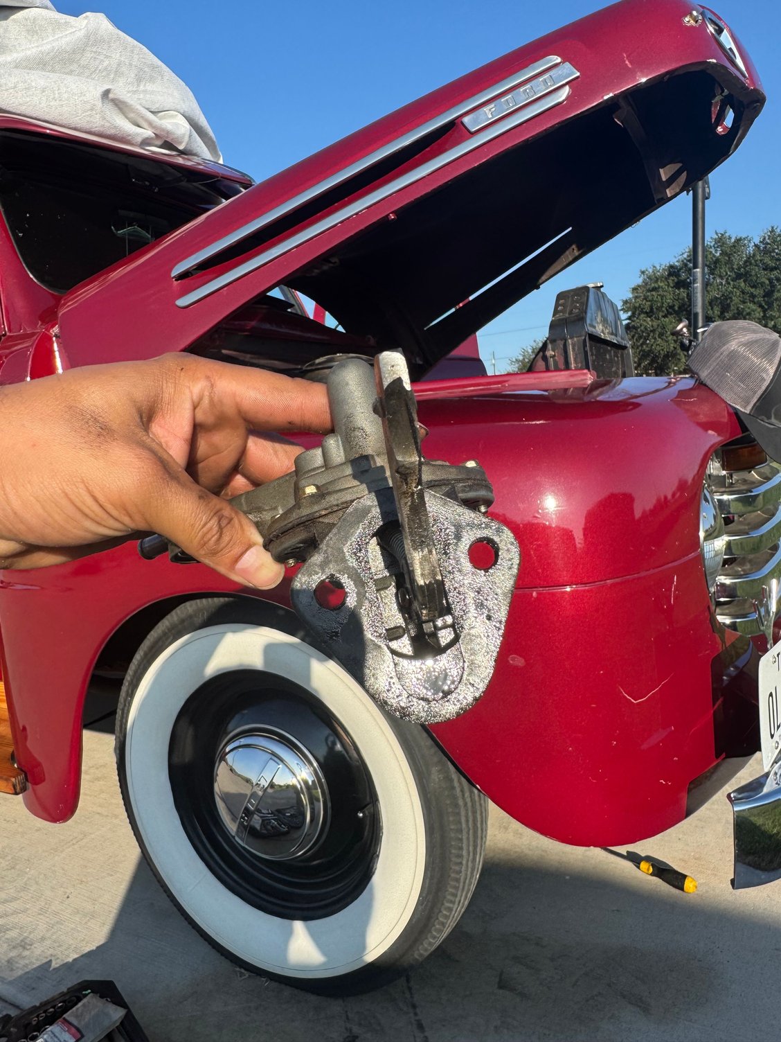

Truck won’t start 1949 ford f1 6cyl 226cu, it seems to not fill up the inline gas filter, so I disconnected the line and had some one crank the truck, nothing was spitting out the fuel pump. Took off the fuel pump, tell me what you all see. Is it worn out ?

Can't tell much from pictures. However, some thoughts:
1) Replace/Rebuild Pump. (Can provide sources later if you are interested)
​​​​​​2) Inspect/replace the fuel lines. Any little defect/leak will prevent the pump from developing vacuum to pull fuel through.
3) Inspect the fuel pump pushrod. They can wear to the point that the fuel pump level isn't actuated adequately. They can be replaced or welded back up. (V8 only, just realized you have a 6 banger, so there are lobes that can be worn)
4) Don't simply add an electric pump to this setup as there are dangers if not done correctly.

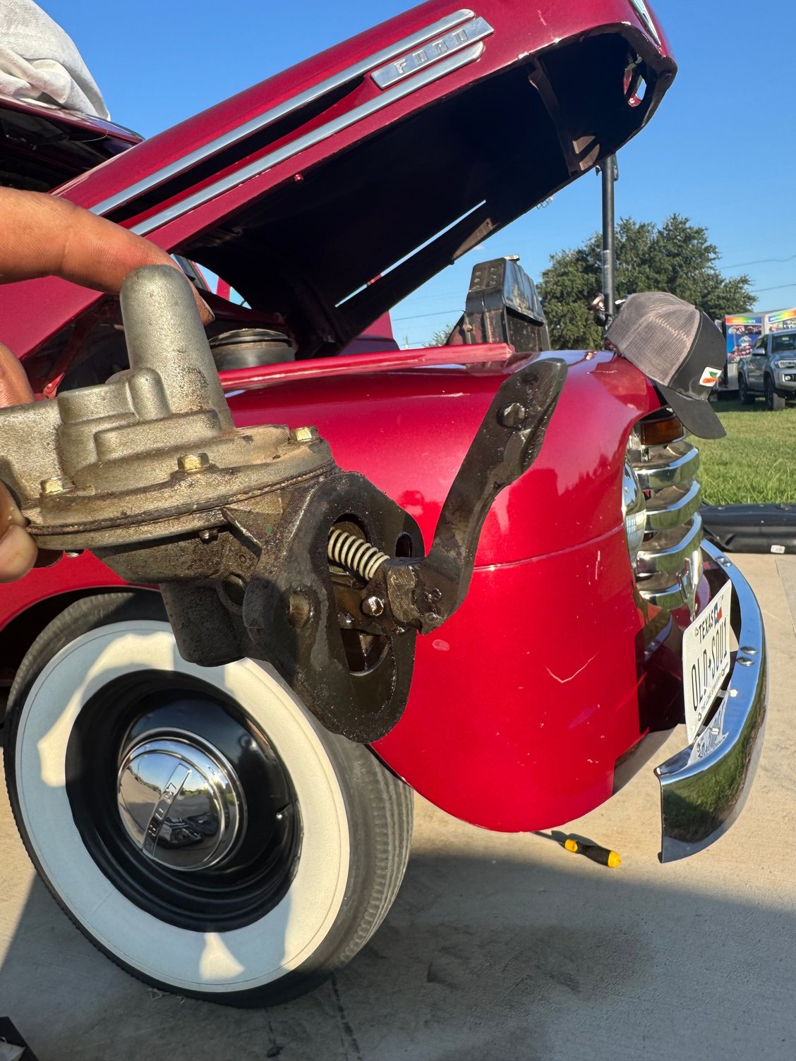

May just be me, but the arm looks worn. Hook a hose to the inlet, stick the other end in a can of gas, then manually pump it. If you get nothing from this, have a sniff of your engine oil to see if there is gas in the crank case.

You can't tell by looking at the outside. If it did not pump had them it's time for a rebuild.

So I took the pump off and stuck the line in a gas can and manually pumped it, and it works I’m sure the rod is worn I’m going to melt brass to fix what’s worn but I also ordered a pump from oriellys just in case. Thanks for all the feedback back will let you all know how it goes and once it’s back up and running

So I ended up putting brass on the worn out part but I also bought a new fuel pump from oriellys for about $68 I installed it and truck runs fine! So I have the old fuel pump as a spare
