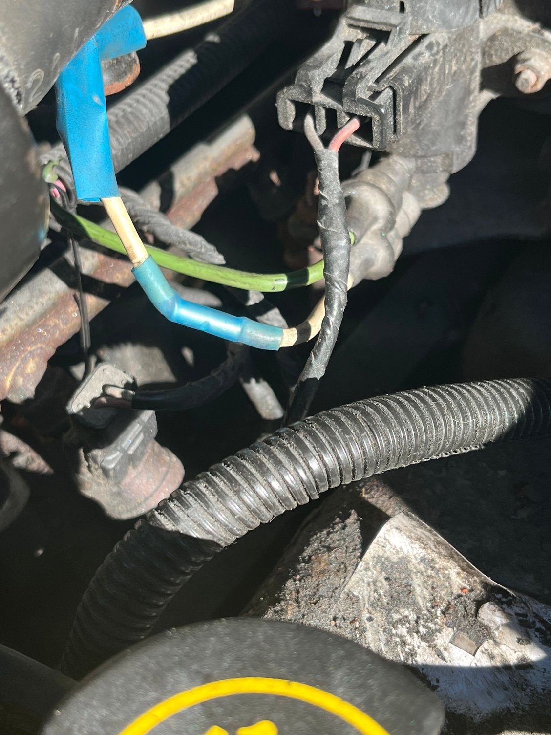

the vss I looked and it’s all hooked up. I saw they added a new jump in the wires running down my frame, possibly vss issue?

The VSS (Vehicle Speed Sensor) will affect your shifts. If the speedo is off / not getting a good clean ‘signal’, the trans will not know when to shift. Is your speedometer bouncing around / sticking? You mentioned wiring, “they added a jump”. I’d go through that first and see what they did. I’m not sure what you mean by ‘jump’?

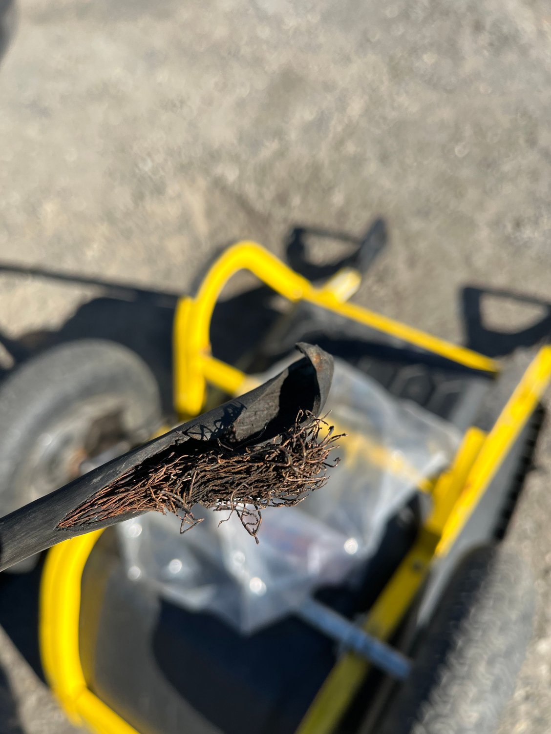

Ok so I sorted out grounding issues and found a leak in the vac system that was throwing the egr code. I’m hoping the vss code was from the bad ground. I blew on the line running to the egr and heard hissing on the other side of the intake. First tube I grabbed came apart. Temporarily fixed it till I can run new vac lines with an electrical connector. It worked and is not leaking. At least not enough to throw a code. It’s hillbilly as hell but 80 miles and no cel.
thank you kindly for the suggestions, I also sanded down the new fenders where they painted over where the grounds connect.
