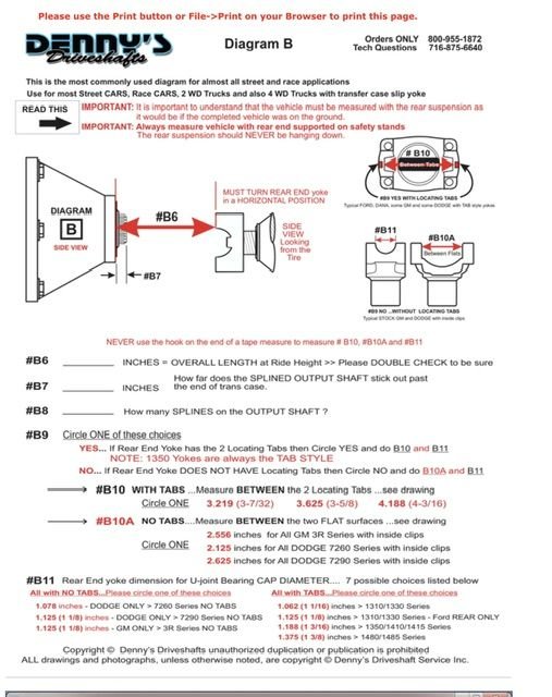

You would know better than anyone on the internet how long the driveshaft needs to be. Get under there with a measuring tape. Go to one of these websites
Originally Posted by JJF20
Look up Tom Woods or Denny’s driveshafts.
Put what information they need in the order form for a driveshaft.

You have not looked on those websites that were mentioned. Use this
or this one
or this one
You do not use the old driveshaft to measure for a new one.

Simply go to the junkyard and get a yoke for your 5 speed trans
Install the yoke in your trans and measure for shaft length
Last one I had built, the driveline shop just had me measure from the output shaft to the rear end yoke
Note
Thank God 9 inch Ford rear ends had 2 pinion lengths
That's why you use a yoke and measure center to center to the U joint caps
