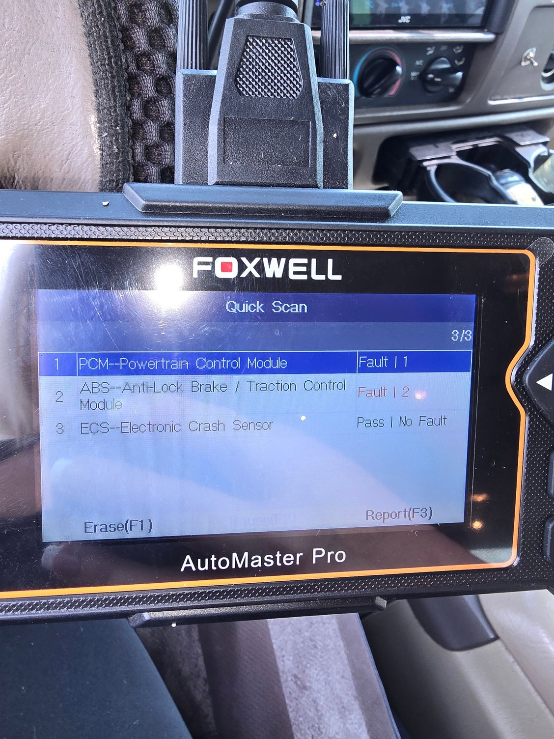

2000 ford excursion 6.8 v10

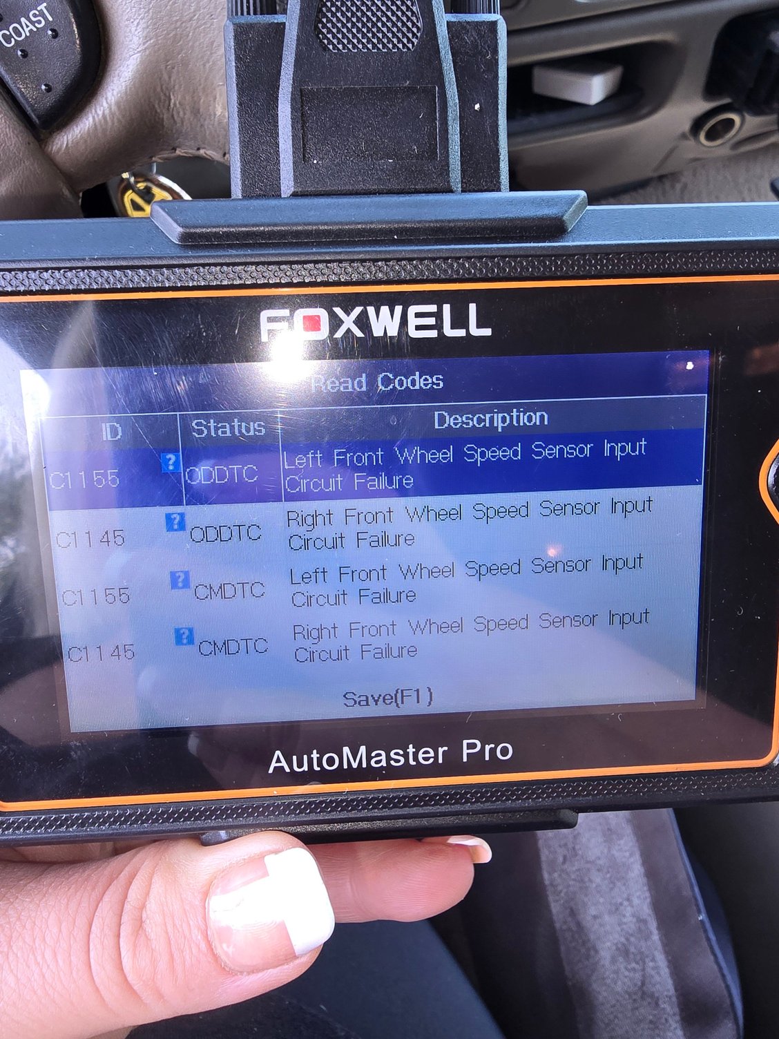

Changed spark plugs , oil, air filter, and fuel filter in July.. 2 weeks ago it started idling funny sounds like it wants to kill in reverse or drive.. Runs rough at 40mph.. No check engine light
Changed fuel filter again just in case
Obd2 reader shows fault on pcm and abs speed sensor input circuits.

I'd recommend checking for additional codes with FORScan. It will often report faults that other scanners miss. Plus, its free.
