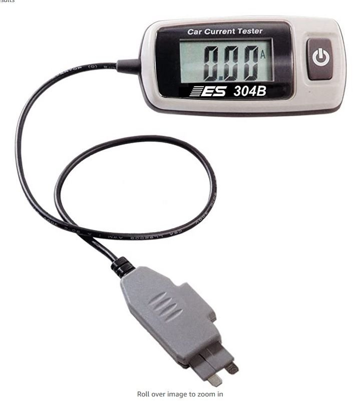

+1 ^^^ measure amps, not volts.
I use a 'fuse buddy' for draw testing. It's handy to leave it hooked up while I use my multimeter for other things.
If you get one, make sure it's not the 'heavy duty' version. You need the 2 decimal places for testing draw. It's not as accurate as your multimeter, but it does OK enough.

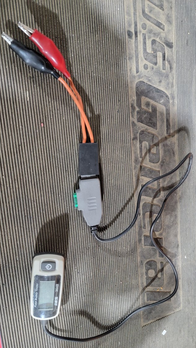

I very rarely actually use it in place of a fuse.
I made an attachment with alligator clips with a fuse holder and install it inline as you describe.
I'm usually working on something with a single battery, so I cant fool them by keeping one in parallel. Most vehicles go to 'sleep' within 15-30 minutes, so I disable any door open switches (usually in the latch nowdays) and/or courtesy lights, disconnect battery, attach fuse buddy, then go have a sandwich. When I get done it's usually ready to mess with.
