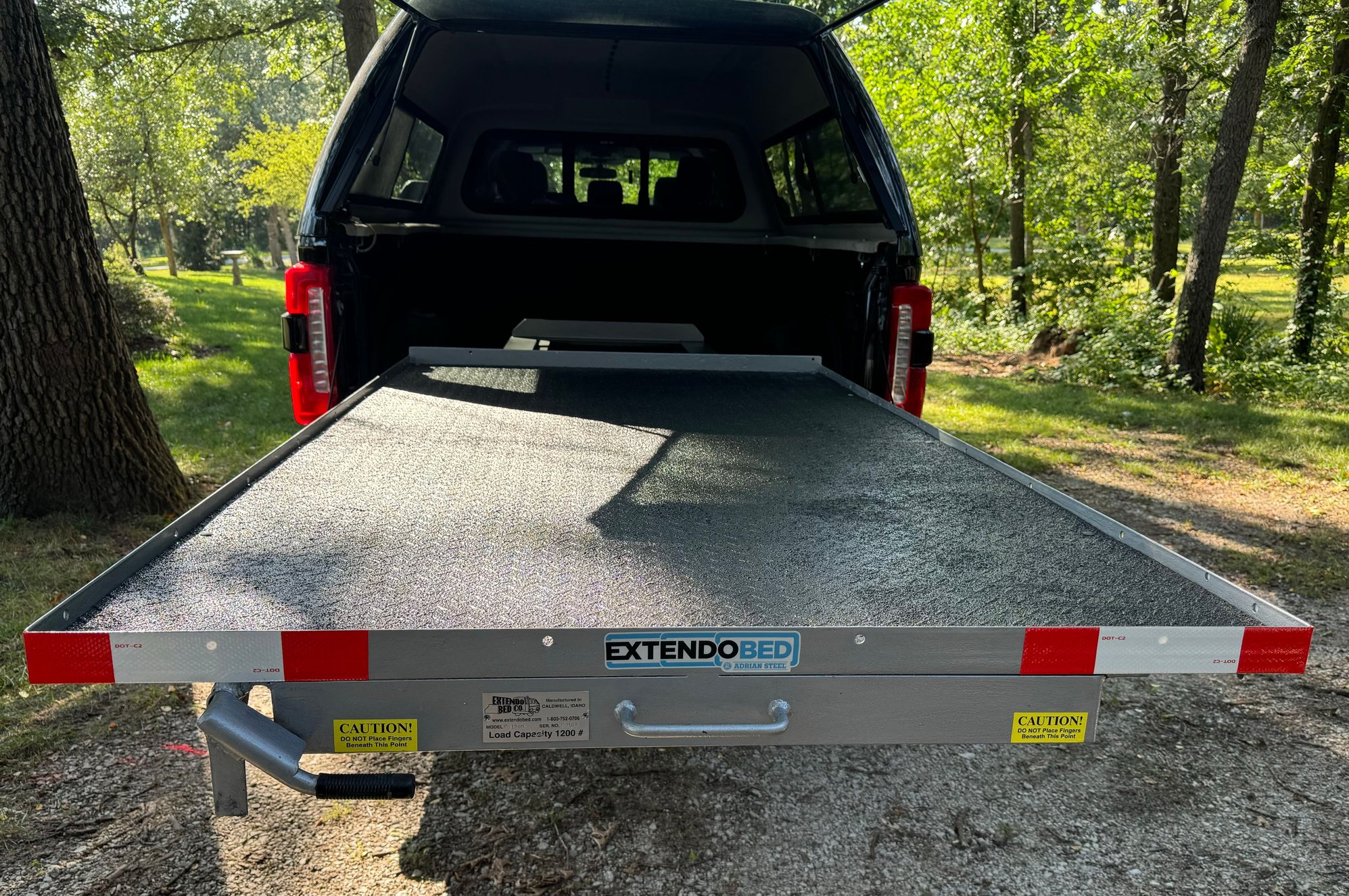

I put Herculiner on a used bed slide I bought. I wire wheeled it. No issues. Bought a Dewalt 9” angle grinder as my 4” grinder was not adequate for the job. Paid for itself on this project.
