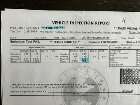

Hey all, I've been struggling to pass emissions these past 2 weeks. I passed the second time last year, I failed the first due to a bad plug wire, I thought I would pass this year but the truck had other plans. I am passing the hydrocarbons well, but I'm failing on the carbon monoxide. From the reading I have done, high CO is just incomplete combustion.
I pulled the plugs and they all looked healthy. I checked the fuel pressure and its 32 at idle and 40 with the FPR unplugged. The engine has a high compression ratio so I run 91 octane in it. I built a custom exhaust and put a high flow cat in it, it passed last year with this exhaust. I replaced the plug wires, cap, rotor, ICM, coil, and PIP recently. The air bypass and air diverter stuff and smog pump were not functional last year when I did the test and passed, so I removed them after the test. I pullled codes but just got 111 for koeo and then 412 for koer. The truck runs good, no major issues.

Post the data sheet.

It seems to be angry about the format let me try another one.

Sorry, the quality is not the best.
