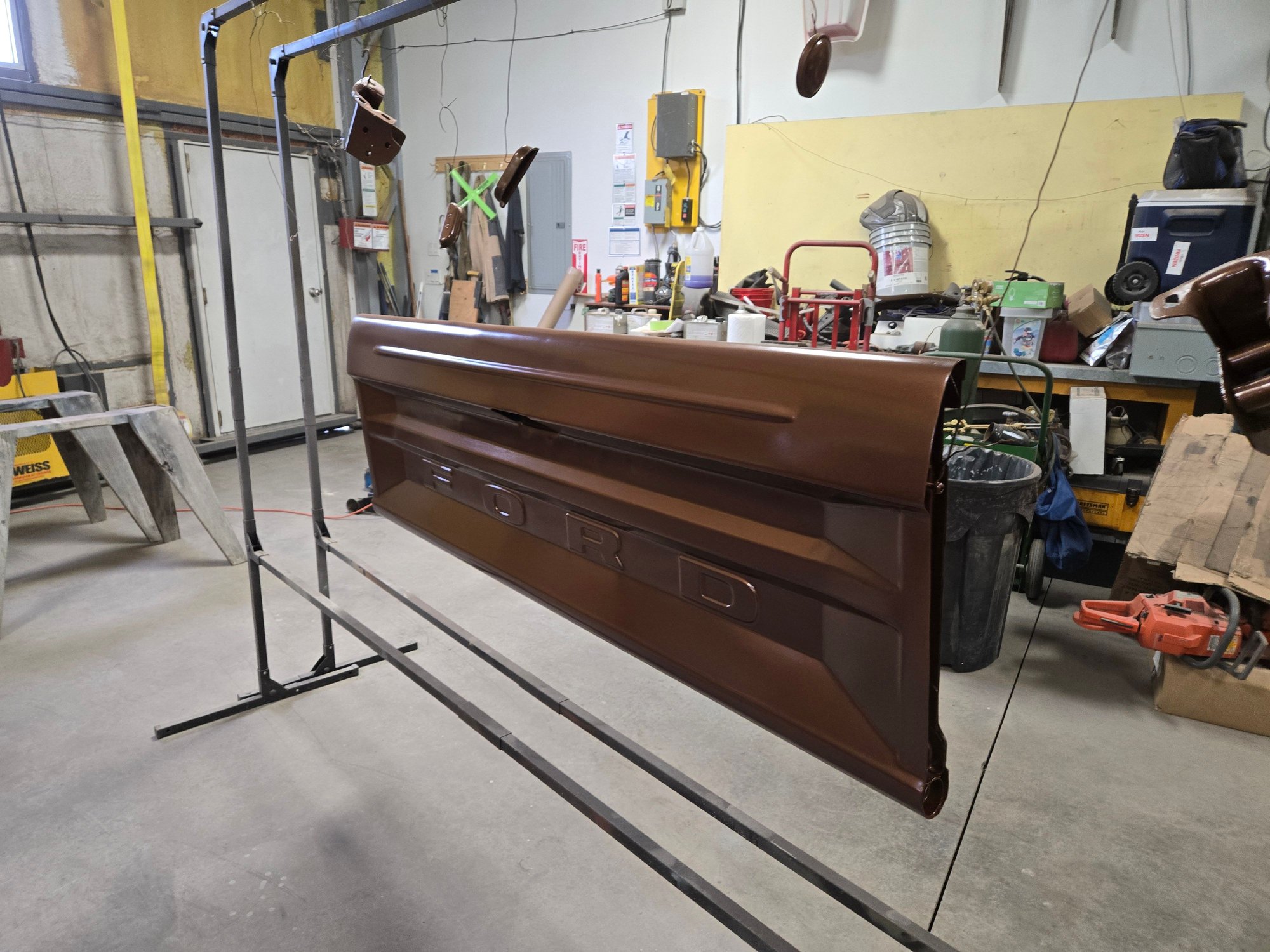

Hey guys I am in process of having my 1973 f100 painted. I bought new original style tailgate from dc. My painter says trying to paint the ford letters white like it came from the factory is almost impossible. Does anyone out there have any ideas and is he right?

Very possible - you just need to have a body shop that's worth a damn and willing to go the extra mile. I have a DC tailgate on mine, and my body shop did this by hand...

Dai just showed how he painted his tailgate letters in the 67-72 forum. He said it took 4 hours just to tape and mask. Post #81
https://www.ford-trucks.com/forums/1...version-6.html
Did ford use vinly stickers, or did they paint the letters? I am close to needing to do my tailgate letters.

1975 tailgate

Just mask them off and paint them, it's only takes low level restoration skills. it will take some time and he doesn't figure you want to pay $80 and hour to do it.

If you don't want stickers long term just use the stickers as the part of the masking to paint the embossed FORD lettering.
A little more precise and less time involved.
