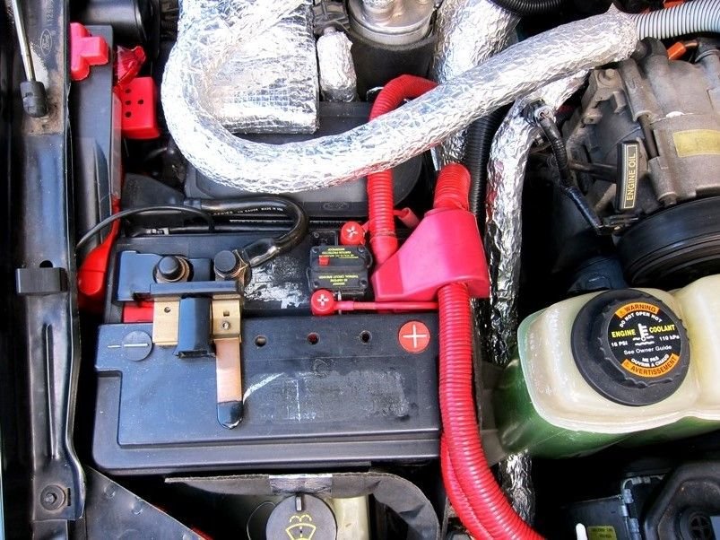

A quick disconnect on the negative battery terminals would save a lot of tightening / loosening / re-tighting cycles on bolt and terminals.
I haven't disconnected the positive terminals to my batteries since I last changed batteries, which was 6 years ago.
But I do disconnect the negative terminals weekly, via quick disconnects on the negative terminals. So that amounts to 100's of disconnect cycles.
My battery terminals are original OEM lead, 24 years old. Cables also original. In the photo below, the original lead negative terminal cannot be seen, as it is repositioned behind the battery, with a jumper to the knife switch disconnect.

If you decide not to go with a quick disconnect of some sort, many have installed connections similar to the ones below with good results.
Old Oct 24, 2024 | 08:34 AM
pvdiag's Avatar
pvdiag
Joined: Apr 2004
Posts: 422
Likes: 72
From: Aroostook County, Maine
Originally Posted by Y2KW57
A quick disconnect on the negative battery terminals would save a lot of tightening / loosening / re-tighting cycles on bolt and terminals.[/img]
x2 on the knife type isolation switch. This is a far better solution to disconnecting your batts as anything if this is what is driving your quest for better terminals. I have used mine so much that I need to replace them (10 years, super cold region, parking truck at airport for days/weeks at a time).
Also, I note @Y2KW57 did the same as I did: re-assemble the switch so it lies flat.
I use the same type of multi-connection terminal as @JohninOkie uses. But it gets tricky with the knife switch on negative. I didn't think of doing the jumper thing. Im going to see if I can reconfig doing that so I only have the knife switch to deal with. The batt fill covers on mine make it an awkward fit on the negative side.

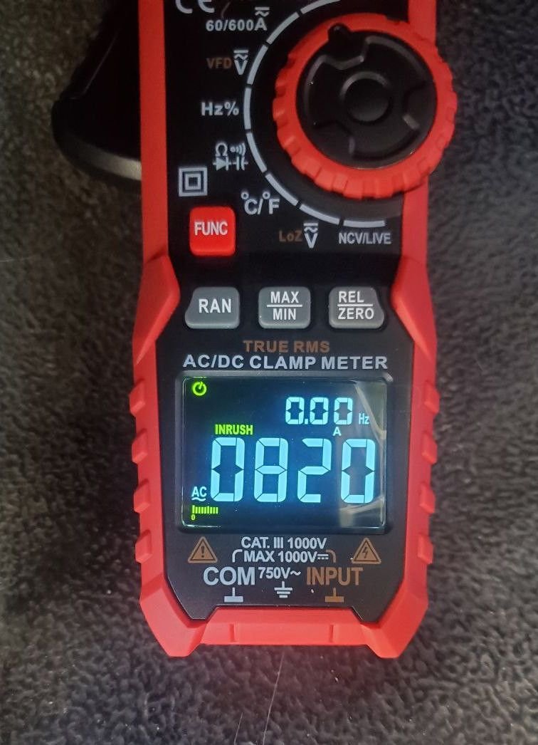

Originally Posted by DaveP.
Your starter does not draw "800 Amps". Not even close.
it does for a few Milli-seconds....
when it is not turning, it is a Dead Short, until the Armature starts spinning fast enough to generate Reverse EMF
I ran several tests on a cold engine, and the results were all over the map, this is one of the best photos that I kept.
this was two years ago, and IIRC, the lowest INRUSH that was recorded, was ~550 Amps on a hot engine, just shut down maybe 5 minutes before the restart.
This is why, it is so Extremely Important, that the cables and connectors be clean and tight, so there is the Least Possible Resistance between the batteries and the Starter Terminal.
I have not recorded the INRUSH Voltage Drop between the Relay and the Starter, I felt that was more or less irrelevant when I saw it was capable of carrying 820 Amps when the Relay first closed.
