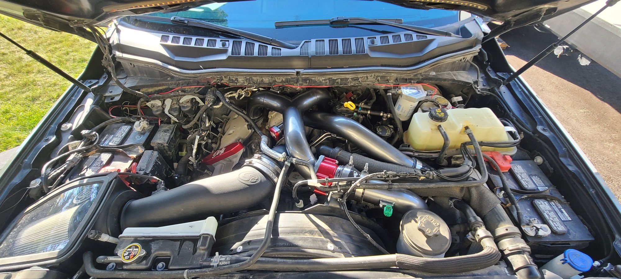

When I first read this I thought well, that would be the obvious solution, but if I hang that big hunk back in there, it will look like crap and will just be in the way.
So I removed the black plastic part where the connector attaches and it contains the circuit board and wires, sealed the now open side so now I have a much smaller part that I can zip tie to the underside of the cold air charge pipe. Plug in the connector again and all works as intended! Thanks!
Also, some before and after weight loss pics because everyone likes pics!
Before.
After!
