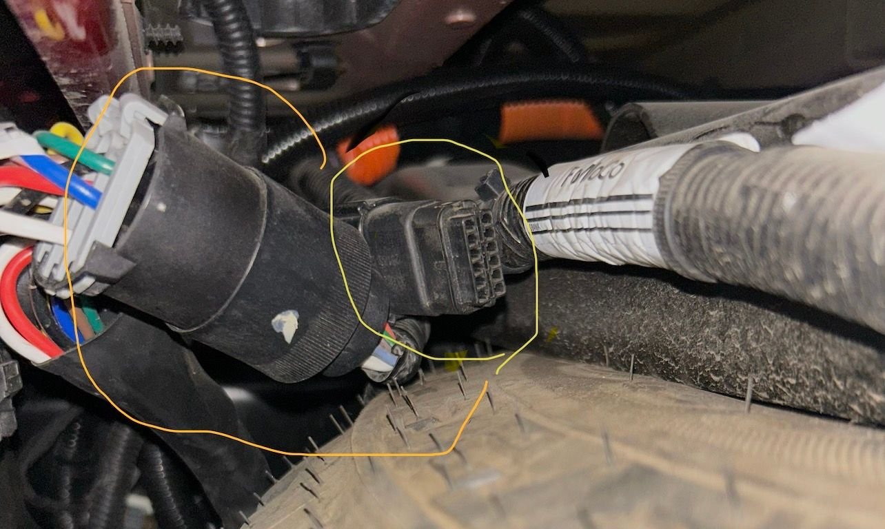

i don’t have the ultimate tow package (874), but i do have the 360 degree view and want to add the ford backup camera and eventually bliss. 2026 lariat 6.7 HO.
Has anyone done this before?
I found the 12 pin above the tire center circled in red next to where the trailer 5 pin enters the wiring harness.
The trailer 7 pin is on the left in orange.
I plan on wiring it where the 7 pin was installed. I may need to take this out and put Ford’s connector in.
if this is not possible I’d like to know before I purchase and install the hardware. There may even be programming that needs to get done to activate features.

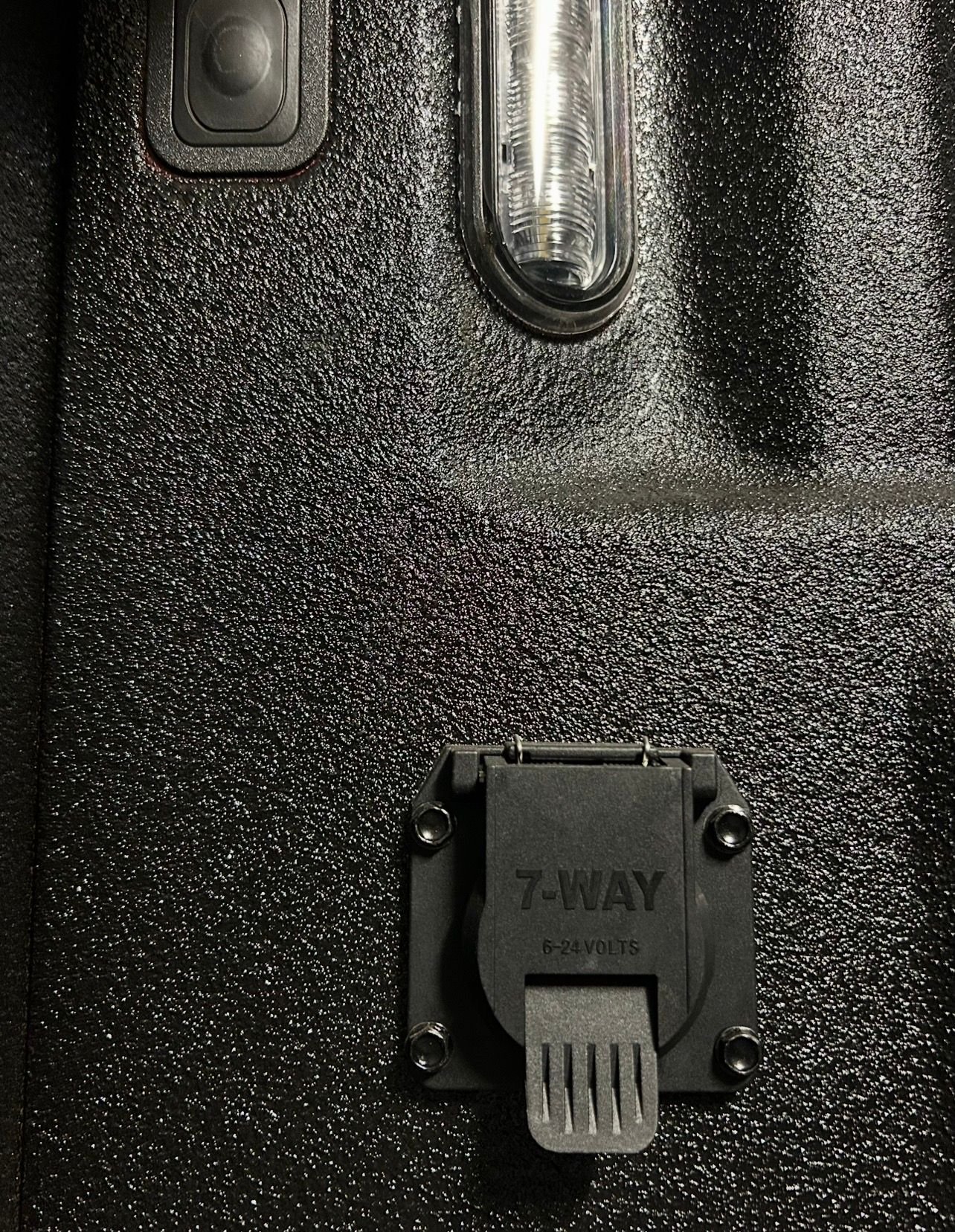

I don’t know if it’s possible to integrate the Ford camera/TPMS/ Yaw sensor into your system if it is not pre installed on your truck. On my 2024 King Ranch I have both the 7-way trailer connector and the camera connector mounted in the truck bed. There was also the camera connector plug behind the spare to install the double connector by the rear bumper. If you have all of the plugs on your truck maybe it can be programmed into the system. One thing to look at is in your camera view is there an icon for the rear camera. If not you this system is probably not installed.
