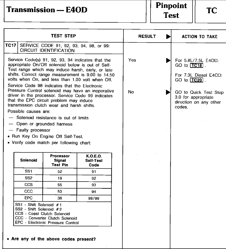

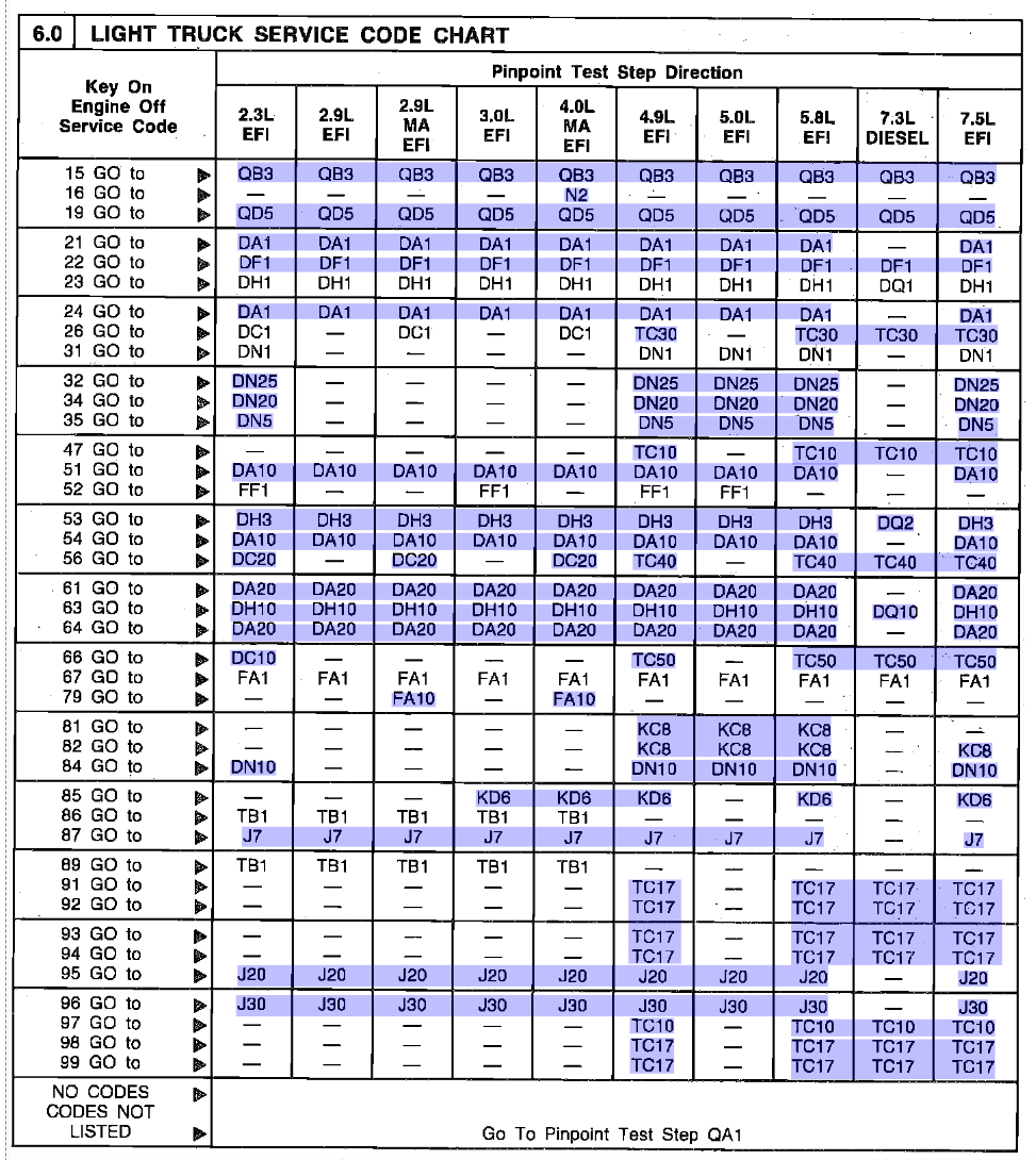

The EPC fault sounds like why, the transmission cant confidently control line pressure.
Can you recap how you are getting code 99?
According to this you shouldnt have a code 99

it seems the only reason you shouldnt have 99 is because 1990 5.0 shouldnt have a e4od. Confirm you have a "E" on your trans sticker on the door?
otherwsie, just using the 5.8l diag should work if you are truly getting a 99

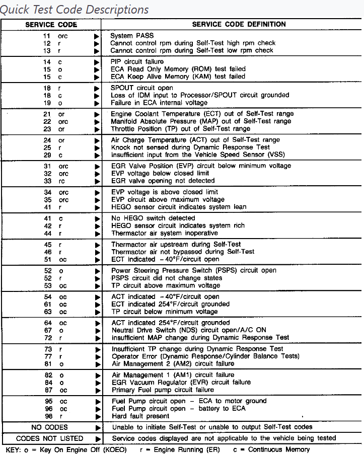

I double checked the door sticker this morning. Trans code is “E”. I’m going to use the ingot Auroragirl posted and see what I can find out.

the source I used for charts seemed to not “include” it but like I said it’s probably just something you follow the 5.8 “diagnostic path” since it’s similar enough for this purpose

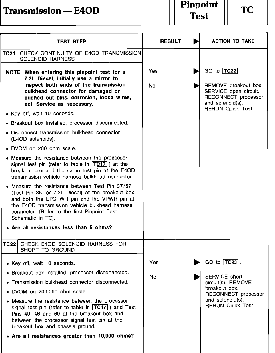

The breakout box is for making testing easier, you can test the cavities of the connector the same way just with more elbow grease. Do you have backprobing kit or experience doing that to a large connector, do you know how to find the cavity?
