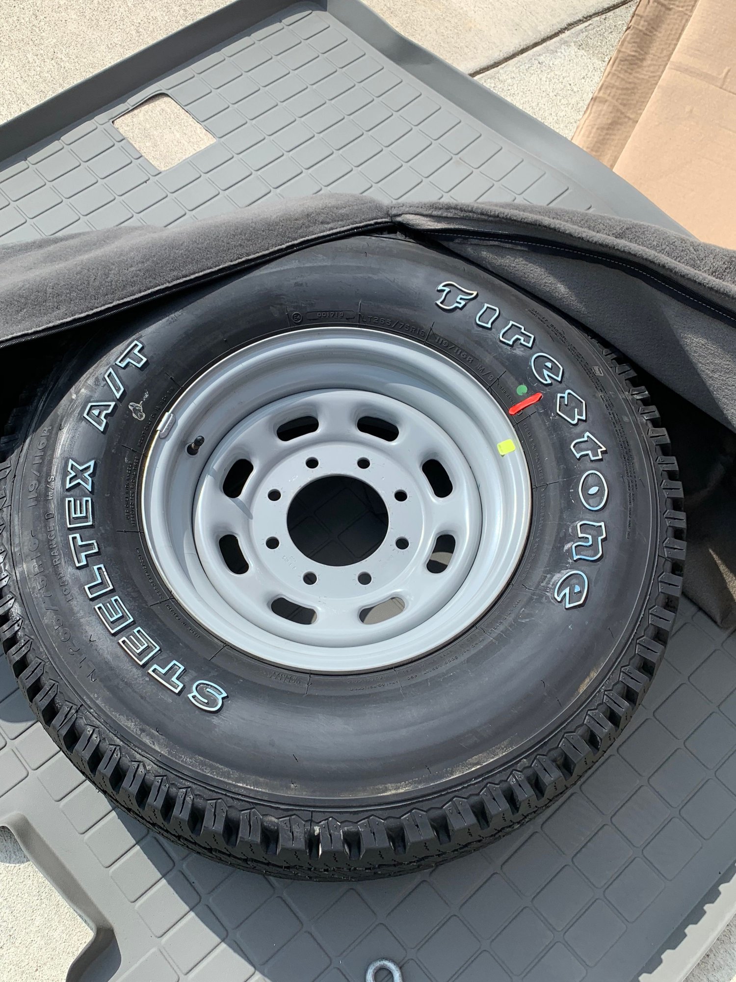

I finally purchased my first EX yesterday. '03 Limited 4wd V10 with 168k
Started with a much needed oil change this am & swapping out rear turn signal bulbs. Drivers was blown, they come in a 2 pack so did both.

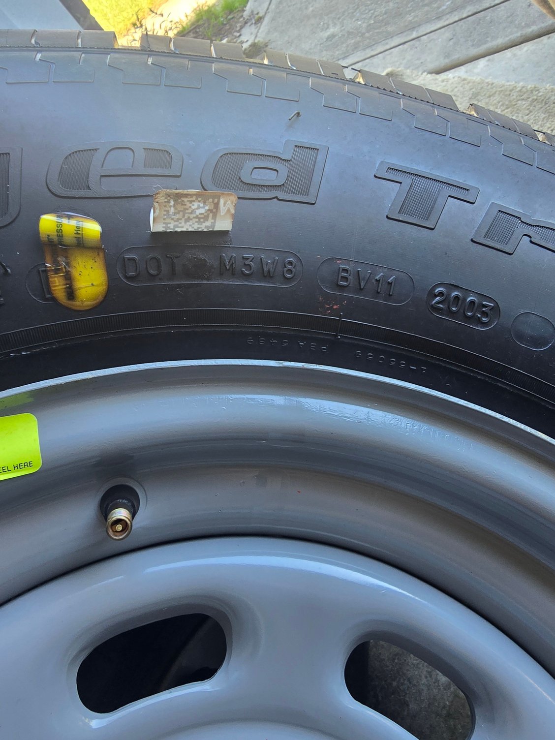

Anyway. To the point. Checked the spare pretty soon after arrival home. Tire is brand new, never touched the road. If I'm reading that correct, the date code is 20th week of '03? I let out some air & removed it from the rig. (Read all thise horror stories of it blowing up & breaking windows)
So am I reading that code correct?

That is correct

As stated above you are absolutely correct, I have an 03 limited V10 4x4 which I purchased new and that is your original spare. Those are the OEM tires which came with the vehicle. I never used mine either but changed it out 3 years ago because I was not going to use a 18 year old tire if I got a flat. I use Bridgestone Dueler Revo III which I have never had a problem with, good wet and snow traction and a smooth ride. It all comes down to how you plan to use your Ex, your budget and of course your Preference. I recently upgraded to 18” HD rims and just bought the same tires again including the spare. .

What kills rubber is UV exposure. Assuming that spare tire has been in the back of the Excursion, covered up with the carpet looking spare tire cover thing its whole life, it "might" not be as bad as you think. I certainly wouldn't run it as a permanent tire, but for a spare,,,, I'd trust it more than the donut spare that's in my wifes brand new full size SUV.

It looks to have been under the carpet since '03. The carpet really needs washing. I'll get the tire removed & replaced with a new tire. Just a shame to waste a basically new tire. I'll look it over a little closer tomorrow for any cracks but initially I didn't see any.

Not only ultraviolet exposure, but Ozone will degrade tire rubber too. Don't even think twice about the tire, it was basically a china bomb since it was made. I recently got rid of my original unused spare too.
