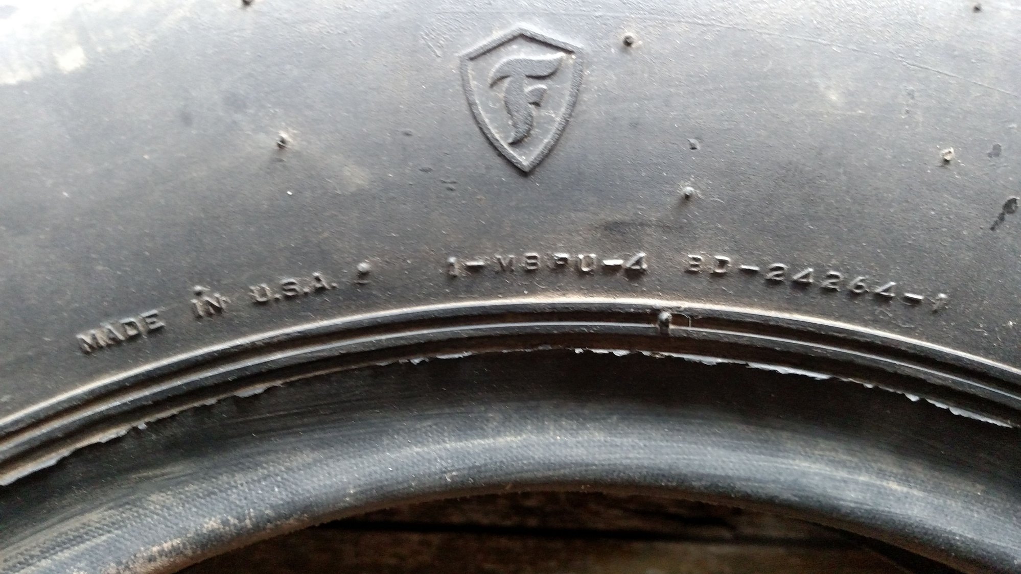

Need some help with deciphering number/date codes on a couple of vintage Firestone tires that I picked up this week. Wondered when these might have been manufactured? Both have never been mounted and were stored inside since they were purchased new. They are in excellent shape considering their age. One is a 7.50-17 and the other is a 7.00-17. Here are pics of them:

I've sought out and bought a lot of old bias ply traction 7.50-17" and 8-19.5" tire sets. Iirc nothing before the year 2000 will have date codes. But I've not tried to look your codes up. There are lots of web sites that can walk you through it, but it's probably a waste of time given their age. If it was me I'd mount them up and use them, keeping them out of the sun. Stu

Thanks, Stu! I am going to use the 7.50-17 on a spare rim as I don't have a match for it. I looked up the 'Gum Dipped' logo on the tire and it appears to indicate that it was a top of the line tire at the time it was manufactured. I am going to sell the 7.00-17 as it doesn't match anything else I have.

I'll guess that the 7.00" is a Firestone Transport 110. That was a pretty common tire back in the day. Sell it if you can, but road tread tires in that size are sold new. I went after the old traction treads because only the Tornel is available today. Stu

Stu, the 7.00-17 has Transport 100 on the sidewall so is in line with your knowledge of them. Looked at the new versions offered on the internet and appears price is somewhere around $225 each. I wouldn't want anywhere near that amount if there is anyone that can use it. Be a nice vintage tire for any purists out there. I will put it on the Buy, Sell, Swap thread. I also have been watching for older Courser or other older brand 7.50-17 traction tread tires. Got 2 nice Courser tractions, never mounted, out of Pella, Iowa a couple of months ago. They are a little taller than the Tornels and look better on the '46 tonner.

Sometimes getting a little off topic makes for interesting discussion. As old as the tires I pictured above are, not sure the numbers on them can be attributed to a certain year, just hoping maybe a time period. The person I bought them from had a brother that purchased spare tires for all the equipment and old vehicles that were used on their place in Wisconsin. They had a few old trucks including a '52 Ford and a '48 International. Also several old implements that used the 7.00 & 7.50 X 17 inch tires. Best info he could share was that he thought these tires were probably purchased in the period from the early 50's to early 60's. They were always stored inside and for some reason never needed. The brother passed away several years ago so no direct info could be obtained. I arrived after sundown on a very dark night with no moon so wasn't able to look around for any rusty treasures that may have been there.

I think you are correct to assume they date to the latter part of the 1950s or early '60s. On your Transport 100 I guessed it, based on its tread pattern, to be a Transport 110. The 110 is likely a later version of the 100. I have a Firestone data book dating the 110 to at least 1965. I also Googled the Transport 100 and found an eBay seller's listing for a Transport 100 ashtray that he dated to 1961. Finally, I have a 1953 (iirc) Firestone data book that does not list that model tire.
