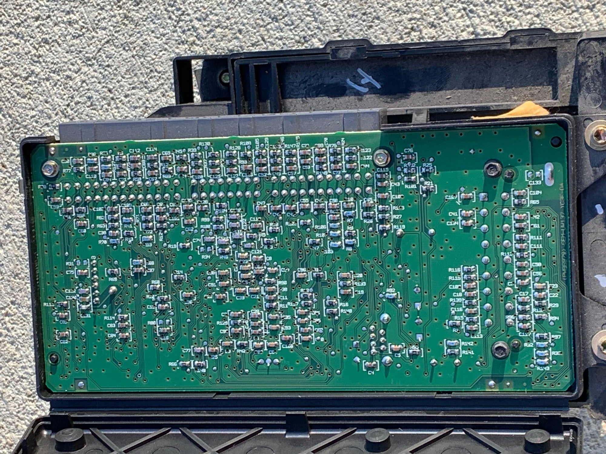

I have already had the instrument cluster repaired, I pulled the GEM and it is bone dry with no signs of corrosion on the connectors/pin/board, and I sprayed all the door latch sensors with electric cleaner. Everything else works fine. I swapped around the relays to no avail.

Old Oct 11, 2024 | 02:06 PM
6_Myles's Avatar
6_Myles
Posts: 331
Pulled the cover off the steering wheel and the wires look good. They all pass the visual and shake test along their length.
Replaced the GEM with a refurbished model and no joy.

Picture of this "GEM" you replaced? Your year is not supposed to have a gem, but a VSM, and the relay thing on the back of the instrument cluster. Last year for GEM was 2001.
Old Oct 11, 2024 | 04:44 PM
6_Myles's Avatar
6_Myles
Posts: 331
aka battery junction box, I believe

Looks correct, the GEM is piggy backed to the interior fuse box when one is present.
GEM on the backside of a V-10 fuse-box for reference....
