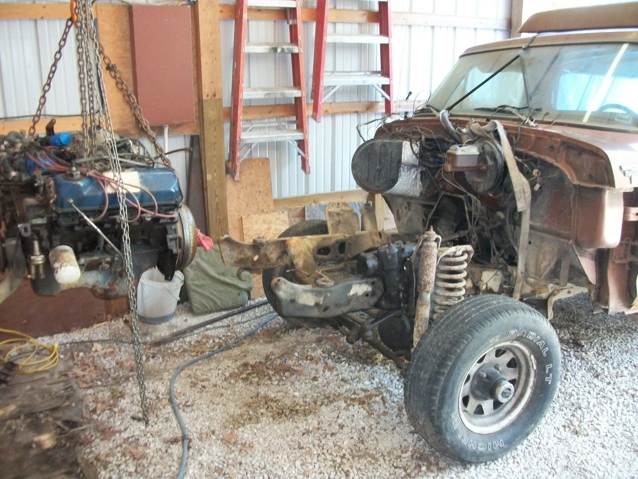

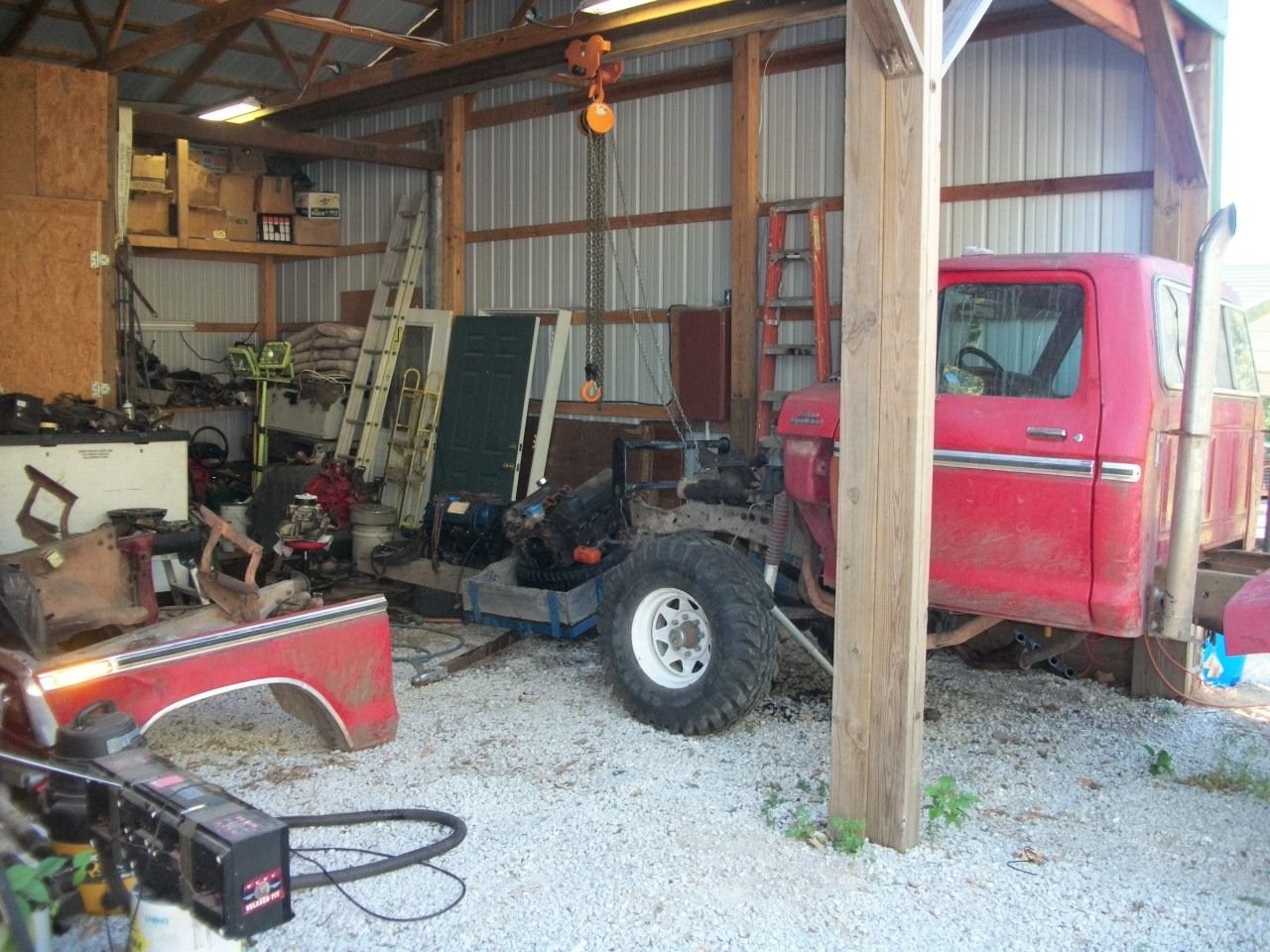

Well you know me for sure...X1000 pull the front clip, just 14 bolts. There are 2 versions below because I kept remembering steps.
https://www.ford-trucks.com/forums/1...l#post14982711
https://www.ford-trucks.com/forums/1...l#post14696880
Of course nice trucks do not get the hood on the roof, but I pulled it by MYSELF and got it flipped up there.

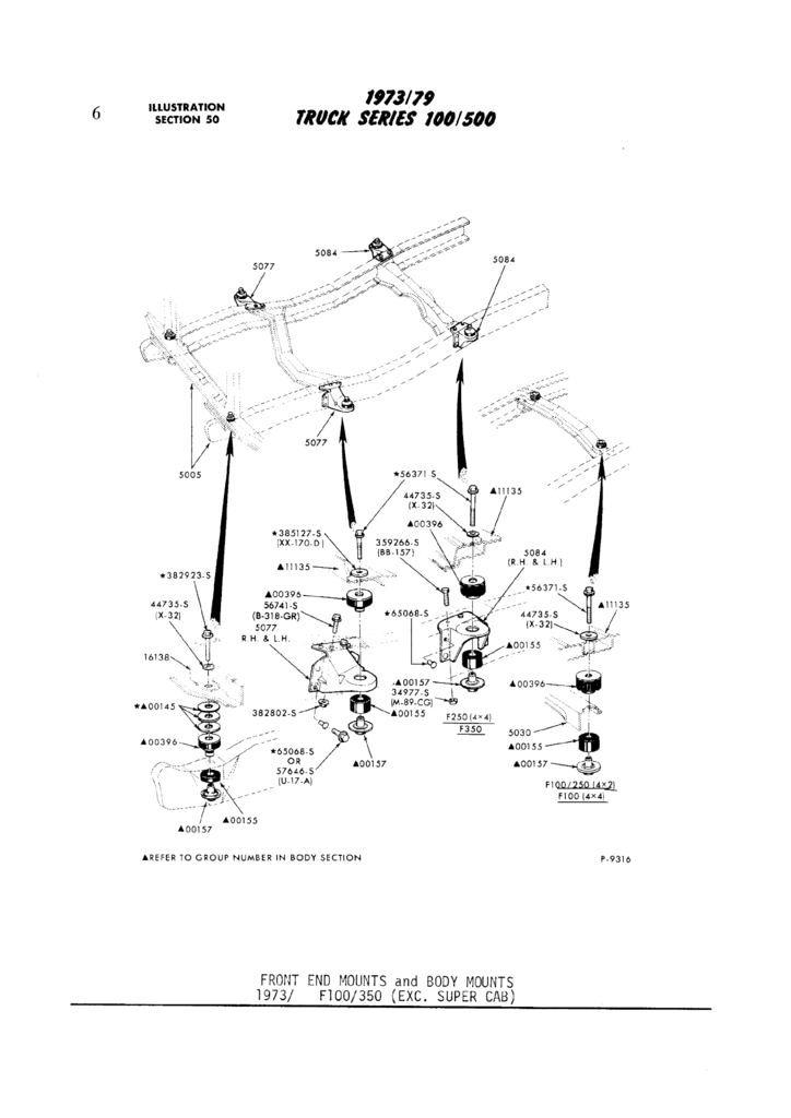

FYI the core support bolts can be a PITA. Be ready to sawzall and replace them and the bushings.
D3TZ-1000155-B.. Absorber (rubber cushion) - Lowerradiator support and lowerfront & rear cab mounts / Obsolete

NO NO NO, but some guys like a challenge.

I was jamming on that boom box on the 5 gal bucket, so you know it was a few years ago. LOL
