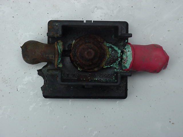

I'm not 100% certain this applies to the diesels because I've only had to diagnose and deal with it on gas engine trucks. But, on top of the left fender liner, inside the engine compartment, toward the firewall there may be a junction and a fusible link that supply +12VDC to the CJB (fuse panel) under the dash.. I've seen one case where the terminals corroded and all power to the truck was lost and one case where the fusible link burned up. If the pictures manage to attach, the terminal is gone, but you can see the mounting holes next to the wire with the big red piece of heat shrink tubing on it.

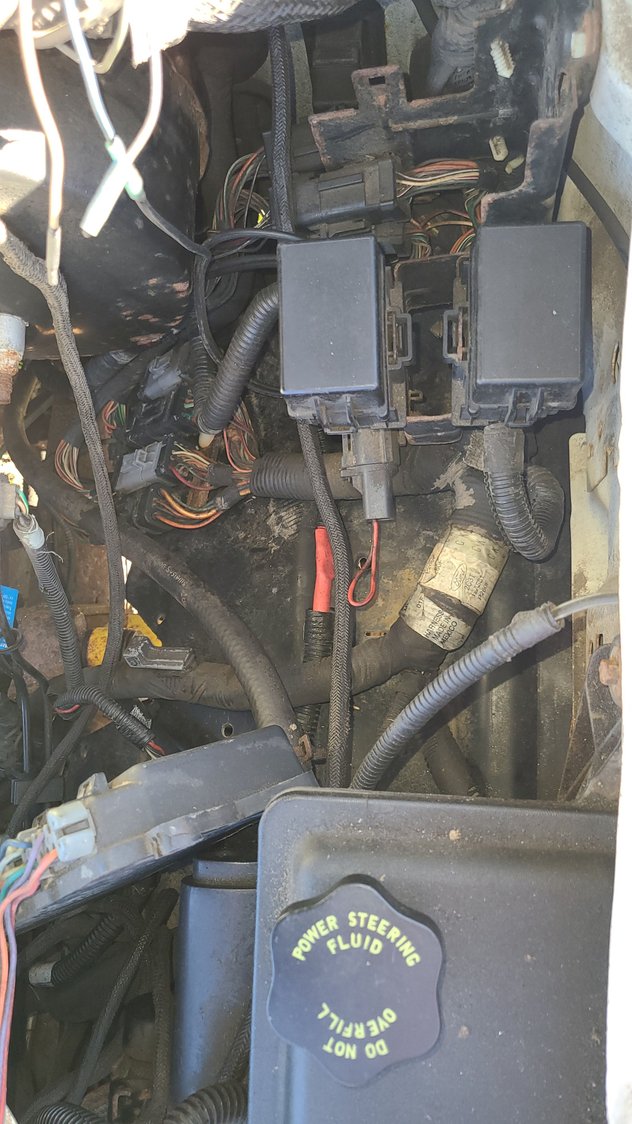

Not sure if this is the same connector Pikachu is referring to, same location on top of left fender. Has a square black plastic cover. They can corrode and break and sounds like that area was recently worked on.

Yep it was the connection on the left fender was corroded beyond belief, thanks guys!
