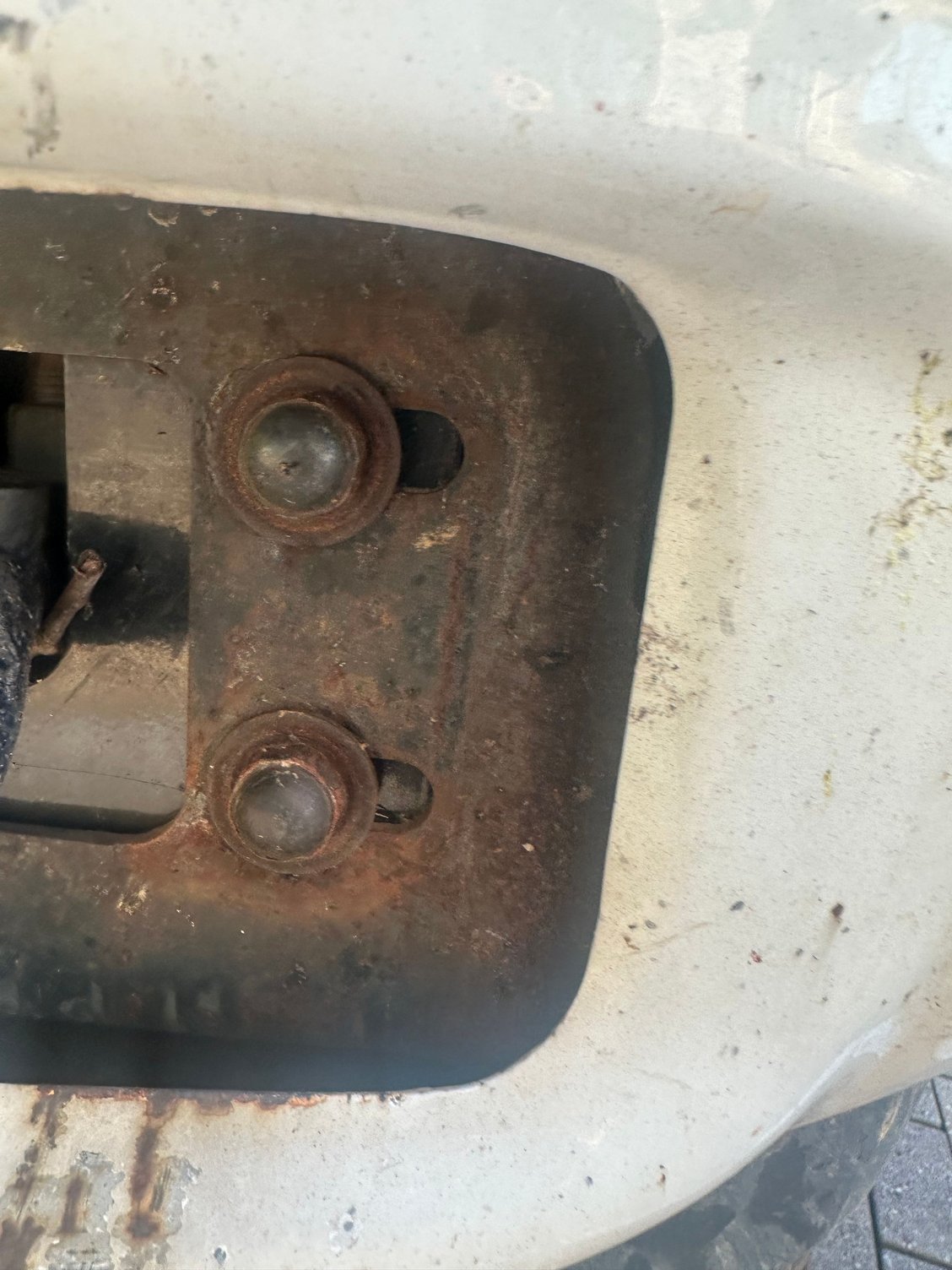

Need help for front bumper bolts
Can someone tell me the diameter of these bolts thank you

I can tell you that the socket is 18mm..
The back has nuts welded to a plate so no back wrench is required.
Had mine out today.

12mmx1.75 about 1 1/2" of thread
