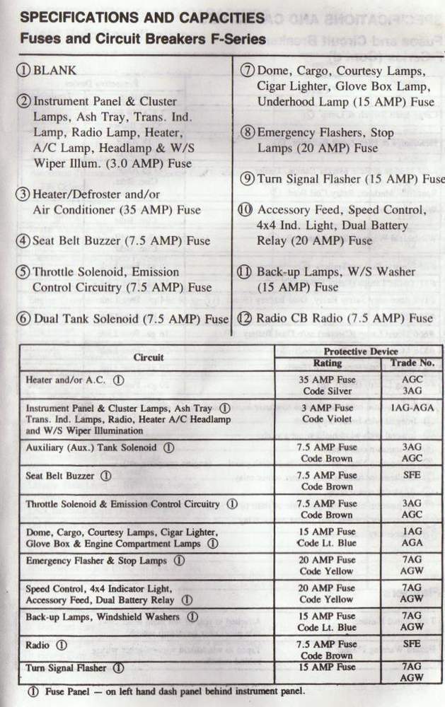

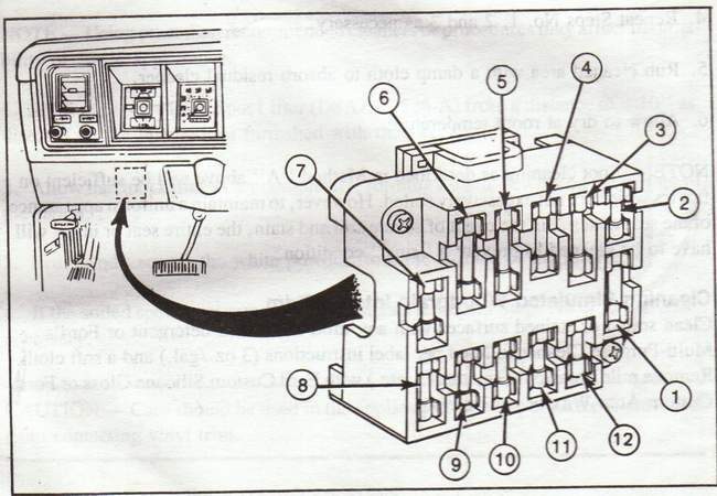

1. Ck fuses. Keep in mind the fuse box is actually rotated counterclockwise, with #1&2 at the top and #7 is at the bottom.

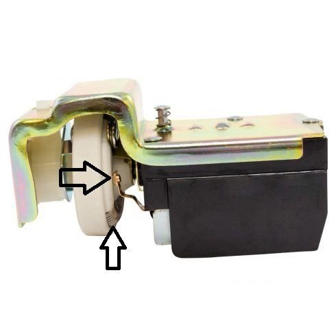

Sounds like your headlight switch might be causing those issues, it is tied in to both.

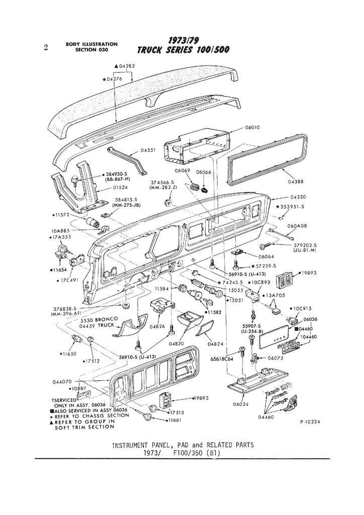

If it is the headlight switch you have to remove the dash bezel to get to the nut (#11650) that holds the switch in the dash.
This is the rheostat you have to clean for the dash light brightness.
The yellow button is the arrow you push down and hold down when pulling on the headlight switch **** to get it AND the shaft to come out, AS ONE PIECE. So you can get the dash bezel off.....to get to the nut holding the headlight switch in the dash.
Dash bezel removal walk thru. https://www.ford-trucks.com/forums/1...l#post14982704
Or https://www.ford-trucks.com/forums/1...l#post14880899

Pull the headlight switch...clean/adjust the winding/wiper on the switch, and it bet your dash lights will work correctly.
