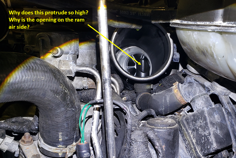

I would like to do this, but I don't want to vent to atmosphere or dump oil anywhere it doesn't belong. Therefore, I'm open to going the more expensive route with a catch-can and re-route to the turbo inlet. However, what is the purpose of the CCV tube protruding almost half-way up into the inlet tube? That looks like it would unnecessarily restrict and create turbulent airflow. Furthermore, the opening is on the ram air side, which wouldn't help as much with the vacuum action to suck fumes out of the crank case. Has anybody ever just chopped that bugger off flush?

It creates a Venturi effect that help pull the exhaust gases into the intake from the crank case. It’s a bit of a push/ pull system. I did a pretty cheap CCV reroute with a catch can. I was mainly concerned with oil in the intercooler and sludge built up in the intake.

'Cause maybe with the constant high draw of the turbo, they didn't want to create an excessive amount of suction out of the crankcase and overwhelm the intake with oil. Just a thought.

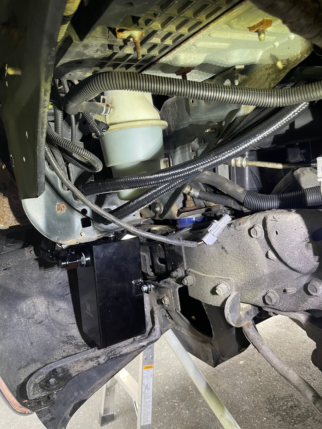

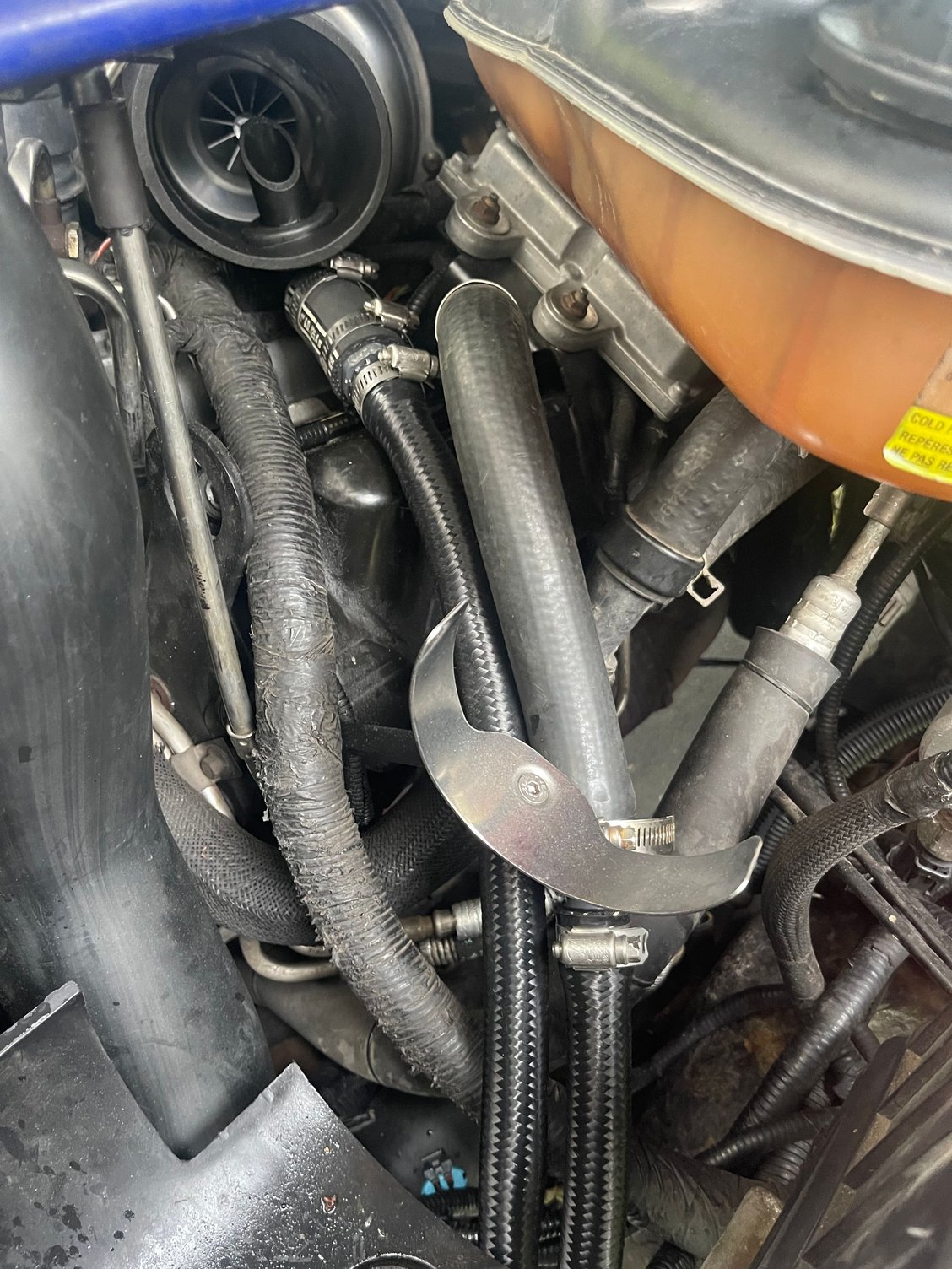

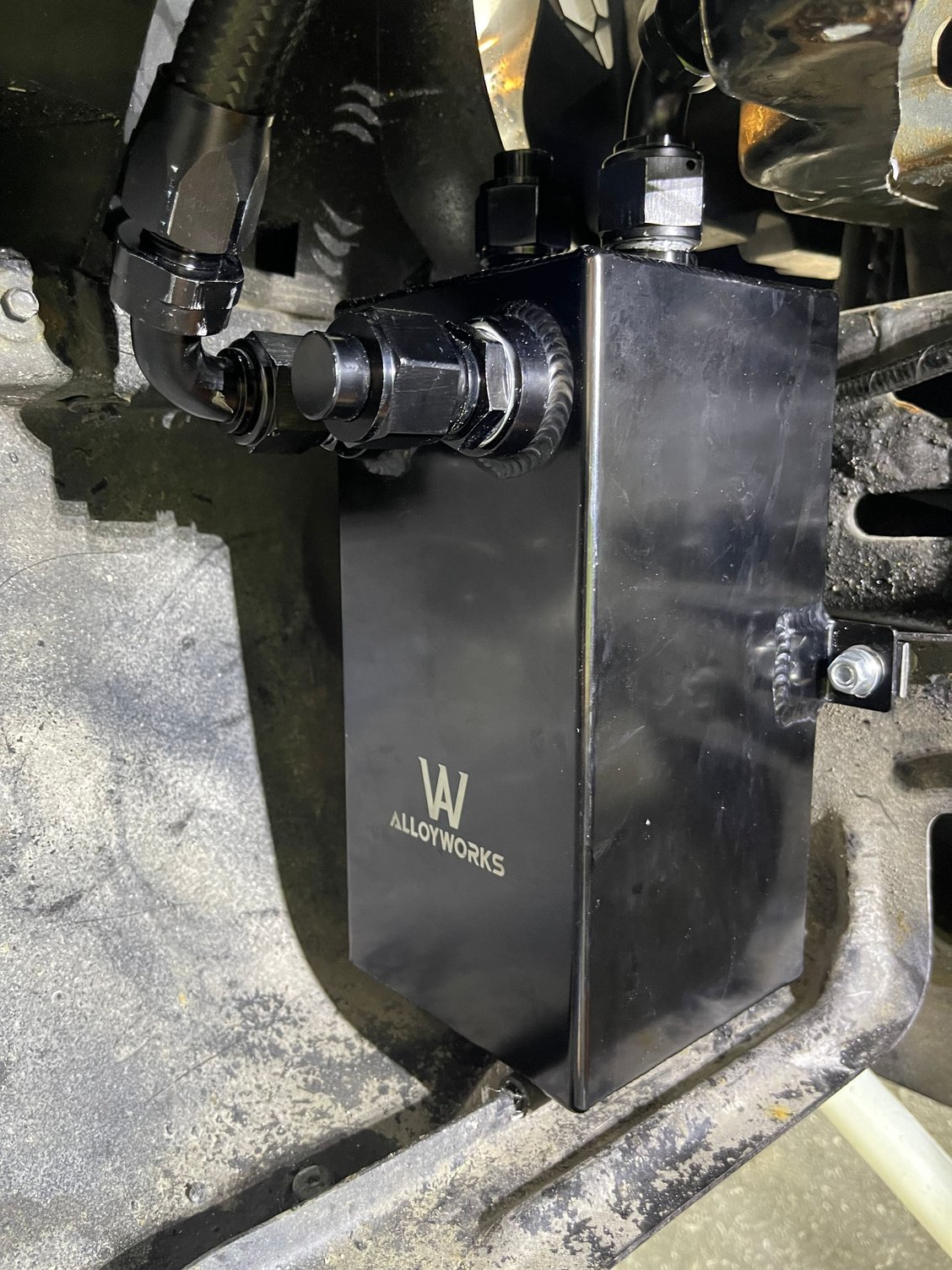

I had it rerouted through the racor 6000 and back in to the intake for many years. Within the last two years I went from the Racor to the atmosphere just behind the ADII mounted 5' from the OEM pump that remains in the frame. I plugged the intake boot with a dependable plug.
I had an issue with one of the hoses at the engine, had none in stock and "temporarily" rerouted and plugged the boot.
Been that way since with zero issues, zero oil drip and zero smell.

IIRC Smackdaddy installed an oil separator after his engine rebuild because he had oil leaking through the brand new main seals, and apparently the leaks stopped after installing it.
Didn't work for me LOL. Not with the Racor 4500 and most likely original seals.
My truck must not have much blow by, because there hasn't been much oil in the separator anytime I have checked it.
