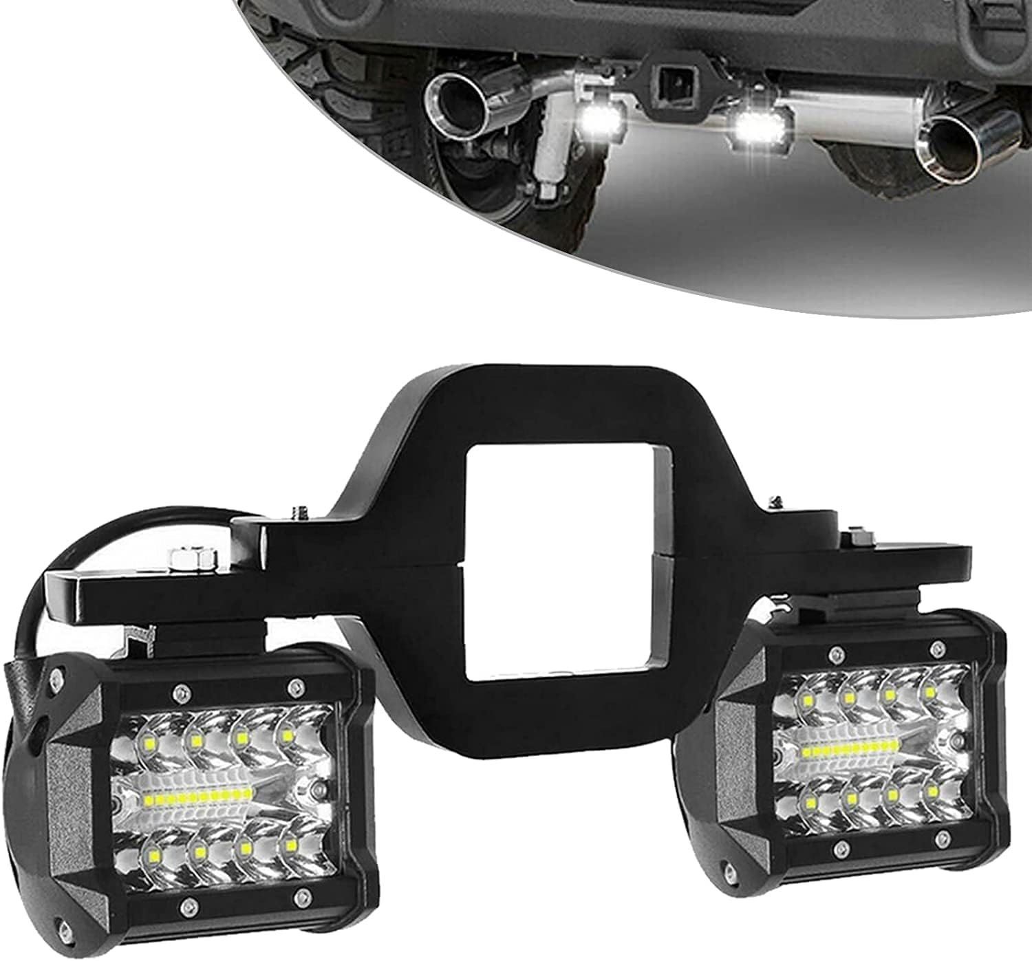

If you have a rear receiver style hitch:
Amazon Amazon
And not so cheap, I have seen these and they are bright, but dang $$$. https://realtruck.com/p/race-sport-h...QaAmG8EALw_wcB
And again if you have a receiver hitch, here is one that goes in the hitch. But not as good an idea if you have a hitch in and need the reverse lights. https://www.bajadesigns.com/products...EaAqTbEALw_wcB
Putting them on the side of the receiver hitch and giving them a separate power source (truck not running), then you can use them when ever, like if you have a trailer/car hauler and need to secure stuff in the dark.

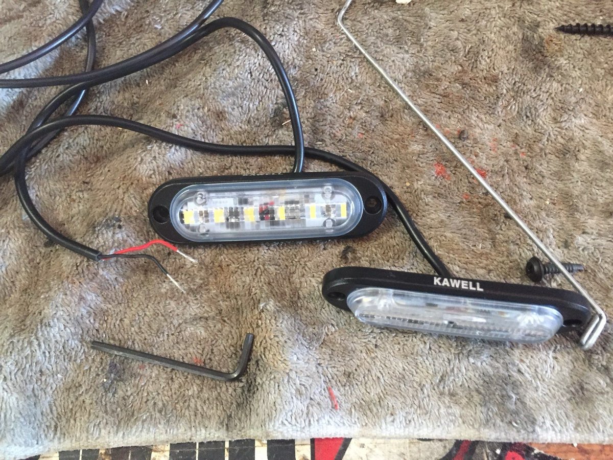

I purchased these from Amazon about a year ago. Two for about $20.00. I put these on a separate switch for when I'm hitching a trailer in the dark. Also handy for when I need to "remind" someone behind me where their dimmer switch is located. They are LED and probably don't pull much power. You could more than likely wire them into the factory reverse light wire. I also put one in the middle of the front bed wall just below the slider and another under the hood that is switched to the hot wire for the factory hood light.
