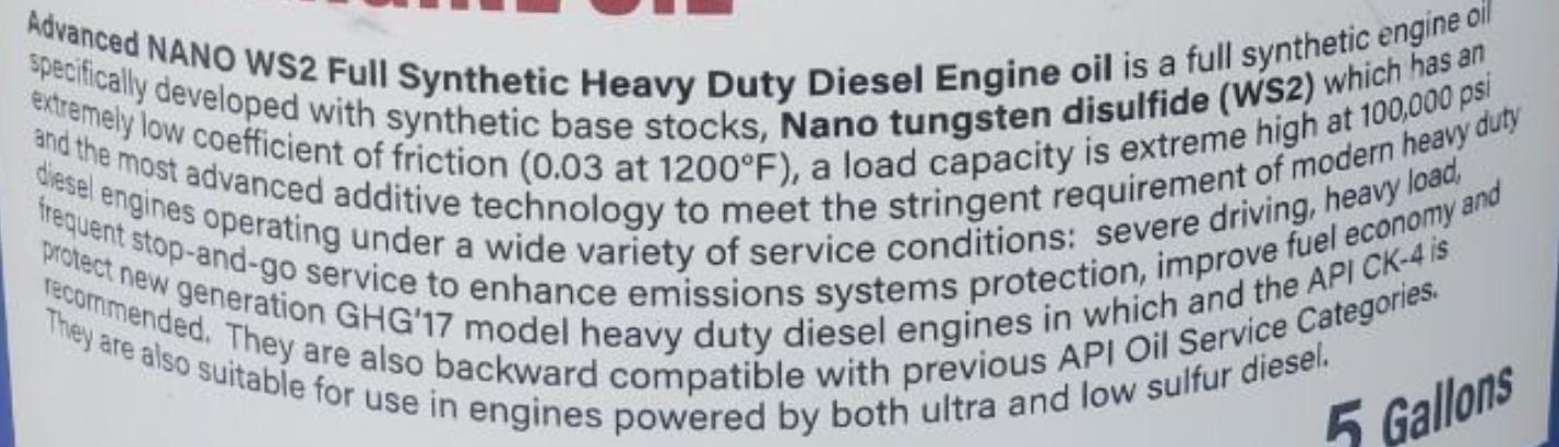

I have full experience with that.
with T4 15w40, startups were rough and it took 15 minutes for the engine to run really good.
I changed to Lorenzo 5w40 pure synthetic and after a 1,000 miles it was able to start in 20*F Wx w/o the Block Heater plugged in.
Now, with 2500 miles on the oil, it starts within a few seconds and settles into a smooth idle immediately....
for me, that is much nicer than buying new Injectors.
Odometer is 182,000 right now.
makes me almost want to buy more Lorenzo oil, but but but, it is terribly expensive...
this stuff does what they claim...
click on that pix, and blow the label up 10X, and read it...
incredible oil.
here is some help.
