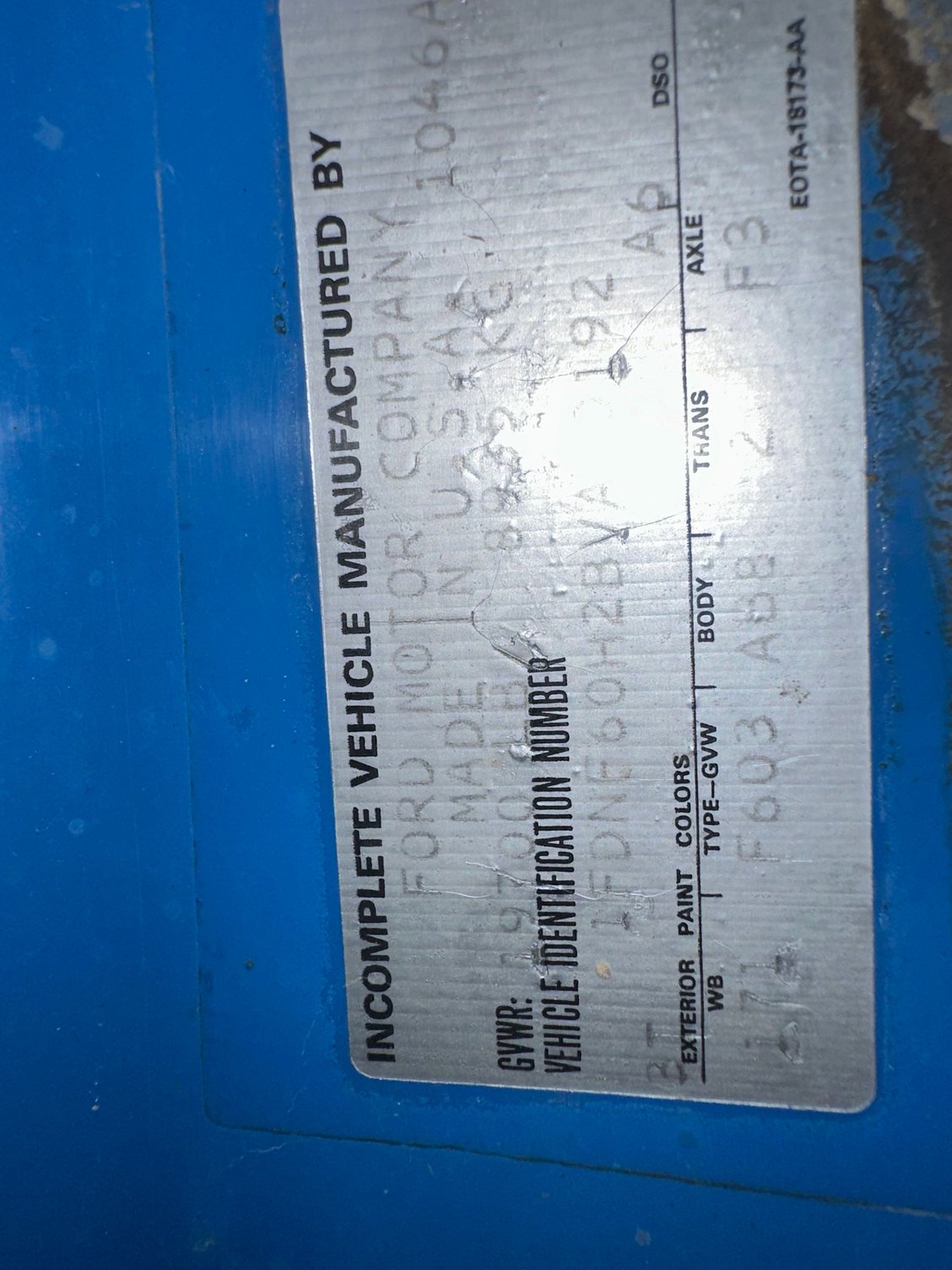

Hello I have a 1981 ford f600 and I am having a heck of time decoding the vin on it trying to figure out what axles it has trans ect I’m pretty sure it’s a Clark trans but I could be wrong if anyone can help me out that would be great here is the vin 1FDNF60H2BVA00192

post a pic ,or list all the other numbers and letters on the certification plate .it can tell you alot about your truck
that’s the best pic I have

Shawn23 ,sorry I am not good at this .1fd is a ford incomplete truck. N is a class 6 truck ,GVW19.5-26000 lbs.F60 series rated for 16.500 lbs.H is Kentucky plant.post a pic or list all the info on the certification plate for all the other info you want

Sorry ya I know it’s a crappy pic that’s the only sticker on the truck and it’s getting worn out mainly interested in the trans it has and front and rear axle I posted the full vin but that’s all I have for the warentee sticker unless there’s another hidden some wear else
trans code is a 2 and axle code is f3 trying to figure out what rear axle and steer axle I have for weight rating and what trans I have just for future reference thanks

found some info from your cert plate .GVW #19,700. 171 " wheel base .f603 is a 19,7 truck .body is regular cab .transmission is a clark 282v direct drive .rear axle is a eaton 15201 -2 speed ,6.33- 8.81 gears
