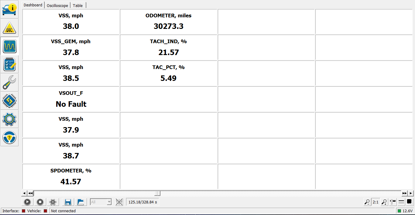

I hooked up Forscan and pulled up all of the Vss modules I could find. Disappointing how little info is available.
I found a DTC. P0297 Vehicle over speed condition.
Dashboard is 4-5 mph slower than speedo.
Did notice a 1.2 mph difference in two of the values. Don't know what that means.
I'm going to look at a different program to see if I can find something else.
